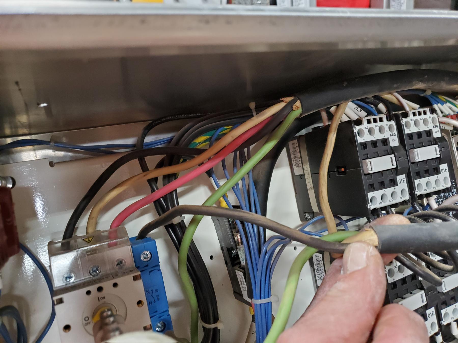

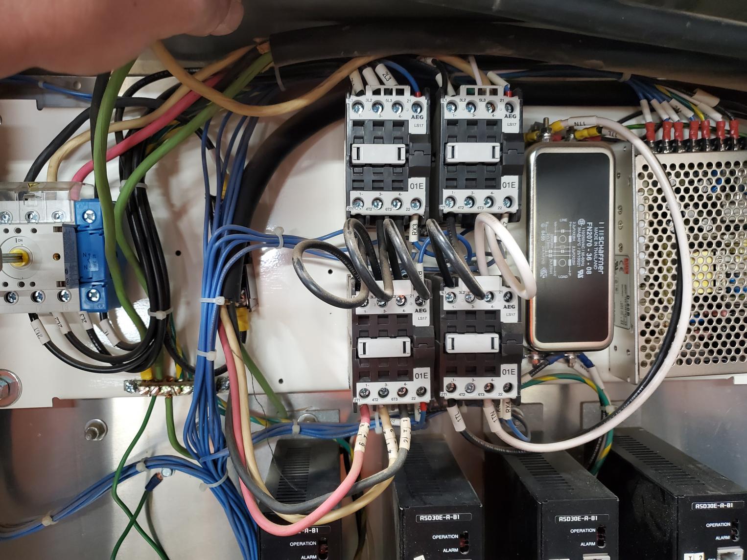

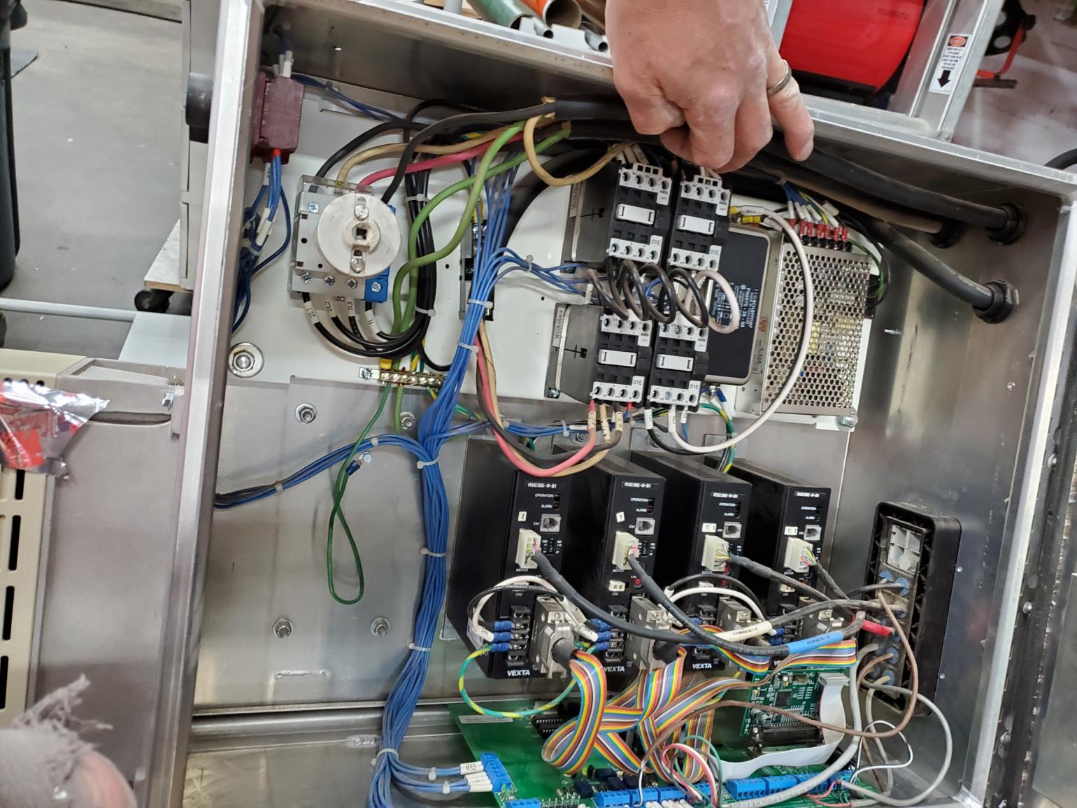

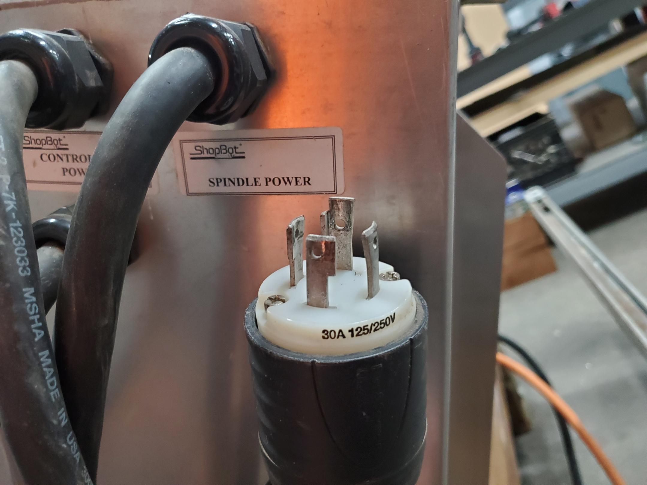

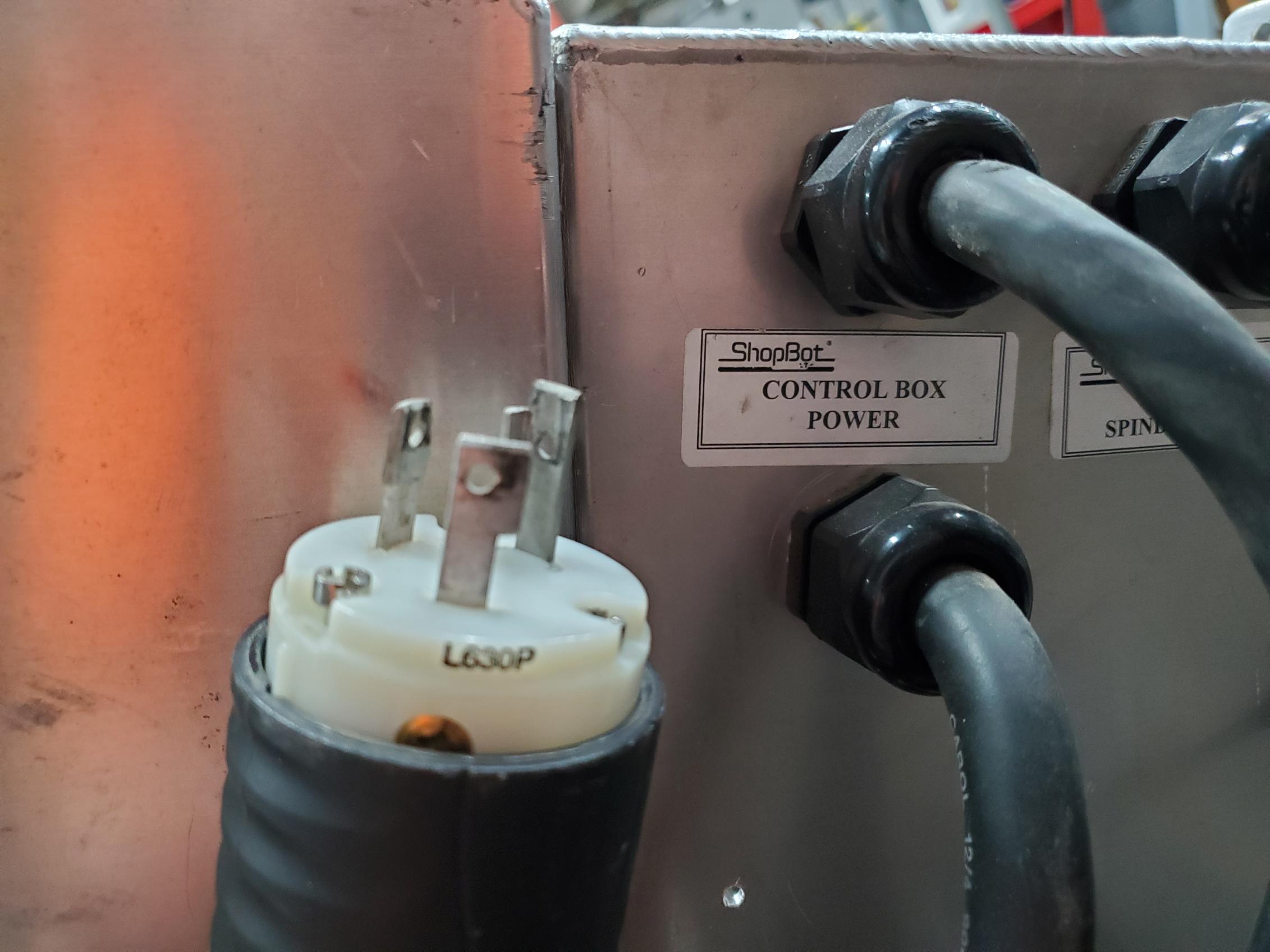

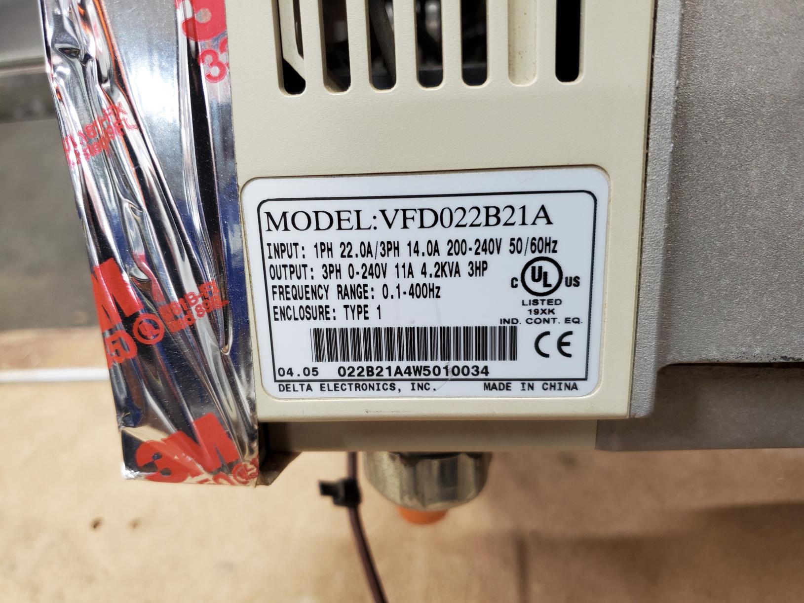

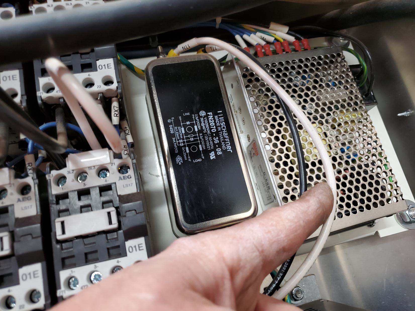

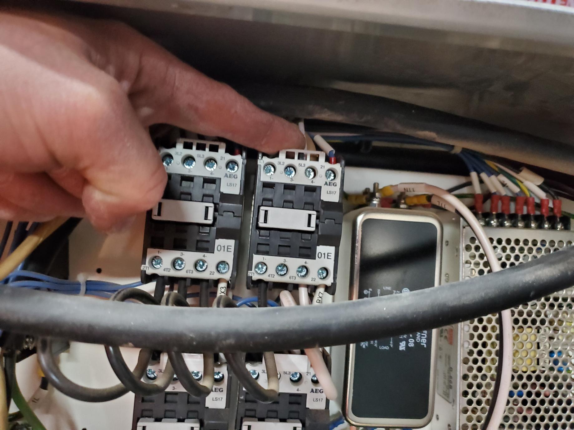

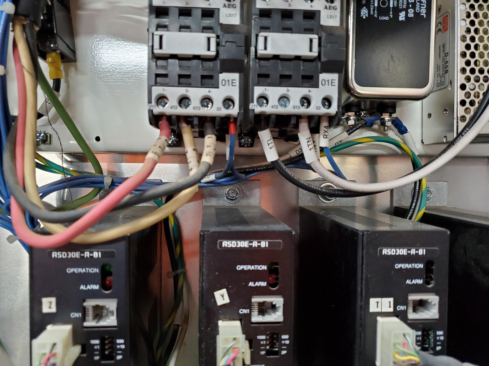

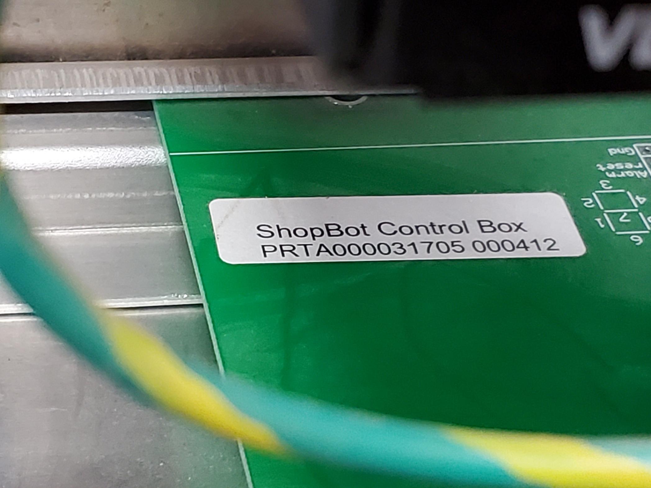

    we're just trying to figure out what we have here----is this control box in need of 240 single phase, or is it wired for 3 phase?
    seller told us single, but looks like it's possibly 3-phase.

    A few more pics

    Call Shopbot. They should be able to quickly answer your question.
    Dec 2008
    Diamond Lake, WA
    1,746
    I think most are setup for 220vac single phase coming in. This is then sent to the spindle power inverter and converted to 3-phase for the spindle.
