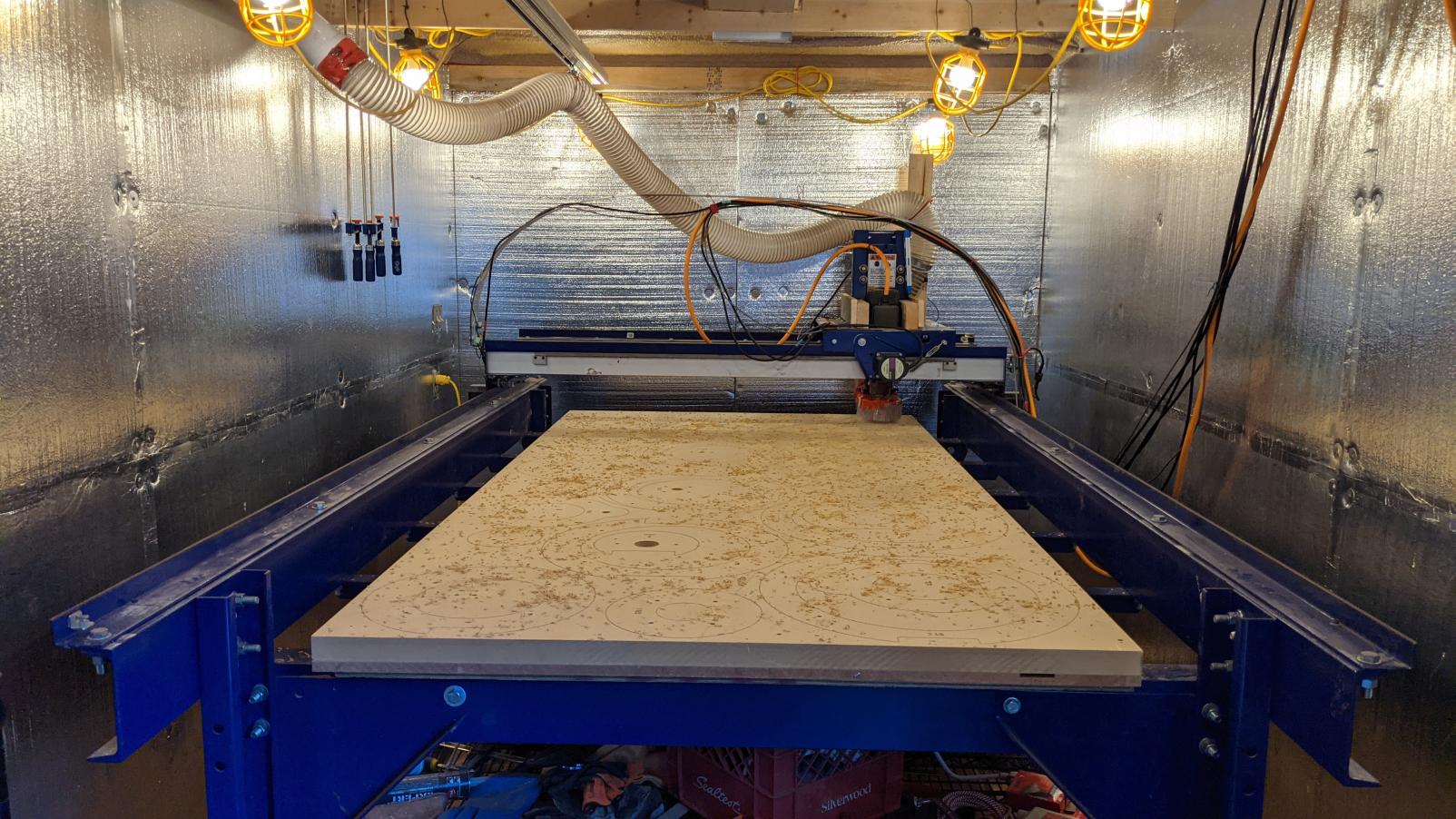

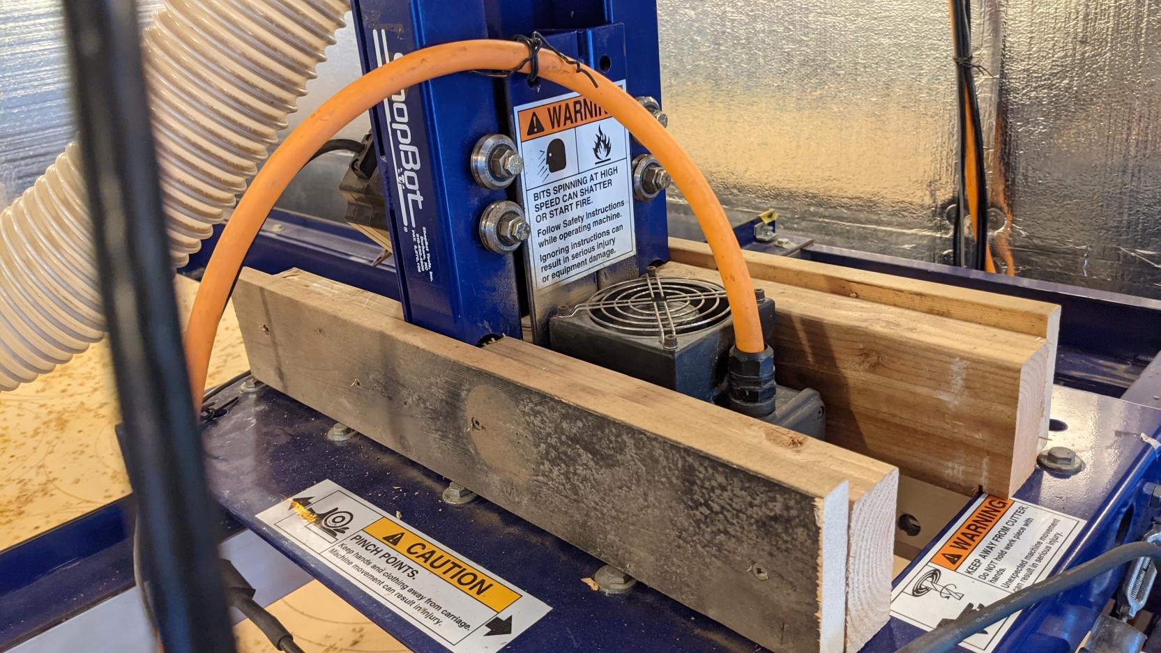

    Been having a time keeping the z truck vertical on the X axis. It always wants to kick for and back.
    When I was doing things that would push it around, I figured it was my fault.
    But now that I'm simply clearing holes with a 0.006" (about 432 ipm with a 4 flute mill) feed with a 0.75" depth of cut in MDF at 18000 RPM and it sends it out of whack by a degree, I'm starting to become frustrated. And I don't want to wiggle the holes bigger and make this a more pronounced issue over time.
    I've tried blocking it with wood (image attached) - seems not to be working. Is the next step to weld this thing together (which also seems like a bad idea (TM))
    Image of entire machine included so people can see which model I'm working with.
    Anyone have this issue and find a way to resolve it? I'd love to hear about it!
    Or is 0.75" on this machine just too much for an item of this generation?
    Cheers

    Years ago some people did weld the Z car to keep it square and make more rigid. .75" seems too deep to me. You might make 2 passes at .375" and see if that works better for you.

    I remember a photo years back of a fellow who bolted or welded some heavy angle to z truck with some adjustable screws on the bottom to adjust the z axis ... sort of like a pool table
    seemed like a good idea
