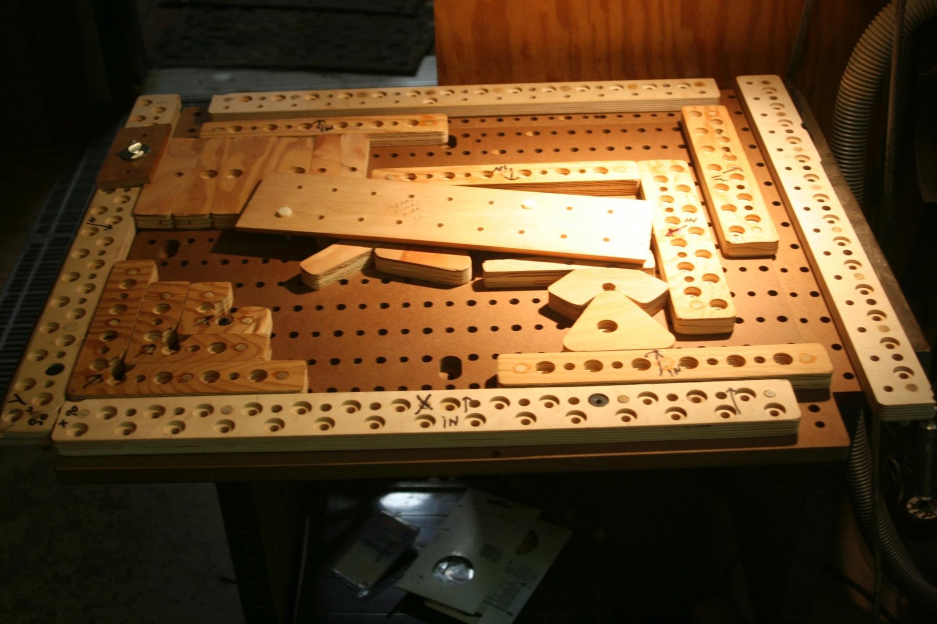

    Don't have any pics right now of deep cutouts, but to give you an idea...

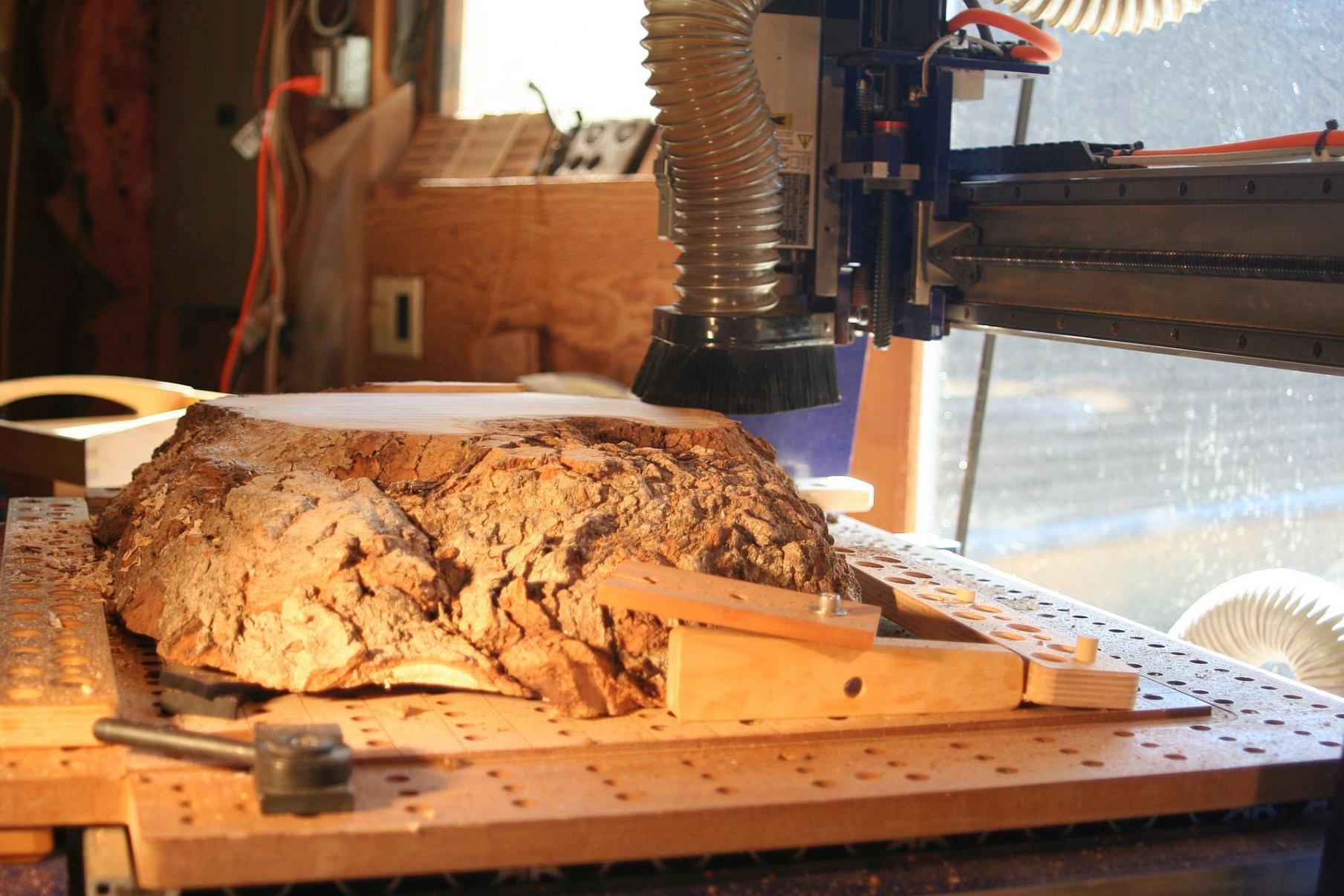

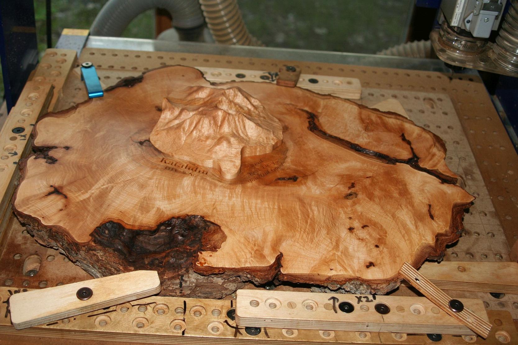

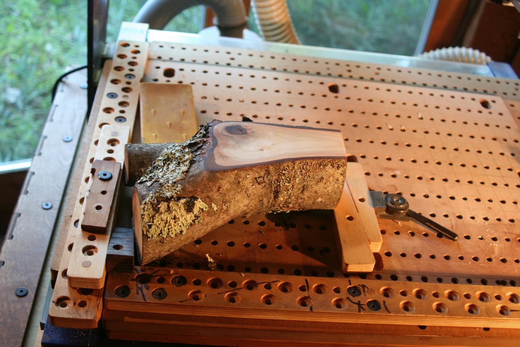

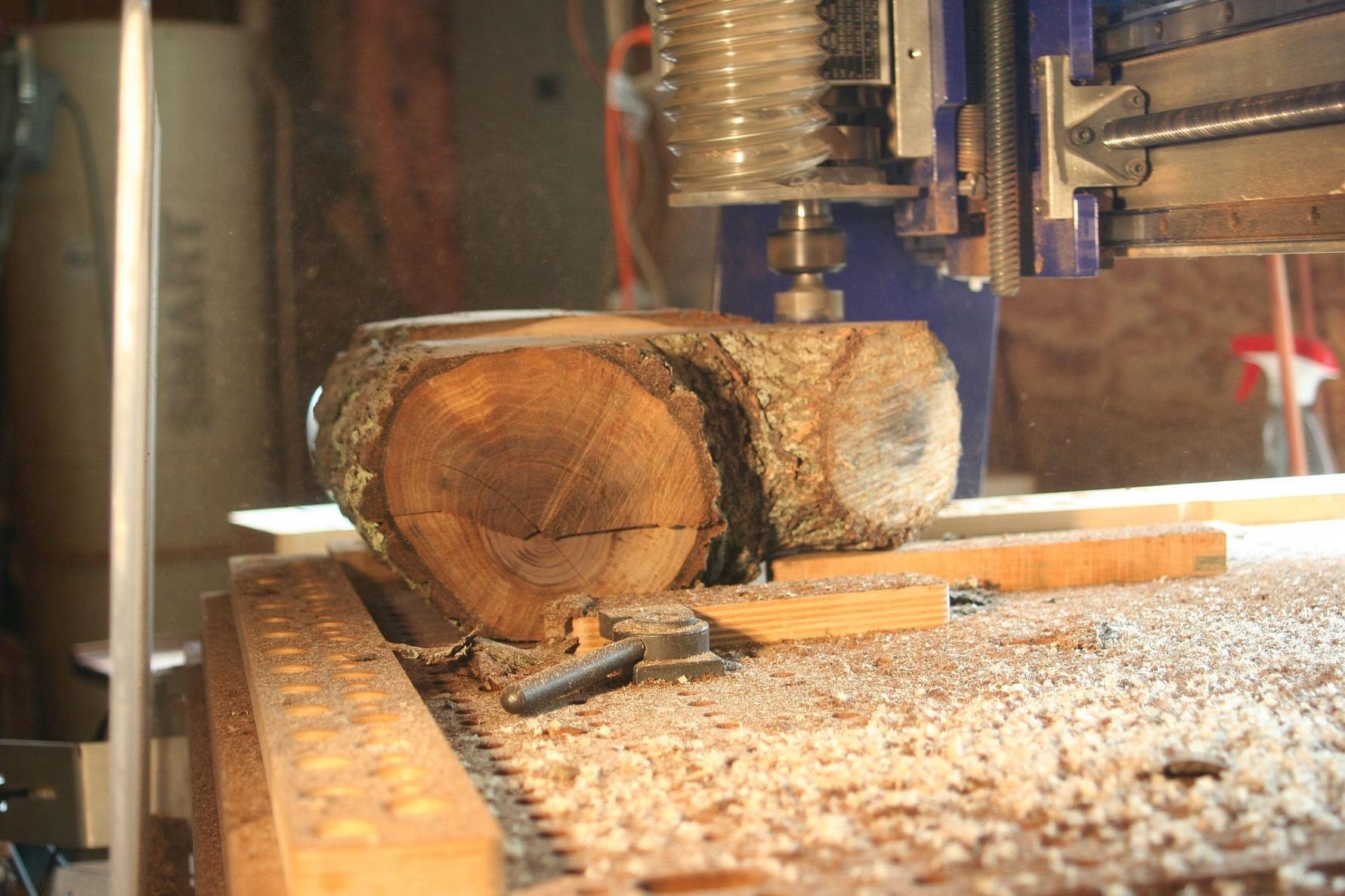

    I Do surface a lot of Sugar Maple/Walnut branches and both W Oak and Sugar Maple Burls with a 1.25" Whiteside morticing bit at 2-3IPS,
    and first several roughing passes are anywhere between .1-.2" depending on jigging stability with no problem before I get to a nice depth, and go shallower for finish passes.
    May give you an idea, as you're already experienced.

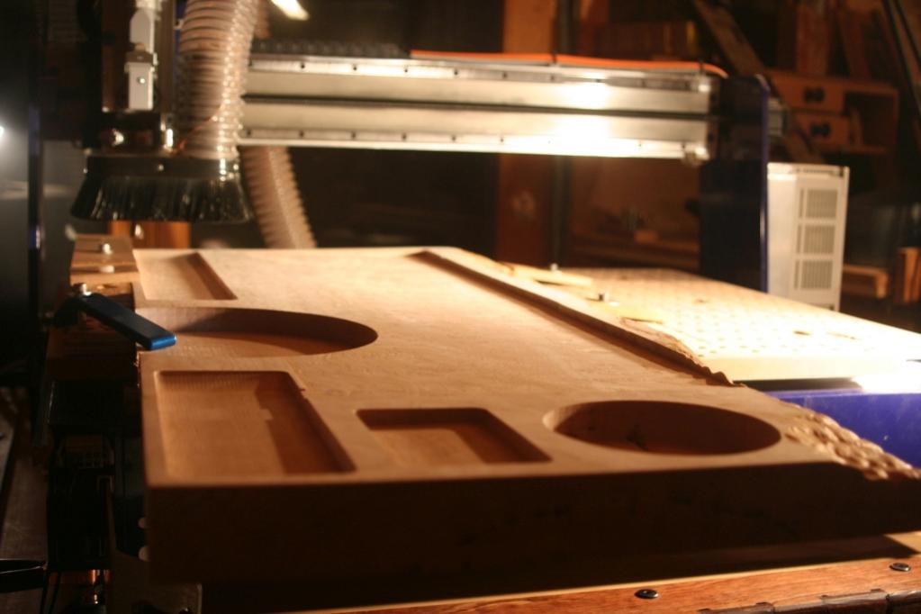

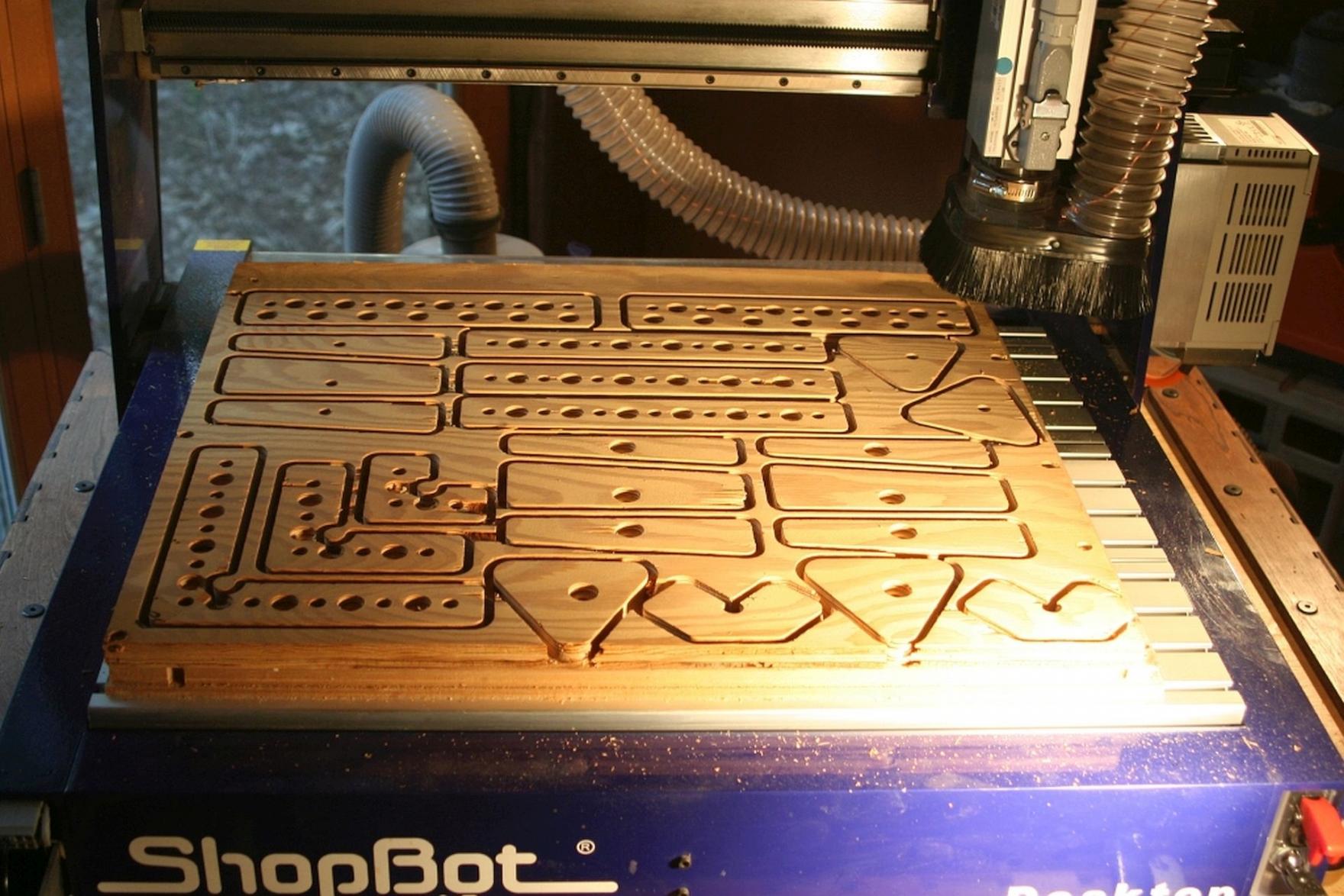

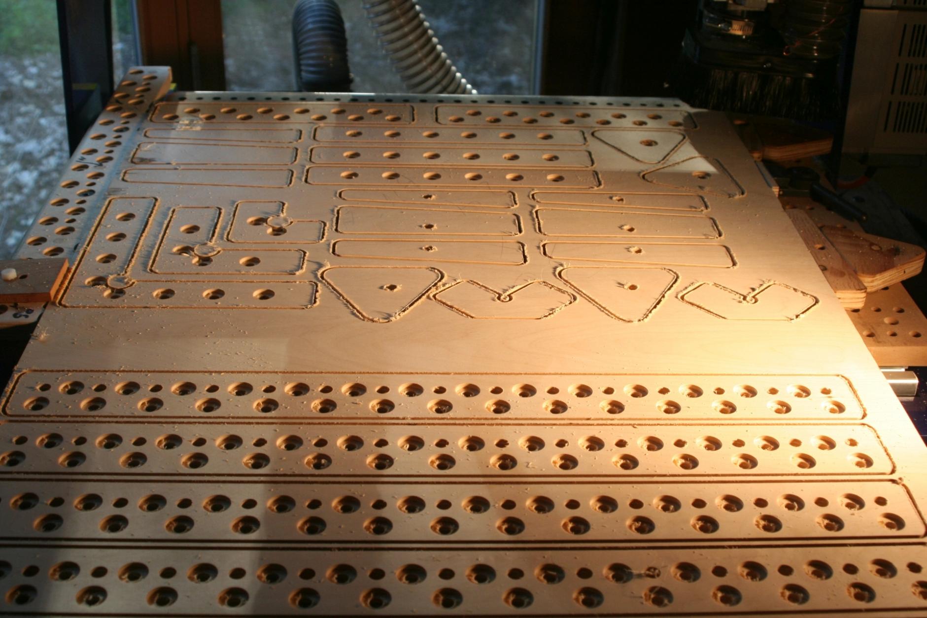

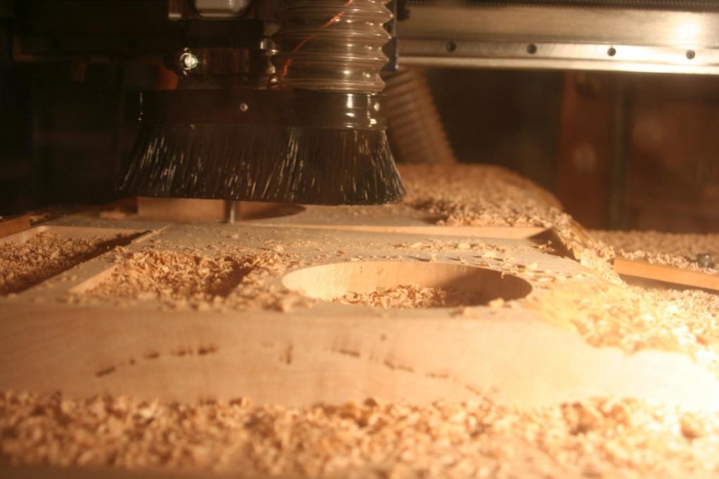

    I rarely cutout on sheet goods(full sheets and wheelchairs don't mix well) or thick hardwood with a .25" bit.
    I tend to cutout BB ply/up to .9" hardwood/etc. with a .125" EM (Kyocera for Carveright) because I nest close to reduce waste when I do.
    BUT I was a Total Newbie, and listened closely to Brady and others for tweaking my bits for the "Sweet Spot".
    "Start at 150IPS at 1/2" bit diameter passes...and then tweak up and down from there for hardwoods"
    And I never had a problem...so a .15"ish pass depth instead of my .125"(always about the finish of the cut for me) seems entirely doable.
    I don't have many pics of cutouts on ply, but back then it was all 1/2D passes and 40% stepovers and some bits were run at 10K and 2-2.6IPS to run cool.
    (I can see my .5" Centurion FEM downshear in my Big Leaf Maple "computer shelf", and that would be running at 10K,.25" pass,40% stepover, with Fluting toolpaths running up to 3/4" deep
    cutter depth after initial cut was made as it was only cutting the stepover)
    So I can't directly answer your question except in other contexts.
