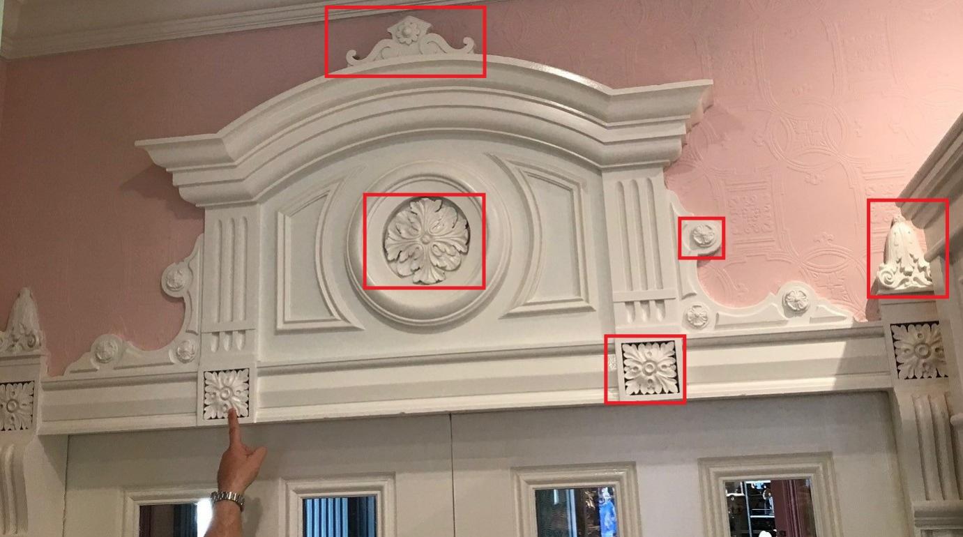

    Customer has an existing door with an ornate pediment that they want to duplicate for an adjacent door opening. All of the column toppers, rosettes, and medallions look to be custom made, and I can't seem to find these exact styles from any of the custom millwork suppliers online. I've checked White River, Van Dyke's, Carved Decor, Heartwood Carving, and a few others.
    The other other options that I see at this point are:
    1) 3d scan the elements and try to recreate them in Rhino or Fusion360
    2) Make a urethane mold and cast them
    3) Photogrammetry?
    4) Some other option that I haven't thought of yet?

    I suggest making a silicone (silicone is easier than urethane) mold and casting them in either a resin or plaster. Making a mold is pretty straightforward and what comes out should be very close to what went in. You could probably construct a mold box using aluminum tape (like the HVAC folks use) and make the mold in situ.
    If you've never made a silicone mold before, this website has excellent tutorial videos.

    Thanks for the input, John.
    We have a guy in house that does silicone mold making. Figured this was the best bet, but have you priced out silicone lately?! Crazy expensive! We were trying to go with a cheaper alternative, but still may end up going this route. Great article and work there, BTW!

    Silicone is probably the better choice if you're going to make the mold on the wall as it won't stain, won't stick to anything except itself (wax the items to be cast with Partall #2), and is likely to stay in the mold as it's got a very high viscosity. Anything that does seep out will just peel off the wall.

    I totally agree with Coryatjohn's recommendation to make molds and then cast the new parts you need.
    1) The original parts are almost certainly made of cast composition or maybe plaster, not wood. (Look at Chicago Decorative Supply, their catalog has parts they have cast for way more than 100 years... https://decoratorssupply.com this is how they did such work unless a mansion was being made for Cornelius Vanderbilt.) And if the original parts are cast as I expect, you will note that they are exactly identical to each other, and they will have a huge amount of detail. Molding these parts is then in the spirit of the original work, as well as providing exact matches, that are highly detailed.
    2) CNC carving these parts will be very time consuming even with off the shelf designs, especially if you aren't pleased with the detail and then add manual undercuts, and do chisel work etc to improve their detail (as I did on the few times I made Victorian replacement parts). Chances are, the new parts will never match even if you model them yourself.
