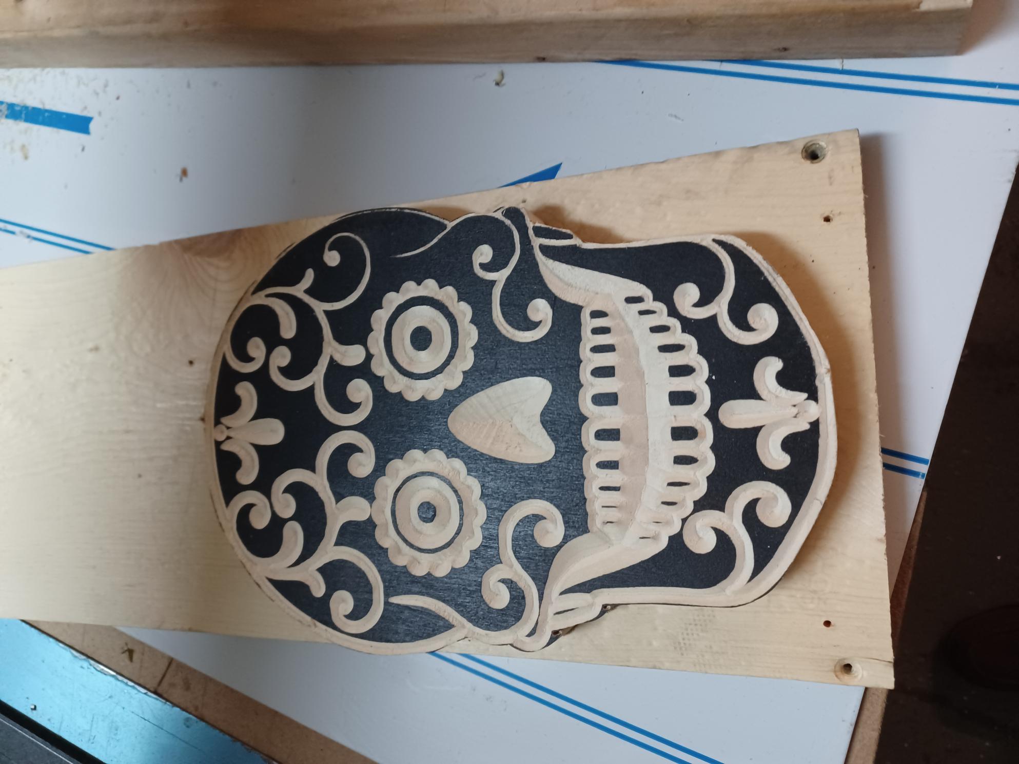

    Folks,
    I've been playing around with doing some v-carved items. it's not that I want to sell stuff at craft fairs. i know a few people who already do that an am looking to sell "stuff" wholesale to these people. i've found that wood stock, (even the "good" stuff from someplace like Rockler) isn't very flat. See the attached photo. The skull is 8" tall x 5" wide so any variations from side to side are obvious. This partuicular piece of wood was only off by about .05-.07 from left to right, varying a bit from top to bottom. Another test run (four of a similar skull) had details completely missing, or cut much too deeply between the different units. Even though we're only talking about a few hundreths of an inch variation, the v cuts just don't look good. and yes, I am making sure that there isn't any crud under the blank. The very first one of these that I cut was even worse because of "stuff" under the blank.
    On other non-symetrical designs, the variations on the blank aren't as noticable.
    Would a planer be a good investment to get this stuff as flat as possible, or would a drum sander be a better tool? I make electrical signs so wood is a new area for me. Ask me about steel, lighting, concrete etc and I have half a clue. Wood, not so much.

    No, a planer or drum sander isn't intended to flatten, it's to smooth the surface. On both of these machines, the infeed/outfeed rollers will press the cupping out of the board, and as it exits, the cup rebounds.
    A jointer is intended to make boards flat, or try what I do, and on intricate designs, I have a 3" surfacing bit that I run over the face to flatten it before running the engraving. Using this method, ensures the board is parallel to the v-bit and gantry, even if there's crud underneath.

    I was afraid of that. As i said in the OP, I'm more experienced with metal and illuminated signs. Working with wood is fairly new territory for me. I do have a couple of surfacing bits - 1.25" that came with the machine and a 2". The 2" was a good investment because it dropped my bed surfacing time from ~45 minutes to just over 20 minutes. Maybe next year I'll put a 2.5" or 3" surfacing bit into the shop budget.
