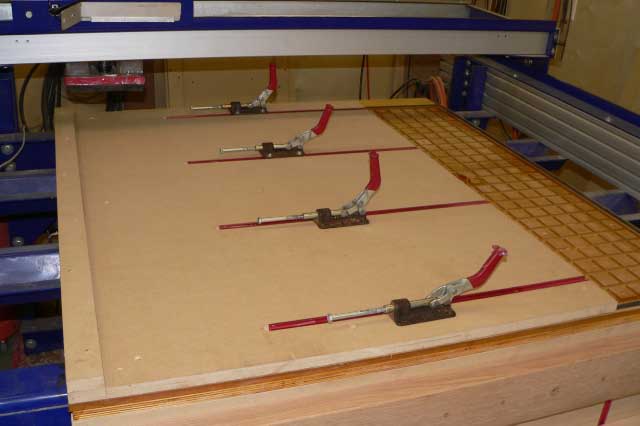

    I thought I would post a few photos of two holding fixtures that I've made in the past couple of weeks. I use the Bot primarily for making furniture parts. I often times have a need to flatten and surface hardwoods larger than my 6" jointer and 12" planer can handle, so I made a fixture to hold lumber up to 24" wide and about 50" long. I'm using a 2.75" surfacing bit from Magnate to do the surfacing, and it works very well.
    This fixture is similar to the one Steve Knight described recently, and I actually made mine a few days before he posted his. Great minds think alike!! I was thinking of ordering the cam clamps from Grizzly like Steve used, but I had a bunch of the DeStaCo clamps lying around, so I decided to use them. They work well enough, but I have to be careful that the spindle and dust foot will clear the handles, which point upward when the clamps are locked. I still might switch to the lower profile cam clamp.

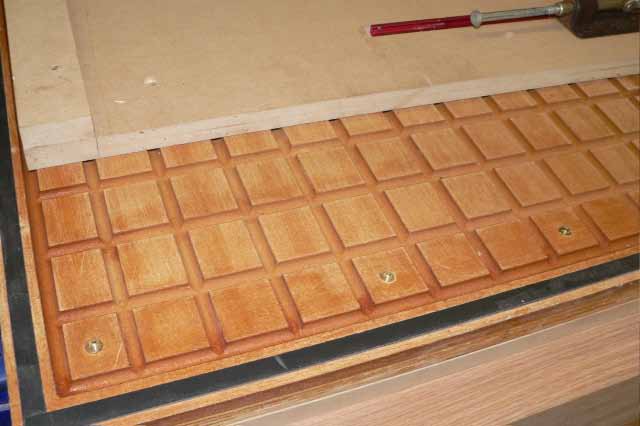

    This fixture screws down to the vacuum plenum into threaded brass inserts that are inserted within the plenum. I can use these to hold down any specialty fixtures that I make up, so it allows good versatility and secure fixation of the jig.

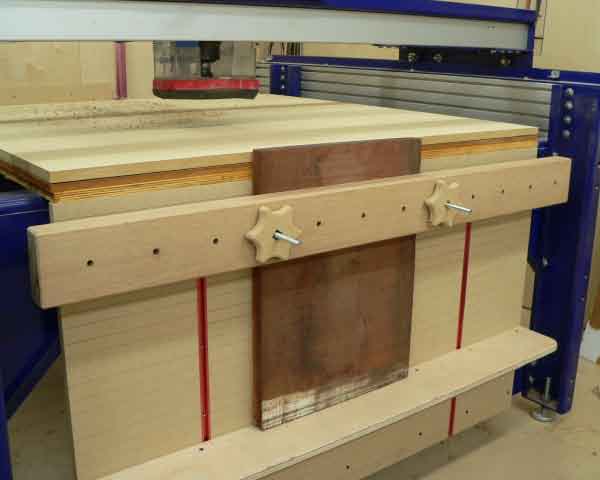

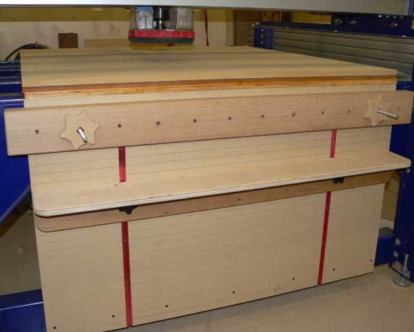

    The other fixture is for holding pieces vertically on the end of the table to cut mortises, tenons, etc. The vise has multiple holes that match up with 3/8" T-nuts in the panel. I can then put threaded rods wherever I need them along the length of the vise in order to get the greatest holding power. The vertically adjustable shelf allows me to set a height according to the workpiece length for repeatability. I scored horizontal guide lines with a 60 degree V bit to assist with setting the shelf.
    I know these fixtures aren't as sophisticated or as ingenious as many of the devices posted to the forums, but I thought they might be useful to those who do similar types of work.

    Very nice. Simple and effective ways to add versatility and efficiency to the Shopbot. I guess you never have to remove the end fixture. Where do you keep the other one when you're not using it?

    have you had a problem with the screws coming out of the mdf that holds the tracks? I used 3/8" sheet metal screws but they are pulling out. they pocked out of the 3/4" mdf too.

    David, you're right about the end fixture. I just leave that on all the time. Since I only have a 48" x 48" table, the size of the other fixture is only about 36" x 48." I just lean it against the wall next to the Bot, and replace it with the Trupan spoilboard, which I store in the same location.

    I've only been using these fixtures a short while, and so far I've not seen any evidence of the screws pulling out. I do have some concerns about that, as there isn't much material for them to bite into. I used 3/8" square drive wood screws that have more pitch than sheet metal screws, so they should have a little better pull out strength.
    I guess the other possible solutions would be to add more screws, or glue in the t-track. The latter would make it a pain to remove them if you wanted to redo the fixture or whatever.
    Thanks for mentioning that problem, though. I'll need to keep a close eye on it.
