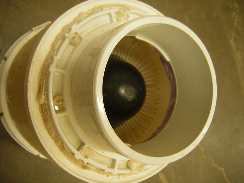

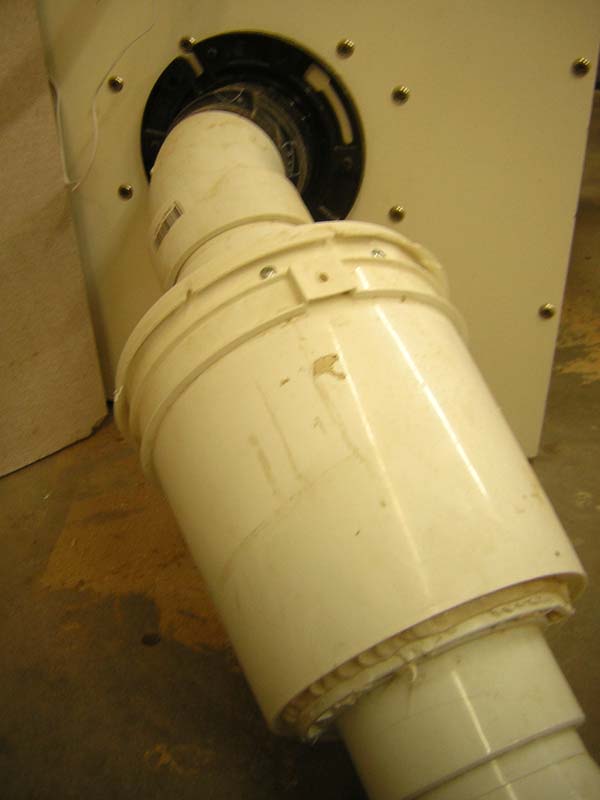

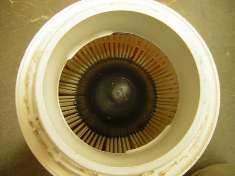

    BIG THANKS to Gary C and all contributors on the subject of vac hold down systems!!!. Just completed mine, and thought I'd share an easy in-line filter I came up with.

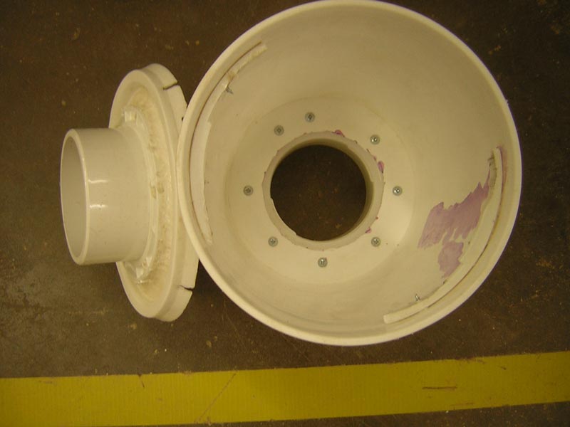

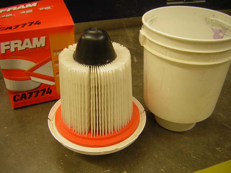

    Parts include a 1 gallon bucket w/integral lid seal (plastic resin or ultra-cat glue pails are ideal)
    Two 3" closet flanges, cut down to small diameter to fit top/bottom. (Using screws, fasten a couple lengths of cutoffs to pail, about 3/8" down from lip in order to force base of filter snug to lid upon closing.)
    Fram auto filter #CA7774.
    Screws and silicone:
