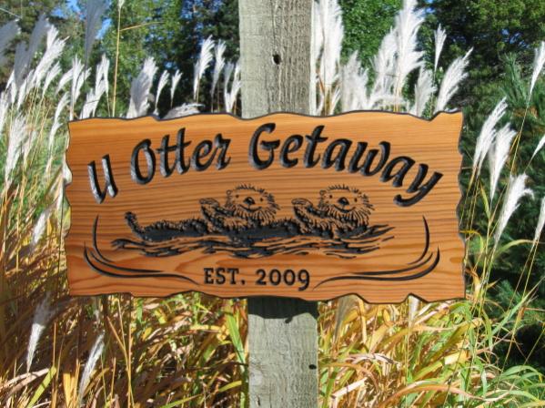

    Here are some of the cedar signs I've been making.

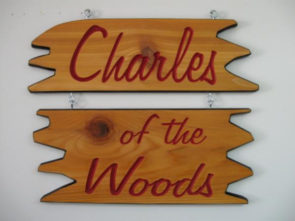

    Default Some more signs
    and here are some more signs.

    Very nice work. Are the stained ones done on cedar ?

    Thanks guys,
    These are all made from cedar. After they are carved, I spray on the black stencil ink. After about 5 minutes of dry time on the ink, I sand down the surface. Then I apply a coat of Cabot's "Australian Timber Oil". I use the "natural" finish and it seems to bring out the look I like.
