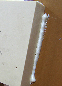

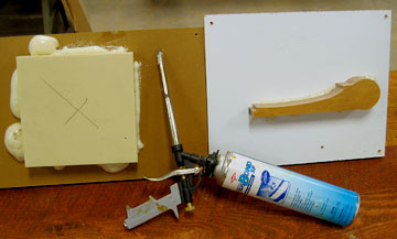

I've previously posted a technique used for holding small, or difficult objects. It can be used for any size however.
The photos shows our favorite foam adhesive and the despencer. It's from Deman Products. The can has lasted me about a year. It costs about $15.00.
Attachment 9044
Attachment 9045
Here's the way I do it.
Use a scrap substrate like MDO, Melomine, Plex or just about anything, on which you can place your "To Be" routed material. Go around the side of your routing material with the foam. Not underneath. This sets up in about 10 minutes. Now just screw or clamp the larger substrate to the router bed.
When finished routing, you can go around the sides with a putty knife and along the bottom to relieve it. Don't worry about this stuff giving up the Ghost. It's really tough.

The product is EnerFoam 42 made by Demand Products. It's on page 39 in their catalogue or you can find it by a search for glue.
This is a really tough, tough stuff that cleans up nicely when cured.

I have used the same principle, but with a hot melt glue gun.....it sets in seconds.
Paul

I'm not sure. It seems this is much like Gorilla Glue only less dense. It's a good thought and might be worth a test or two.
Holding smaller pieces for routing has been the subject of discussion for some time. And the most common solution offered, has been Vac Pucks or throtteling down a big vac area. What a pain. Since we scrapped our whole vac system, three years ago, it's been clear sailing with physical hold downs.
I'll post a few other novice techniques as time goes along. The Oak object in my photo is one of my newly designed hold downs. I have three sizes. This one is 12".
