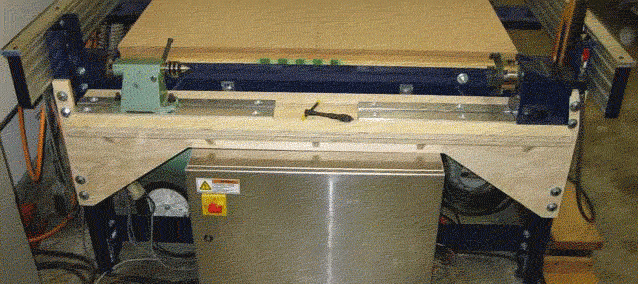

Hello,
I recently became the owner of a PR96. THe unit came with an indexer that I would like to implement into the system. I have chosen to mount the unit on the Y axis. Because of the way the cross supports are layed out on my table, I only have 8" of travel from the end of the last cross support to the end of the X axis travel on my machine. So my question is, Should I assemble the indexer so that my horizontal center line is at the end of the X axis travel or split the difference between this and the last cross support? Does that make any sense at all? THanx, Marc

Keep in mind that if you mount your indexer on your table your turning radius limit will be defined by the Z travel your machine. The center or the indexer is going to be roughly 6" off of your table if you bolt it to the table. I have a PRS 9648 with 8" of Z travel. If I had known, I would have ordered a machine with a 12" Z. I built a table and mounted my indexer off of the end of my machine so that I could get the most out of my Z. I can turn up to 10 inches round.

My indexer is mounted similar to Jim's.

Also another good point I didn't think of. Yes I have a standard 6" of Z travel. So if I am understanding this right, No matter how low I mount the indexer, I can only mill up to 6" before I run out of Z. So I guess the best case scenario is to mount the indexer so I will have full Z travel. As far as the X travel is concerned, I just need to figure out whether I will be doing more projects that focus on Z travel(spindles) or projects that focus on milling objects that require a broader X travel. Hopefully this makes sense. I guess I am just chomping at the bit to finish this part of my system.
You need to measure the swing of the lathe. That is how far you ned to mount the indexer away from the table. Otherwise you will limit its capacity. I have the center of mine about 1/4 inch away from my limit switch in the x direction. you don't want to worry bout hitting it in the middle of a file. you don't want to know how i know this. I also built a riser block on my indexer to get some extra swing, and mounted the center of the lathe a little below the top of my table so i don't have to worry about running out of z on large turnings.
