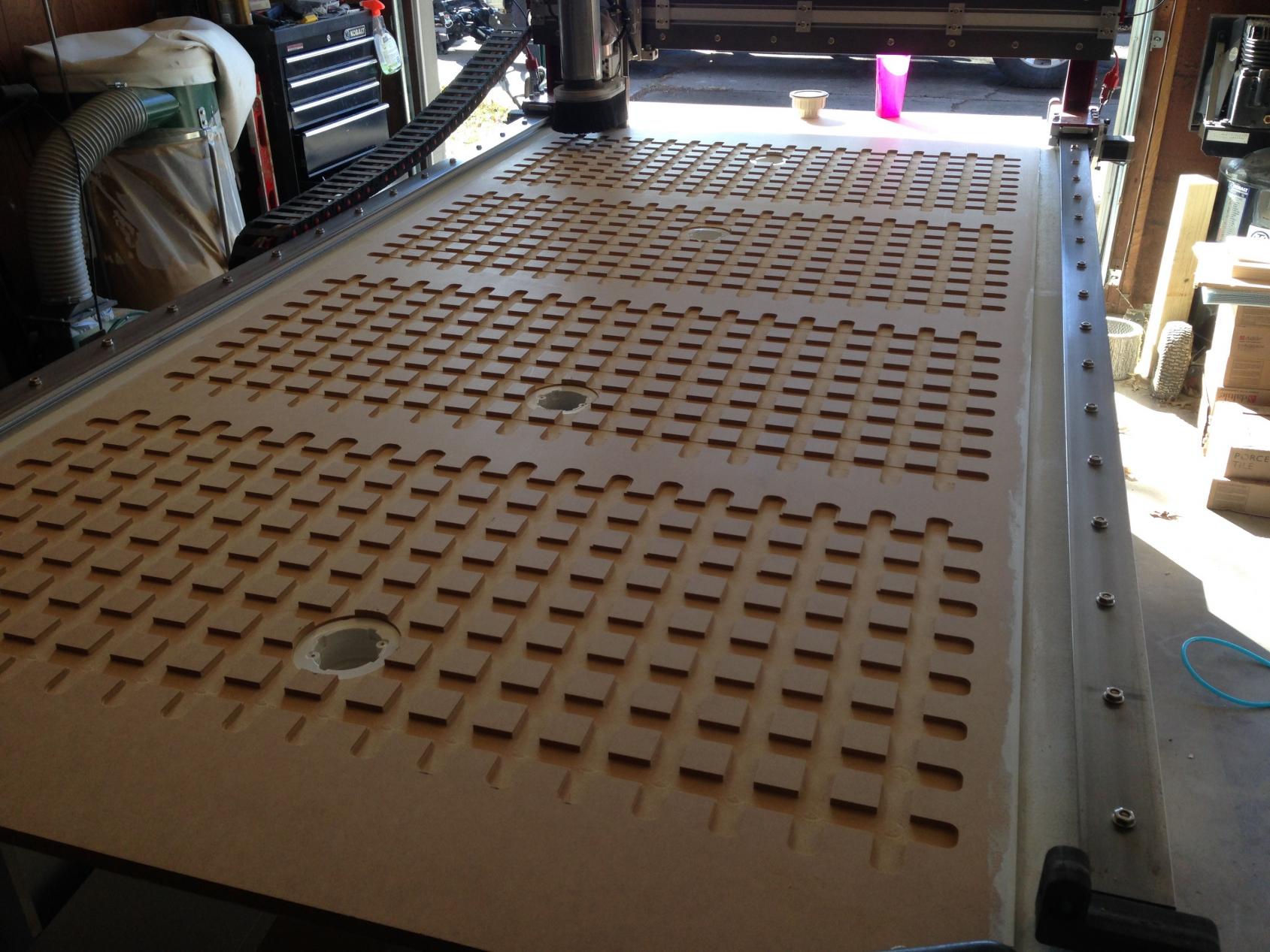

Also I decided to go with a variation of the plenum from I believe one of Chris Brady's designs
Attachment 24594

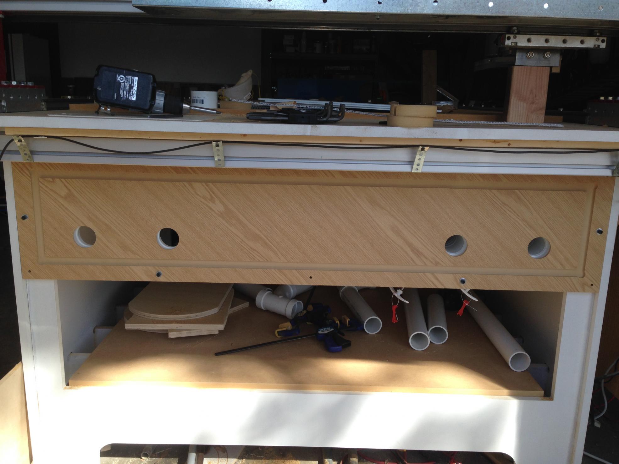

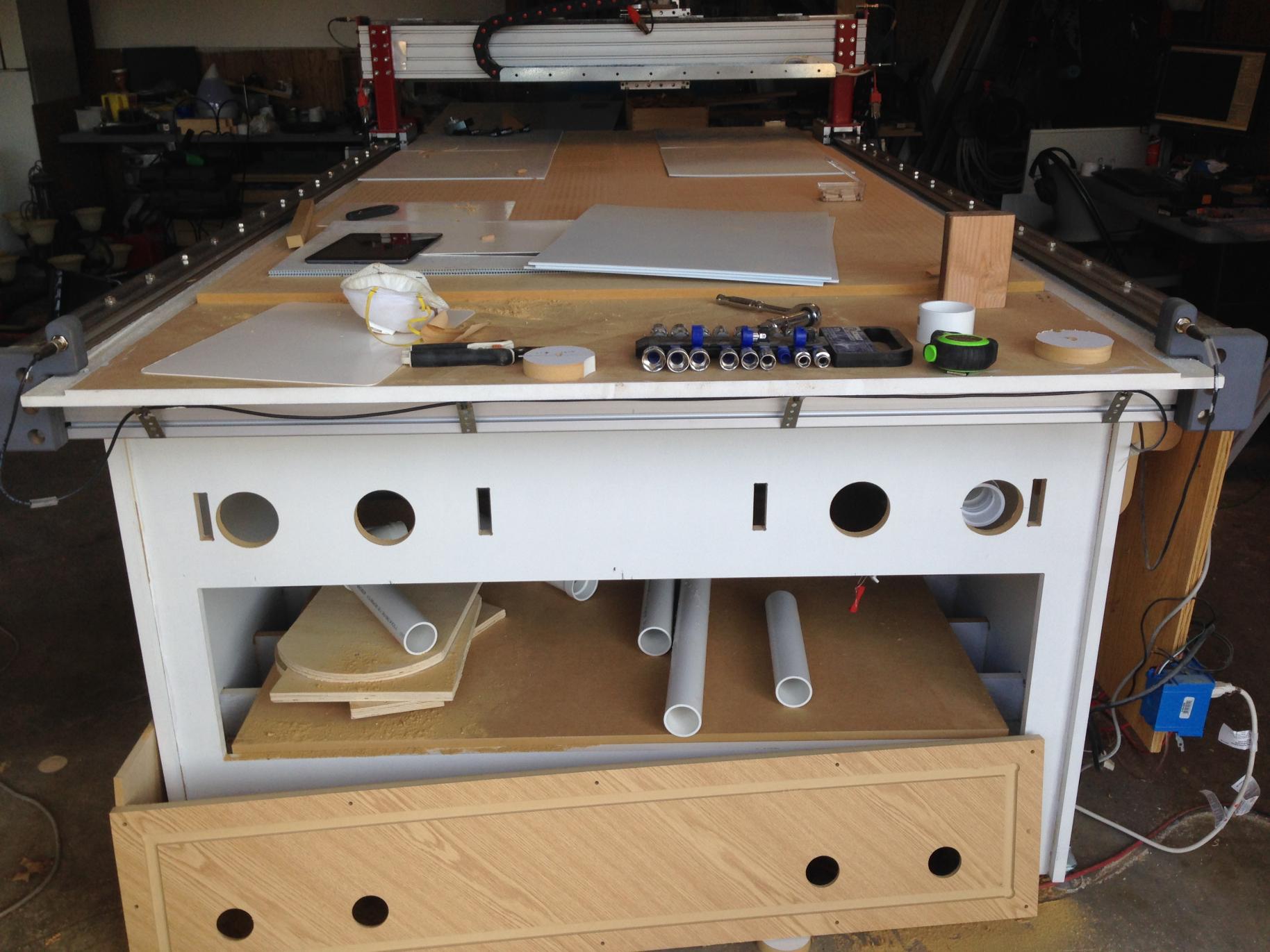

Basically there is a back plate that I can bolt to the end of my machine that faces the garage door, and corresponding holes in my stand that lead to 2" PVC pipes routed to the 4 zones in my table plenum. Each zone has a gate valve up under the table right behind where the vac box attaches.
Attachment 24595
Back plate in place
Attachment 24596

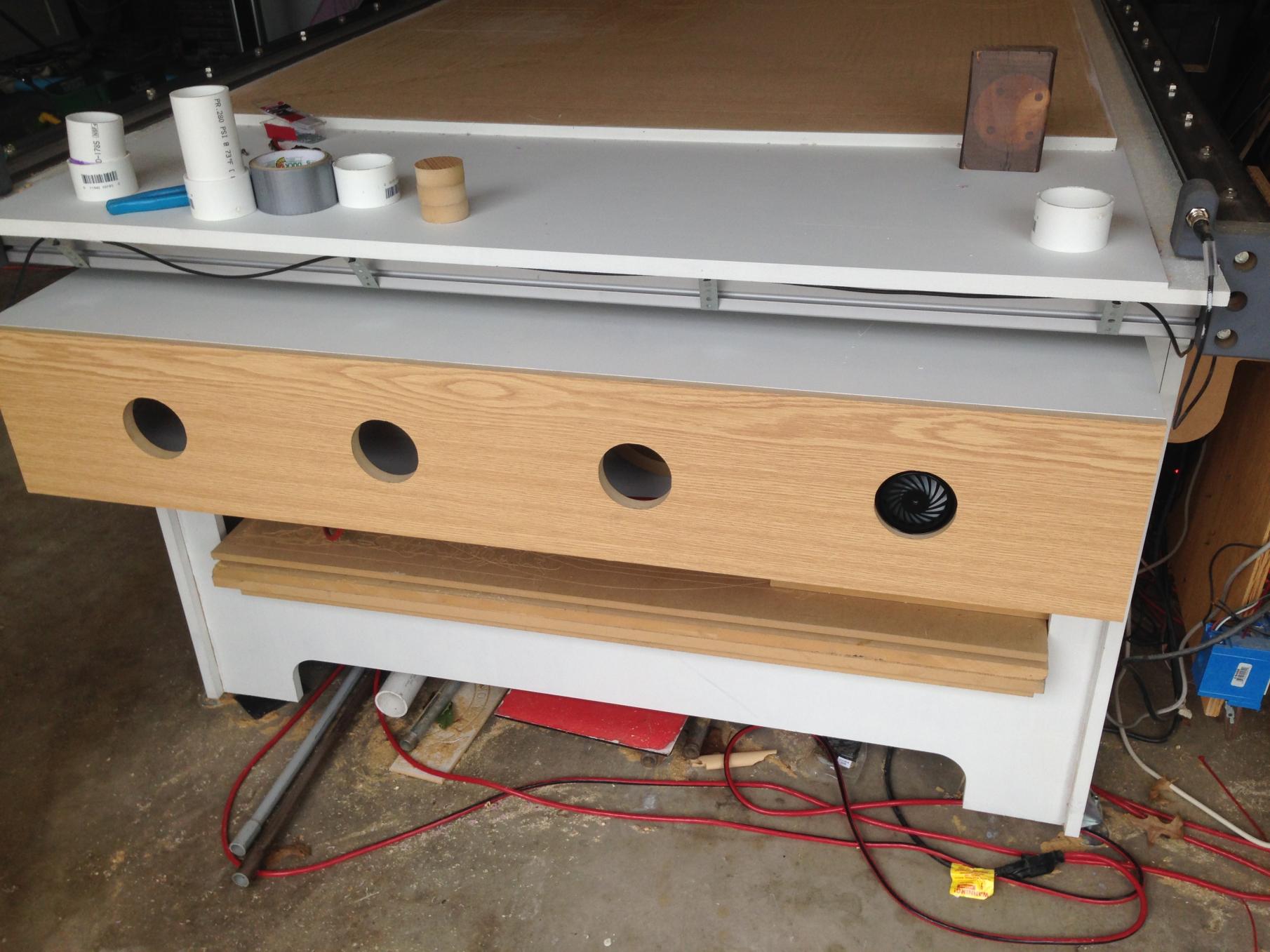

This was all routed out of 3/4" melamine that a friend sold me cheap b/c it was a maple wood grain patter that he no longer liked. I plan to paint it all in the end so it was a good deal.

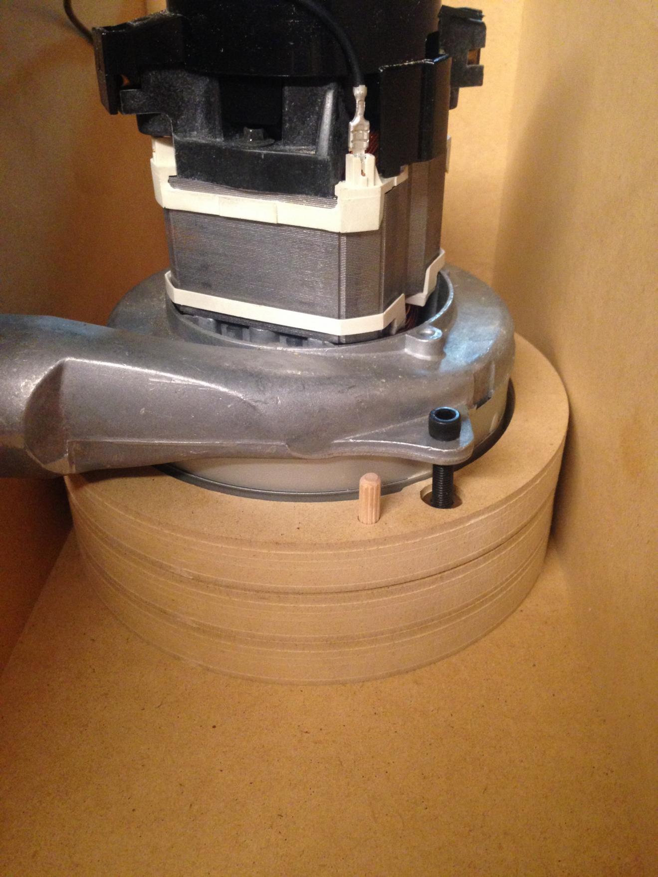

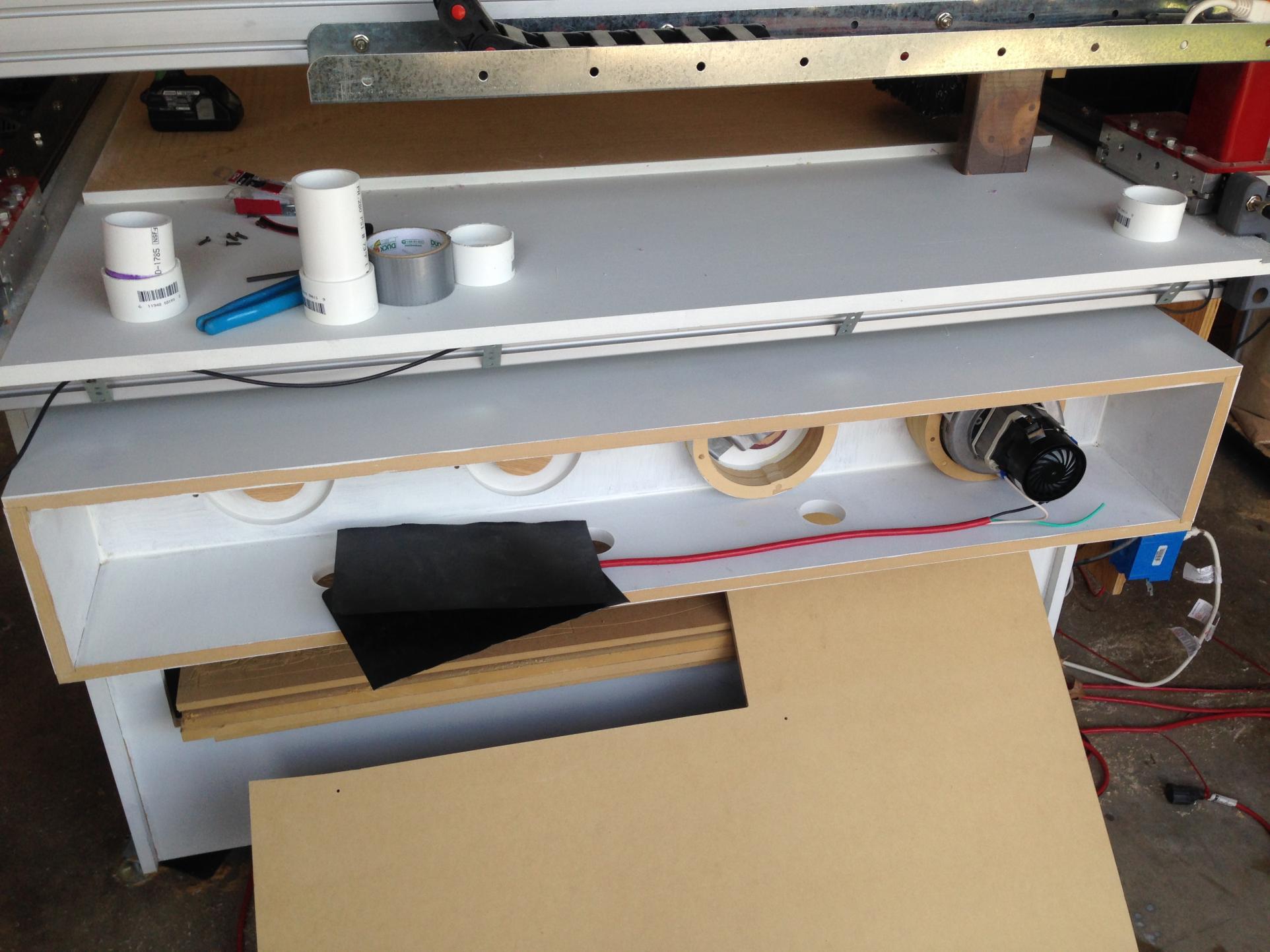

I test fitted the back plate and all was well, so I glued up the vac box and glued it to the back plate. The vac box is 12" from back plate to the lid where the fan holes are located. Around 4" of the vac box is plenum that all of the motors will share which is also connected to the stand plumbing via PVC couplers which are cemented to the back side of the back plate. The remaining 8" is dedicated to the motor housing and lid.
Picture of the vac box plenum from above
Attachment 24597
