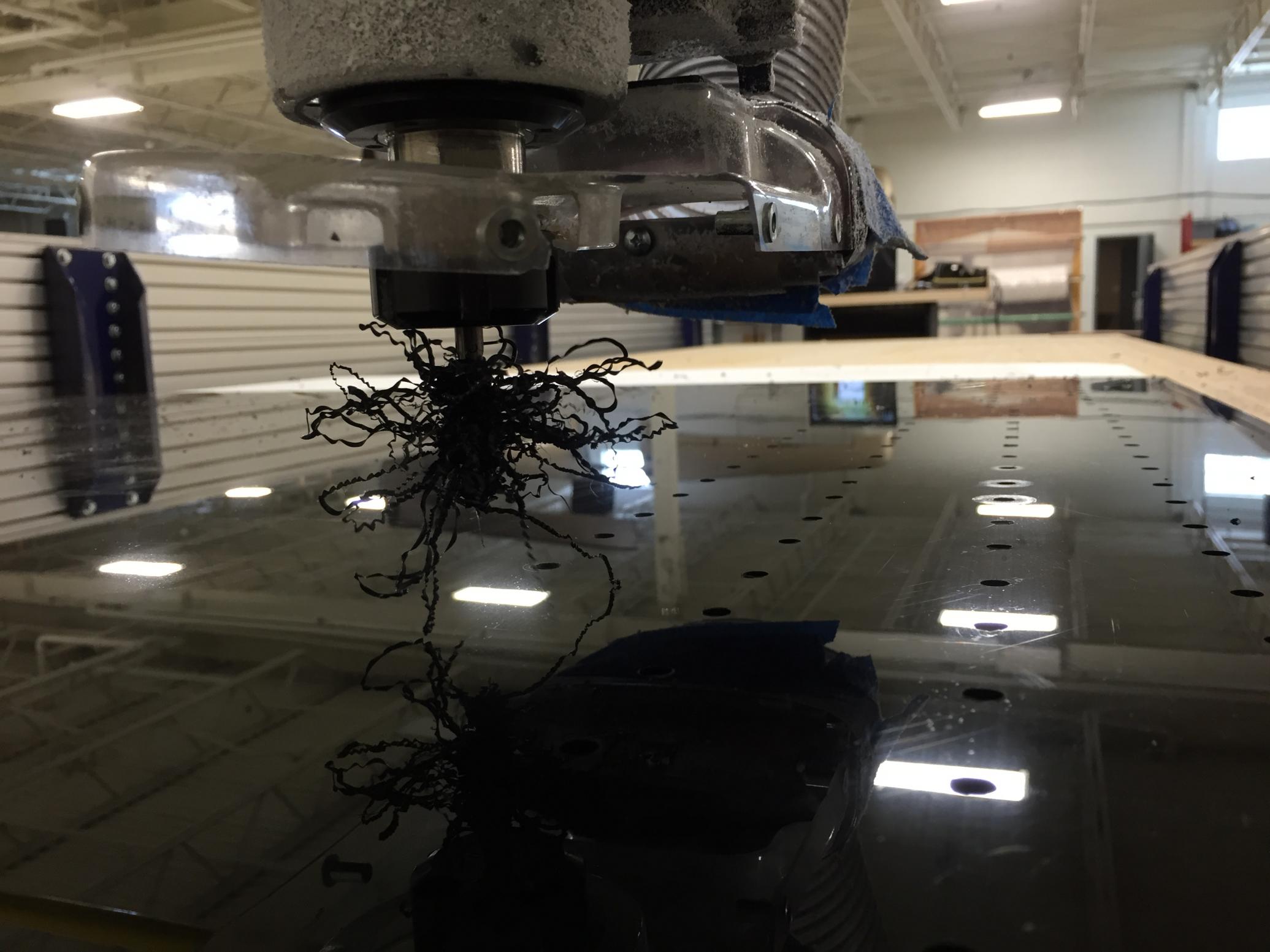

hi folks, I recently got a new job where i'm going to be CNC machining a number of new materials,i was machining ice before, and I had a machining job come down the pipeline where i have to cut 1/4 in black hdpe plastic.
I'm sure i got a few things wrong here, For the job i'm using two bits an 1/8 inch ball nose bit (i think it came with the shopbot starter bits) and a 1/4 inch bit for drilling some of the holes. when i ran both of these bits i had the hdpe chips tangle up in the router bit, causing me to stop every so often to clean it off.
the 1/8 inch bit also broke on me when the job was nearly done, i'm running the spindle speed at 12000 rpm and the cutting speed for the 1/8 inch bit was 2 inches per second (I'm using v carve pro).
if you look in the picture the hdpe is sitting on top of a foam sheet and is taped down with a strong double sided tape but i don't think im going to continue doing that in the future
any suggestions would be greatly appreciated
