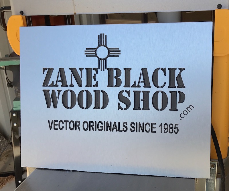

Looking for advice from anyone with experience cutting aluminum clad pvc sheets (aluminum composite material (ACM) made of two sheets of .012" aluminum with a solid polyethylene core.
We are not sure if these sheets are able to be vcarved.

I have V carved lots of it. Like Joe said it carves like butter with a good sharp bit
Got slag cutting at 20ipm. Will try a faster speed and take pictures. Hold on...
Attachment 29980
Results today.
Depth of the material (ACM) was 0.13"
VCarve depth at 0.1"
We upped the speed to 40 ipm.
Router speed: 17K
We put a fresh cutter in the 90 degree vbit.
It cut smooth with no aluminum slag. We are impressed.
We have a video but don't know how to upload it here.
Hope this helps everyone.

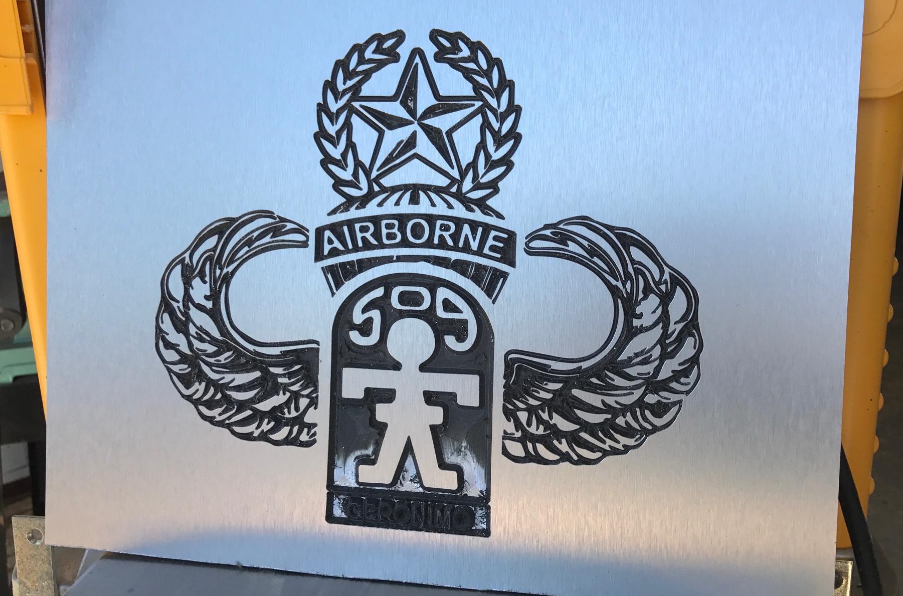

Attachment 29982
Another example.
Looks like we stripped off the aluminum around "GERONIMO"
I have pocketed out a lot of dibond with a straight or downcut bit down to 1/16" I have found sometimes the faces of letters come off no matter what. I did several hundred tap handle faces where I pocketed out around the letters. the first sheet was fine never had a face go flying and the cuts were clean. the second sheet I kept having letter faces come off and a lot of fuzz. I used fresh bits and the same toolpaths. this was the read dibond too. so it can really be different sheet to sheet.
