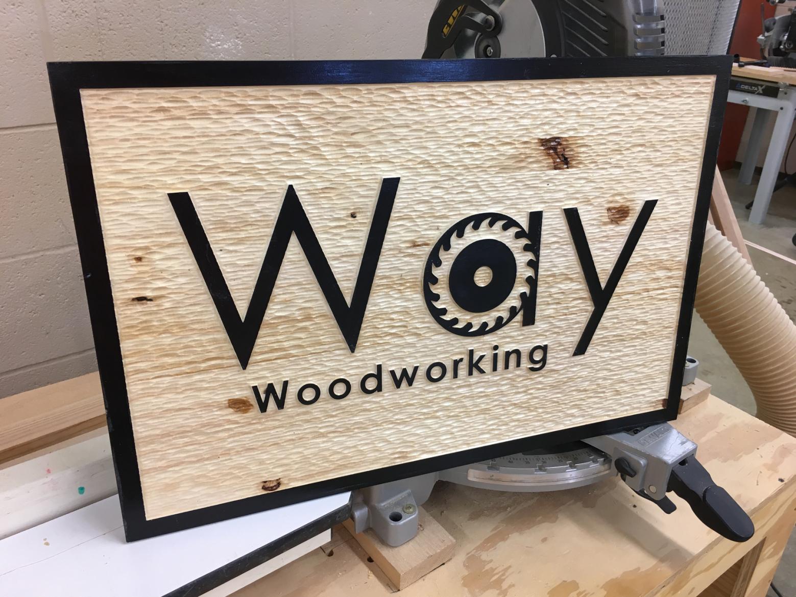

It may be a little extra effort to use pine, but the profit margin is there considering how cheap these panels are from big-box stores. 24x16 inches. Pine board from Menards. Black surface, recessed field, textured with 1/4 ballnose end mill. Polycrylic finish.
