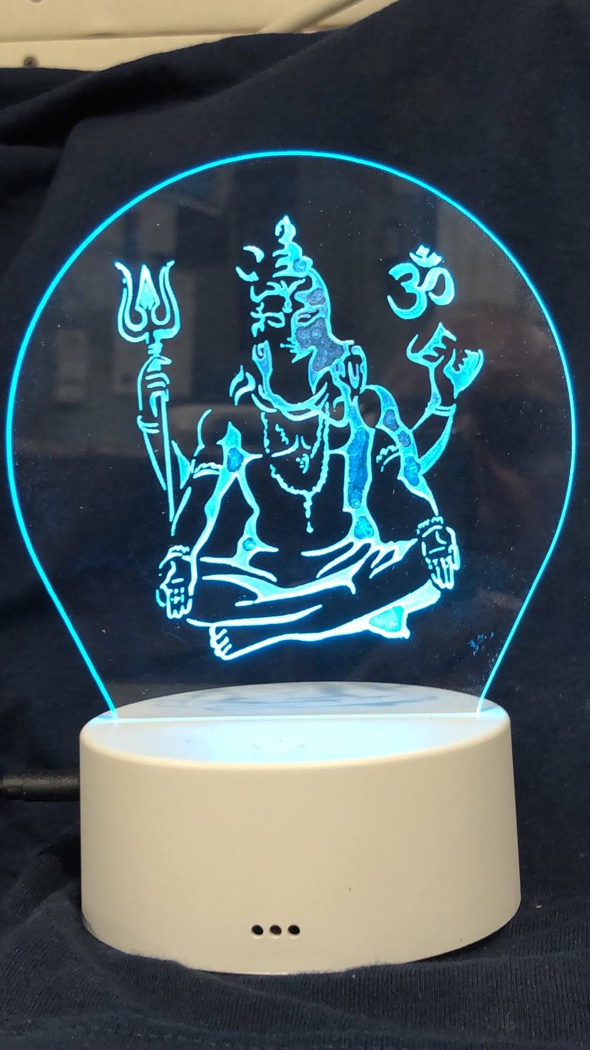

Just one of many projects cut from acrylic.

I'm still pretty new to using my toy but recently cut faces for illuminated letters out of 3/16" white acrylic. I used a 1/4" two flute end mill from Carbide Tool Source (~$5 a bit) and they are USA made in Oregon. I ran it at 16k RPM @ 1.75 IPS but am sure i could have gone much faster. It was the first time cutting plex on my "toy" so i went sloooow but nothing remelted. Also, i have a vac hold down table but you could also get some 3M spray glue and attach your plex to some kind of backer sheet to make sure you are cutting all the way through the material - assuming you want to cut all the way through of course. I have a friend who used to do all of my routing and he regularly attaches sheet goods to a cheap carrier, especially when thru-cutting .125"-.250" aluminum. He doesn't have an LDF bed so cutting into his table is a bigger deal for him.
I have been cutting, engraving plastics for a few years also and have to agree with the folks who said to purchase cast acrylic. I run my spindle at 12k with no rewelding from 2 fluted bits from 1/16" endmills and ballmills or v bits either.http://www.talkshopbot.com/forum/att...id=34994&stc=1http://www.talkshopbot.com/forum/att...id=34995&stc=1
