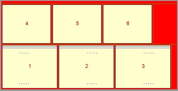

Thermwood doesn't have the software set up to export in dxf. I think their routers take iso standard g-code. It does allow me to print the nested sheets or produce a jpg directly from the screen of each nested sheet. I don't know how to attach a picture here. I can email it to you if you wish.

So, what I have to work with is a color picture of the nested parts. I'm not sure if I can use this picture of the nested parts and get to a shopbot file that I can use. The picture does have detail, like grooves for back, dadoes, shelf pin holes and cutter path. It would be nice if there were a way to use it without buying the $6k add-on package from Cabnetware or a $70k Thermwood router!
If you guys don't mind, I'll email you a copy of the nested parts. Maybe by looking at it, you can help?

Chris, Bill seems to have predicted it quite correctly. The .jpg resolution is way too low to try and convert and the .twd file has been coded. Here are pieces of the files, in case another SB'er is more optimistic: (the jpg is original resolution)
Attachment 4522

It would be "one more step" but, the JPG file could be put in RHINO (or any other program that will allow "over tracing") and manipulated.
Pull the individual parts into VECTOR and put on the "Rhino developed" layout.
