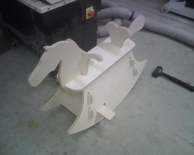

Hi Theresa, this is a file I found on CNCZone. I cut it on my Buddy 32 using a 3/4 birch ply. I was able to get two horses from a 4x8 sheet of ply (24x32 sections = 3 sections per horse) The design needs some tweaking and tuning (Hoping to make the mods this weekend) but it's a solid design with some great ideas to work from. I plan to modify the "Rocker" with some brakes as I am worried the horse could flip if my great nephew really gets to rocking
I am also working on a doll cradle design using the same concepts. (No fastners, stores flat nested on sheet goods, etc.) I will post both modified files with some photos when I get them done. The design would really be enhanced with some engraving and I am working on being able to flip the head and tail so I can put eyes,texture, mane, etc. on both sides. I think I have a solution but I wont know until I get it on the bot. If it works I will post photos.

Kelly, when you down load these how are you knowing what size bit to use or does it matter since you are cutting a profile?
Theresa, the only thing a bigger bit does is make more dust and leave bigger radius's in the corners.
If you get too small of a bit, it wont have a long enough clear cutting edge to penetrate the material thickness. I try to use the smallest bit that will go all the way through the material, that makes the smallest kerf, the least dust, and the sharpest inside corners.
Hope that makes sense-
D
I have been using trial and error. -Mostly error
- It really depends on the material, thickness, and what kind of finish you need.
I have been happy with the results from my 1/4 and 3/8 straight bits. (CMT & Whiteside)
The Dino projects seem to require a lot of mods to get right. The rocking horse was cut with a 3/8 straight but I suspect I would get a better edge with a spiral.
Hope this helps,
K.Z.

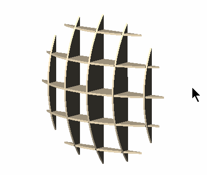

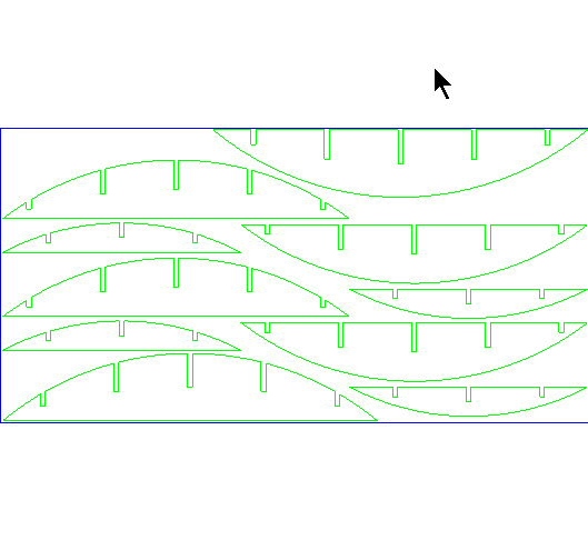

Radius shelves, unfinished. Gave me a headache lol
Attachment 7287 (35.0 k)
