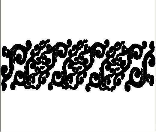

I forgot the speeds. I had the x axis set at .6ips, z at .2ips, indexer set to 960 steps per linear inch (prt control box, half stepping, 400 steps per rev, 18:1 gearbox, 7.5In in circumferance.) I have a very old pr32 (32x32x7 with ballscrew axes) and prt control with the older control cards.
My results on wrapping were disappointing so I want to go over them and see if you can tell me what went wrong.
I used Millwizard and took a stl in and it was 12" in X and 4" in Y.
Attachment 2868
and created a roughing toolpath and finishing toolpath.
Then i took the converter Jim Anders posted link:
http://www.spauldingbryant.com/sbconvert/
and ran both toolpaths thru it.
I then turned down a square to give it a 4" CIRCUMFERENCE (equal to the Y measurement of 4" of the stl).
Then i Zzero'ed the .25 endmill for the roughing pass to the center of the stock and this is the result:
Attachment 2869
I would gladly send all toolpaths to anyone who could read them and maybe figure out what went wrong?
