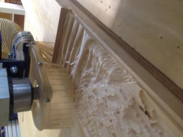

I think the choice of wood had a lot to do with your fibers ripping up, but I just did a Lacewood 3D and used a 3/16"upcut, and everything cut fine until it hit the first "Peak" of a mountain...It tore the fibers up so much it looked like a Chia Pet:( I only had a .02" skin programmed and it blew right through that. Wish I had taken a pic of it.
I swapped to my .25" downcut/ Z'd to my spoilboard like the first time/ Moved to a spot with a hole in it/moved Z to -.01/ and then Zeroed Z axis in Keypad.
That dropped my cut down .01" and cleaned off the tearout. It was the Lacewood fibers that made it so bad I think, but Butternut was the same way, and from what Gert said, Basswood is similar. Denser woods seem to cut cleaner.
There are other ways to trick/nudge Z down, but I like simple when I'm tired.
Just do the same thing with your finishing toolpath Z.
Seeing as you can't specify a Tapered Ball Nosed in PW3D, I like Joe's idea of cutting a relief so your finishing bit won't touch.
May want to decrease your stepover to reduce the ridges unless you like sanding more than I do.
Here's the downcut roughing in Lacewood....it's a World of difference from the upcut 2F disaster.
I'll give that a try. I roughed out around my carving with an endmill and no more issues with my 77-102 hitting sidewalls. Still made about breaking that damn bit. Feel like I just lit 60 bucks on fire 🙈. At any rate, here is a follow up picture. I changed the feedrate to 1,1,16k and man it's looking nice!Attachment 28964
