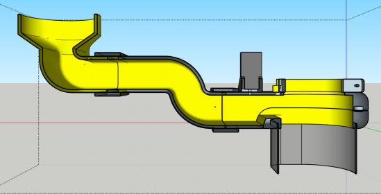

If at the first joint you made it angle up and make the round portion there would that work? That would make the part much shorter and faster to print. You might need to make it an inch or two longer to the first joint then maybe about a 30* angle with the round portion at that point. Just a thought. This suggestion is only if you wanted to make some for sale otherwise the one you made should serve you well as is.

Would 2 45's be better smoother transition
2 Attachment(s)
It's really smooth the way it is:
Attachment 30932
I don't think I'd gain much (if anything) by doing 45s. I wanted to get the pipes up and out of the way as soon as possible.

I'd love to measure the actual performance of one dust shoe over another... All I can say is that my "seat of the pants" analysis says that this is about 20% better than my Kent shoe, and far better than my ShopBot shoe. To be fair to the ShopBot shoe I think I had always been missing some sort of foam ring in between the foot and the spindle.
Brady, I posted the files above if you want to print this thing out. All you need after the prints are some 1/2" x .125" rare earth machines and a a handful of #4 machine screws with nylock nuts.
Thanks Eric - The foot you have won't fit either of my machines...plus I have my own design in the works to cover both 2D & 3D type of work. The original PRT foot was stationary. Set it to the top of the material and that's where it stayed (most of the time) - but it was a horrid design. SB redesigned the PRS foot for a few reasons...the first of which was to always keep the spinning bit covered for safety reasons. Worked OK for flat work but for non-clipart 3D stuff it has a tendency to gouge and get tripped up on the edges of material.
