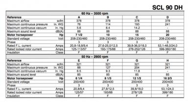

6.6 Hg" isn't a lot to work with. You would need a min of 4 Fein vacs to do anything for real and probably more like 6. Lighthouse motors are another option & cheaper.
Small parts with the Fein? I wouldn't count on it unless you are an expert on vac hold down...However there are ways around this. Look for my 'Vacuum Film Technique' on this board.
Remember - there is no replacement for displacement. The aspiration here is limp along using the Feins and other 110v solutions until you can afford a real vacuum pump made for production. This was the idea behind the Lighthouse vacuums - just a bandaid...so keep that in mind. There are no 110v (or 220v single phase) solutions out there made for production duty...so expect whatever you are running to die. Not to be all doom and gloom...but I call a rose a rose.
