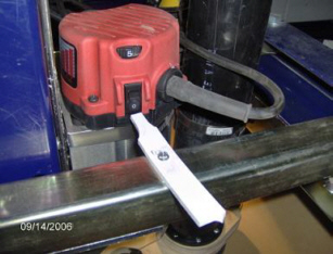

I'd just go with the finger on the Z axis like Robert shows, but I want to activate/deactivate the dust collector too.
