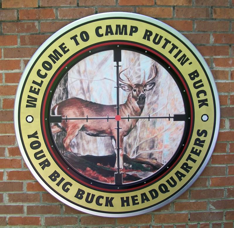

Cheap printed graphics? They won't look cheap as long as the graphics are tight, printed at high resolution, and look good. It's a way of adding a lot of color and design that would be eye-grabbing and fun with many possible themes for gears.
Don't discount print just because you have a Shopbot! One of the best signs I ever designed and made was a routed 2.5D job that was centered around exactly the kind of print I'm talking about:
http://i50.photobucket.com/albums/f3...2/Spike005.jpg
The sign was 4' in diameter and the customer raved over it! I would have taken me (or anyone else), a month of Sundays to carve that image 3D and paint it, and it never would have looked as sharp as the print did! NEVER!

mARK I WAS THINKING IN TERMS OF WHAT MY CRAPPY B/W PRINTER WOULD PUT OUT (OOPPS) like above.
I remember that sign when you first made that...Follow my thinking here...how i see your sign would be to keep the center with the deer static and the outside ring of the scope and name let that revolve.
That might need some type of movement like a clock that has a inner shaft for the faster second hand and a hollow collar for a slower hour hand?
and i thought i was the only one up nights....the only thing is i need to be back in my "sanctuary" before the sun comes up:rolleyes:
I understand your idea, but it could get quite complex and in the end, not as amusing as "everything spinning" for a typical kinetic gear display. The idea is for everything to spin, Mr. Jarvis! lol
