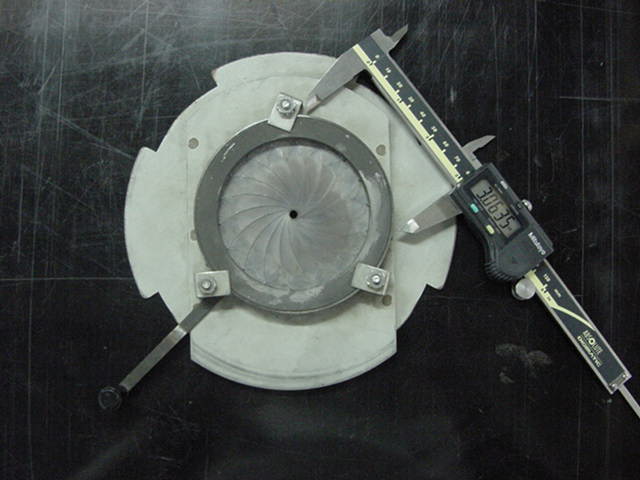

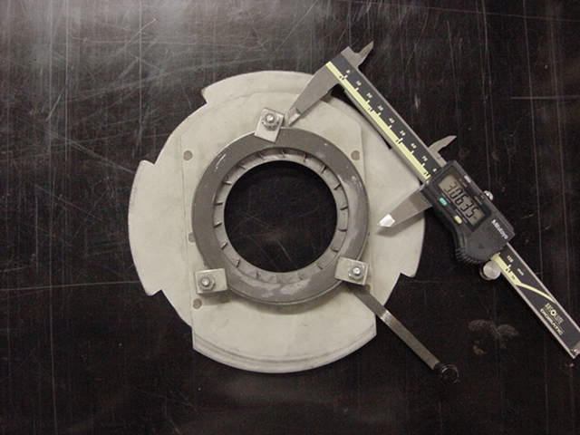

Michael Schnorr quite graciously broke out his micrometer and measured and drew up an old camera iris he had. As per his request I am posting the files for anyone interested.
http://www.schaie.com/shopbot/Michaels_Iris.zip

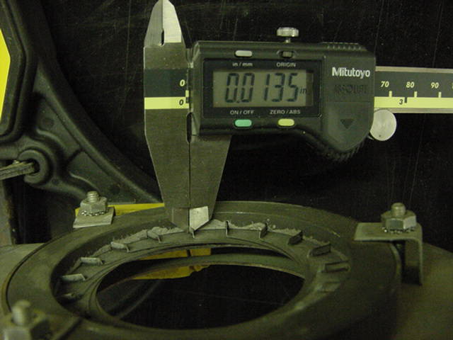

Michael, could you throw a mic on your parts again just for giggles and get a thickness of the leaves? and what is the total diameter of the rings?

That is the same problem I ran into with my plexiglas shade model. They can get away with being so thin in a lens as they basically support each other and are encased between glass so they can't get damaged.
The diameter of the rings is 2.085 and the leaf is approx. .002 thick (hard to tell for sure - at that size the Mic needle is thicker than the part so I used the edge of the needle).
