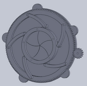

Scaled down + laser cut + servo
Such a cool project - thanks To Chris et. al. for making the files available to the community.
My version laser cut from 6mm birch plywood. Shellac to seal and protect then waxed. Stainless hardware.

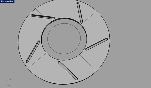

Iris human sized door....?
Hello talkshopbot! This is my first post in your forum. I just had to join when I read this thread. What great information and ideas you have here. Chris, I love your beautifully made door peep hole.
Anyone that is seriously interested and admires the iris would probably agree that we all just want to see it really .... Human sized. I want to make one as a door I can walk through. Ok, so before you start trying to tell me not to.... I think it will be possible. But I do thik I'll need some help from some of you experts in order to make it a really great well-working design.
Brad Kent on page 7 or 8 of this thread showed a design that I'm leaning toward using for two reasons. I think it will use up less extra space outside the door opening. And I like the gapless opening effect and the sliding, yet not overlapping, design of the 12 triangle parts.
Two things: I will make the triangle sections of the door anywhere from 1-2" thick because I will give them an insulated core. I'm thinking a square tube frame for the triangles and then sheet metal for the covering which would leave it hollow to fill it with insulation.
Now, on to the questions about it... I need to make the triangle pieces interlock in some kind of sliding tongue and groove way, so that when the door is shut, it is sealed. But the thing that is bothering me more is how this Brad Kent design (if I may call it that) would operate. There are two "pegs" on each triangle section that ride in the slots in the big ring. This is simple, the triangles slide back and forth in that groove. But what stops the triangles from just rotating with that ring? What kind of fixed ring/fixture/slot would be needed on the opposite side of the triangles to keep them in place but allow them to still slide? I know that there are many more things to worry about later in the design of this door, but we'll get to them if you guys want to jump in and help me along the way... I'll wait to see if this post wakes any of you up.... :)
