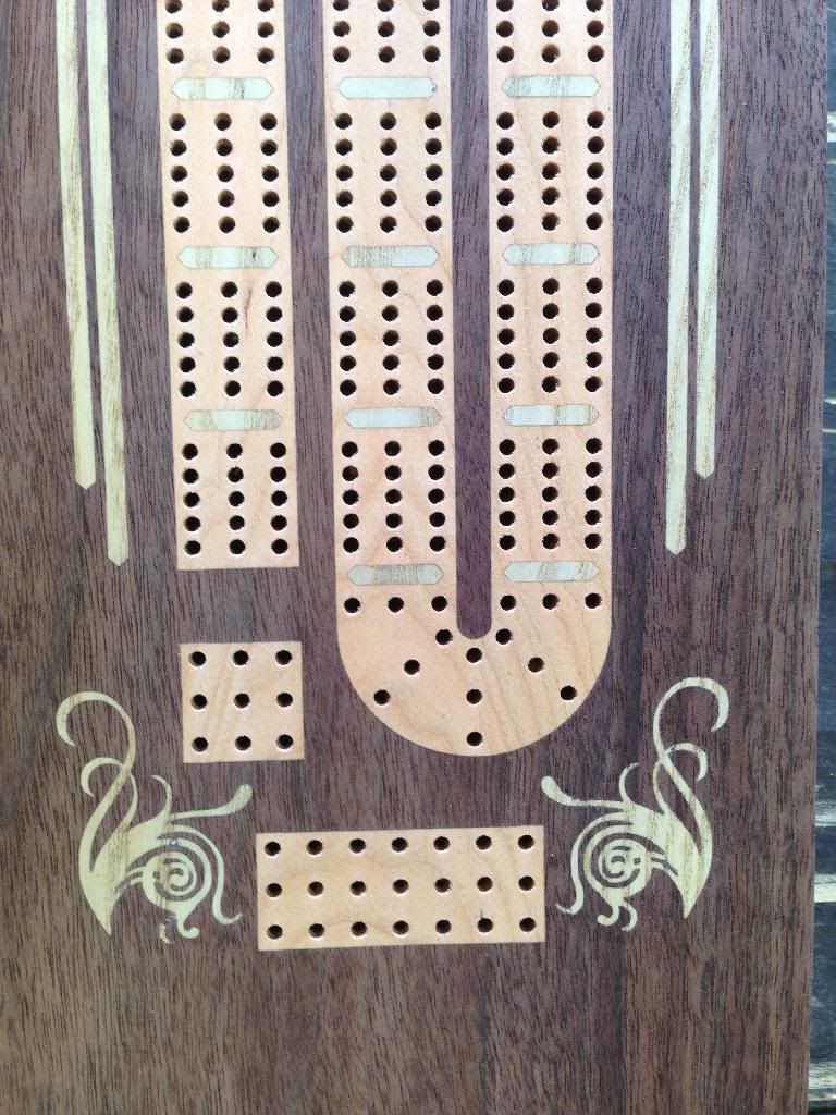

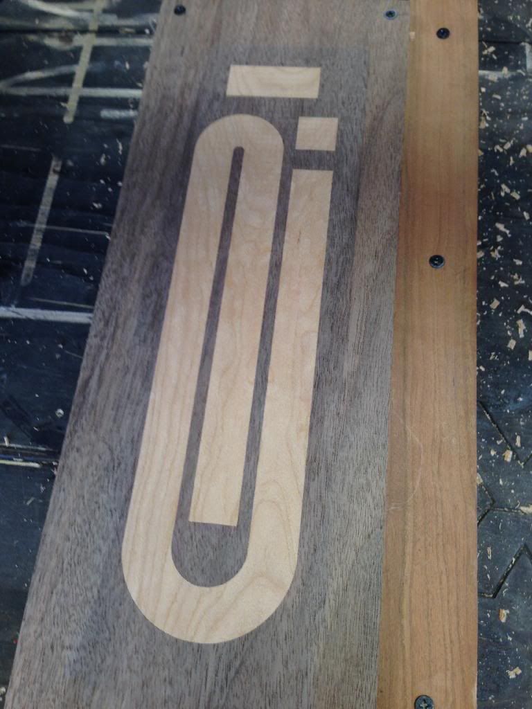

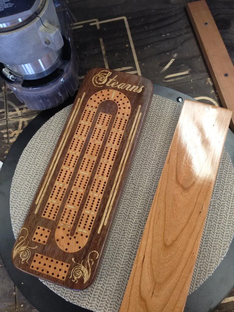

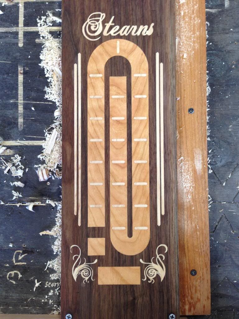

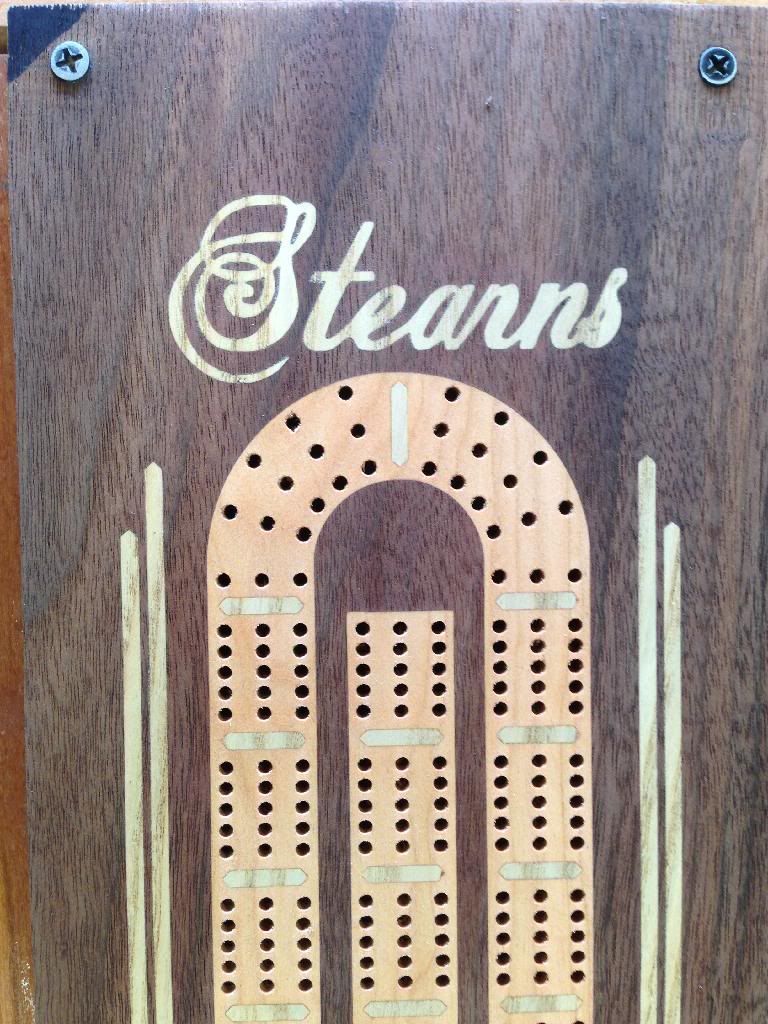

Here ya go, Scott.
I have an array of 4 of them on the Bot now, and they're driving me nuts. But they do that. The first one I made just about put me in a rubber room.
The back of these is fancy, too. There's a magnetic cover and a dug-out area for pins and stuff. I don't have any pics of that.
http://i925.photobucket.com/albums/a...psu8yv6gjv.jpg
http://i925.photobucket.com/albums/a...ps6lm9wgle.jpg
http://i925.photobucket.com/albums/a...pshq93yqsv.jpg
http://i925.photobucket.com/albums/a...psxv3gqtyh.jpg
Thanks Scott---So you did use this method? Nice work! I can see where doing it 3 times on the same piece could drive you crazy:)
How far down did you go in between VInlay's? Did you sand it all the way, or leave like .005" on each layer and then sand the whole thing at once? Just curious as zebra 1 is losing his tail from sanding zebra 2.
Oh, yeah. Sorry, I forgot you asked.
I found that handout a long time ago and printed it out. It hangs on the wall next to my shop desk on the same screw as "router bit basics". :)
I don't do any sanding between layers. I make a "surfacing file" that just covers the areas where I placed my inlays and I grind them down to about .05 above the surface. That's where I leave them, and I do the next series of inlays. They won't interfere cause they aren't high enough to get in the way. I do this because I only want to surface all the inlays and sand once, or stuff starts disappearing.
On the cribbage boards, I just barely surface the cherry. I tool it nice and close and clean, and do no sanding at all. I want the whole board to be exactly perfect and level depth with the table. So I don't remove it from the table or mess with it at all. Surface, done. Nice, sharp endmill, very small stepover, like 7%. Then I do the v-carving for all the rest of the male parts.
Then for the other levels I do like I said till I get them all done, and then I surface the whole piece until it's just taking up the glue and not touching the project. It takes some messing around. :)
When it's all done, I hit it with (maybe)80, 220, and then polish the heck out of it with 400. I have a couple Festool sanders and Festool HEPA vac, so I can get some serious sanding done in no time.
Before I sand I'll sit and pull glue out of grain with an xacto knife if there's any left at all.
If you look at the curlies on the bottom of that board, you'll see that the very fine, thin stuff is missing in a few spots.
That's the nicks from the male spots compounded by too much sanding. If I hadn't been totally sick of that project, I'd have dug out the missing spots with an xacto and used some wood filler. Then I'd have used a natural stain to make up any difference in color.
Last, but not least, I did the whole thing exactly as the tutorial said. I used .1, .2, and .3, just like in the tutorial. No deviation whatsoever.
The one thing that I've thought I'm going to try is what I picked up when I misunderstood you. I'm gonna shellac between v-carve layers on my male pieces, just to see if it helps hold the tiny stuff on the board. I think the increased surface tension will really help.
It'll add time, but it's very hard to get something like my curlies of your zebras to come out right.
If we had any smarts at all, we'd edit the files so there weren't those tiny, shallow pieces. Just make them thicker and work within the tolerance of the wood and tooling. But we ain't very bright, so I imagine we'll just keep struggling. lol :)
