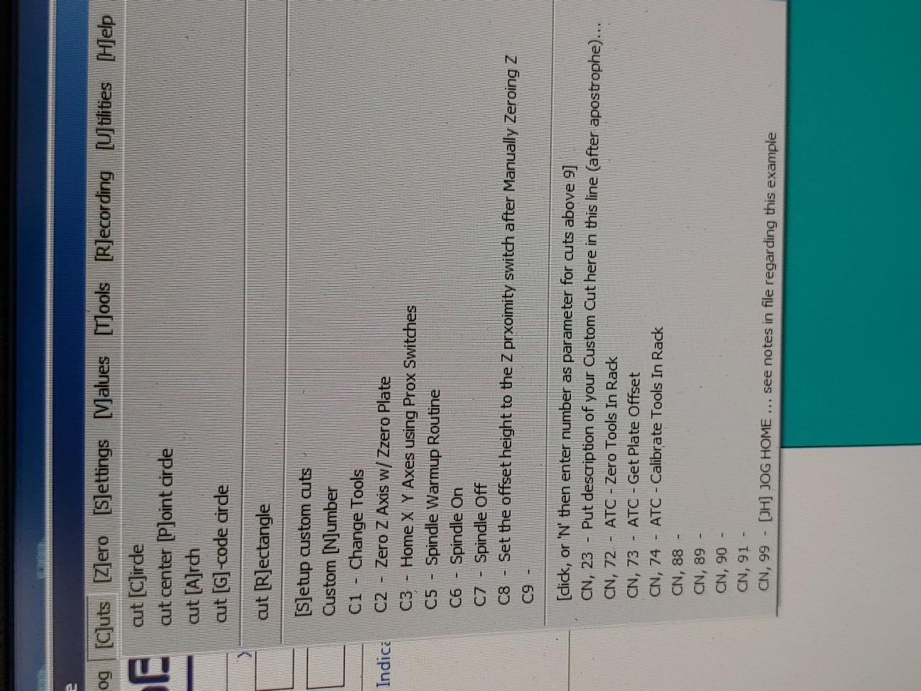

I am having difficulty location the definitions of all the codes used in the program, for example, "C9".
Is there a list anywhere that tells me what these different designations mean?
I searched for "G Codes" and all I got was designations that were "G-xx"
The software manuals on the shopbot reference page does not define these either.
The SB3 program is no help here, either.

C9 is used in the part file to call up the Custom9.sbc file, which decides what direction to hand off for tool changing. Either ATC or MTC. Since you don't have ATC, it sends execution on to the MTC.sbp file.
