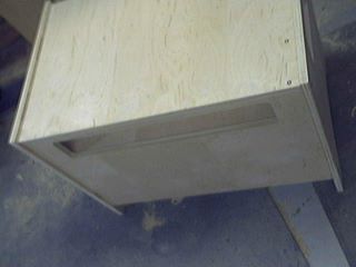

by holding Gary's old saw hostage, i got him to come back to the keys and help me with the vac box on his old machine,needless to say it is awsome.Being warm and sunny in s fla.we ran the vac motor box outside now the shop is so quite. Gary just what to say again a big thank you for all your help and knowlege:cool:
vacuum box

I just wanted to thank you for the picture of the new vacuum box you built and design. Also thank you for the help you gave me with it. I try making it out of the melamine like you. But I can’t work with that stuff. I made mine out of ¾” birch veneer. I got to tell you it works GREAT. The sound is way down. I think I will just keep it in the shop. The vacuum I can’t get over. I got my vacuum switch in today I can’t wait to install it.
Again Thank
Frank
Frank...
Glad its working out for you. I agree on the melamine.
One thing to look out for is relay switching current. Many of the digital switches only have 80ma switching current. Make sure yours is below that.

thank gary I will check in that. forgot to show you finish box[ATTACH]Attachment 11778[/ATTACH]
Frank...
That looks good! Thanks for posting.
I just made my two vac box. but i did it out of plywood as it was all I had. I did not use all of the baffles though I wish I had the room to do it. it is more noisy then the feins. they are about 80db and the box is 90db. but I also have twice the vac inches. I will need to hard hose it though the fein hoses want to collapse.
