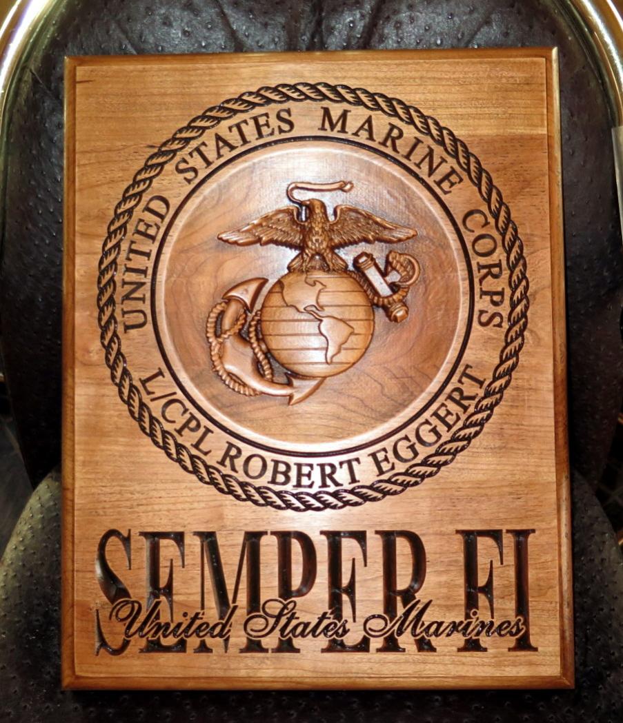

Kyle, good thread. like 80 and 120G bristle discs with a VS flexshaft , but dremel is ok.http://www.talkshopbot.com/forum/sho...radial+bristle
Oops, insufficient caffeine, But best advice I ever got for fuzzies from forum was to run finish pass twice(Cut full depth and you can go quite a bit faster because you're just skimming it). Helps a LOT but you've already got it off machine.:(
Another one going about to a viet nam era marine.http://www.talkshopbot.com/forum/att...id=26795&stc=1
The finish on that is absolutely fantastic........excellent work!
tanks, but i still have much to learn about finishing.
Another Excellent one Rick! :)
Stain on the letters and rope border? Or just end grain sucking it up?
Gel stain in the letters and rope. When i wipe the excess off i left a little too much on the top. So i sanded it with 400 grit until i liked the color and added one more seal coat. thanks.
