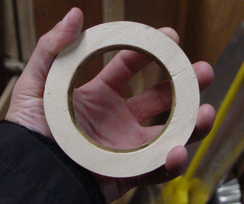

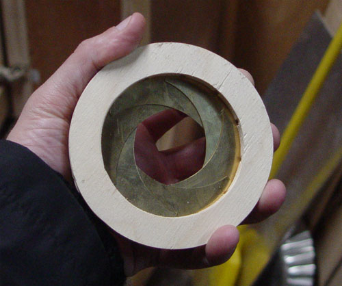

OK as famous as I am for starting something new before the last thing is finished...
I played around with Michael's drawings to make sure I wasn't missing a better design.
Here is a stab at a more traditional Camera IRIS.
Attachment 1076
Attachment 1077
Attachment 1078

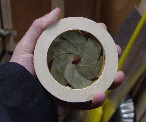

Clearly I underestimated the thinness needed for the metal leaves. I used a sheet of .020 brass I had to cut some 4" d. leaves.
I got 6 of 12 in place before it started to jam at the center leaving an approx. 3/8" hole when closed.
Michael, could you throw a mic on your parts again just for giggles and get a thickness of the leaves? and what is the total diameter of the rings?
Chris
Chris,
That is the same problem I ran into with my plexiglas shade model. They can get away with being so thin in a lens as they basically support each other and are encased between glass so they can't get damaged.
The diameter of the rings is 2.085 and the leaf is approx. .002 thick (hard to tell for sure - at that size the Mic needle is thicker than the part so I used the edge of the needle).
Mike
Aren't the shutter pieces on a real camera frosted?
Errrrr...Orange peel?
Or ......Not mirror finished?
I believe this is a technique to reduce drag.
Chris...your brass may need to be blasted or roughed up?
Chuck,
In actual fact, a shutter leaf is smooth and matte finish but that finish is more a matter of reflection than friction. In order for the 12 pieces of metal to overlap and close for as small a hole as possible (the smallest hole being largest Fstop number of that lens, resulting in a slower shutter speed and more detail), they just need to be as thin as they can be and still function. Any surface texture would just make them thicker. Friction/drag has nothing to do with it...
