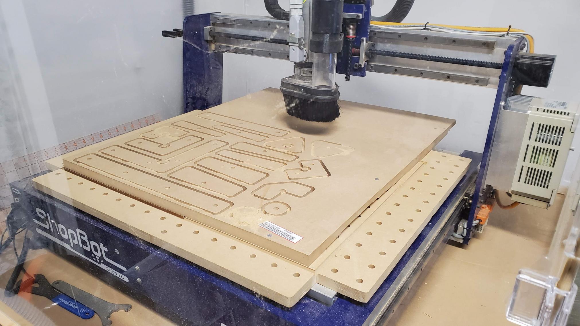

3 Attachment(s)
In March I glued another piece of 3/4" MDF to the raised cutting area(for the third time in 6 yrs), and I always mill it down to about .3" so the BB Ply fences have a decent grip.
This is my original Mark 1 cheapo MDF spoilboard I first posted, and never did saturate the entire thing on both sides with oil/naptha to firm MDF up :(
This time I got it down to .3" and then gave it a 50/50 oil/citrus thinner, as that big box store MDF is like cardboard in the middle!
It had just been skimmed the day before, and on a .005" skim, the 0,0 corner cut about .015"??????
Thought a bolt was loose even though I had checked them when I glued the layer of MDF down....tightened the down Firmly.
Skimmed it...and the darn 0,0 corner was STILL high???
Took the whole spoilboard off after inspecting it with a flashlight and a shim gauge.
All the bolt holes to the aluminum decking were deformed on the bottom!
I had used the "Standard Deck" file to cut the bolt pockets....Shopbot had those bolt pockets cut pretty deep to maximize how many skimmings you'd get out of 1 board.
And between me using the "flanged" inserts(held MDF about 1/16" high off decking), and then the bottom not being sealed, and the top over 6 yrs had been coated many times...
It just started separating the MDF:(
I was tempted to just toss it back on, and cut a brand new one out of HDO piece I saved just for that....but didn't want the corner to lift on HDO!
So eventually cut .3" Sugar Maple inserts to tight fit, then bedded the Maple inserts with 2 ton epoxy.
Chiselled off the deformed sections.....coated the WHOLE board with 3 coats oil/thinner...and a week later installed and registered the cutting area and fences.
Lesson learned.....with the raised cutting area and cheap MDF....those oval bolt recesses only need to be about 3/8" deep.
One of first projects will be to cut the HDO, and SEAL edges and holes!
Just thought I'd mention it.
The second and third ones I did were saturated with oil all over, and still going strong.
On HDO board, I'll use the non-flanged EZ inserts, and drive them down from top surface so they catch threads sooner..and then epoxy on the raised cutting area MDF.
6 yrs wasn't bad for this first prototype:)

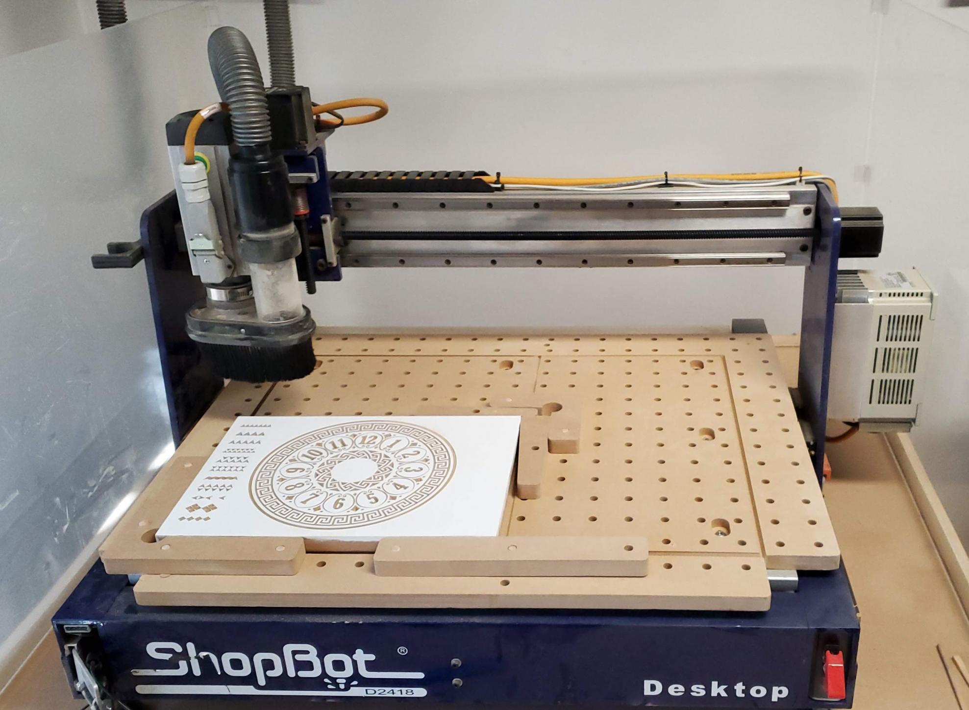

2 Attachment(s)
Finally!
As a new Shopbot owner I have lots to learn..
Thanks to Scott P. and his files my shopbot has a great holding jig set up - and it works well!
Big thanks and happy holidays
Vera
Attachment 34263 Attachment 34262
