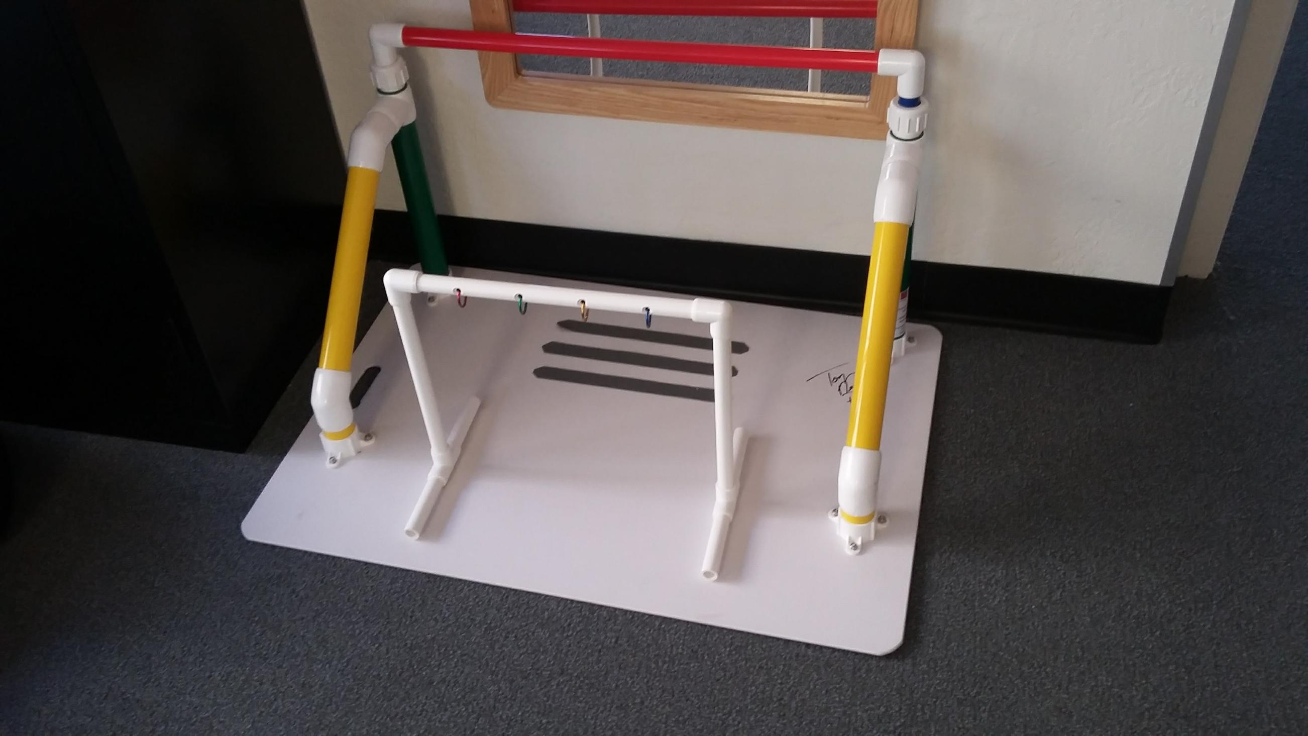

We have a couple AT devices we make out of furniture grade PVC and have used the chopsaw/PVC pipe cutters in the past, but it would be efficient to create a jig to hold the raw stock on the bot to drill, mark, and cut the pipe to length.
Has anyone made a jig to hold pvc on their bot?
We use 1/2" up to 2" pipe.
Image of devices:
Attachment 30108
Not to go against CNC or anything, but for the particular picture you posted this looks like a good job for simple miter bench and drill press stop jigs. I may be looking at it wrong, but It seems like it would take longer to set the job up on the Bot than to cut the pipes to length and drill holes.

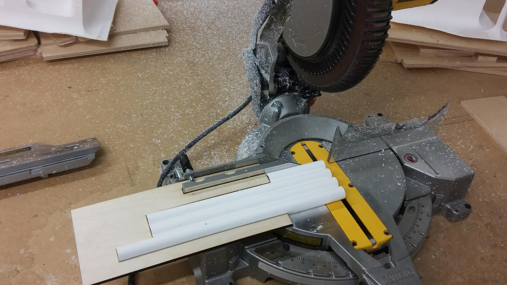

Here's what I ended up cutting out to use as a jig on the chop saw:
Attachment 30113
And in use:

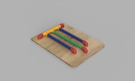

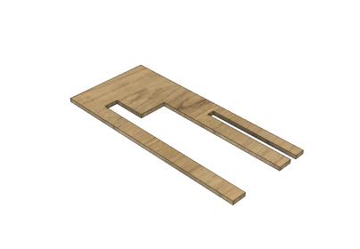

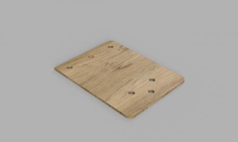

Here's what I thought I would use for the Bot Jig:
Attachment 30115Attachment 30116
