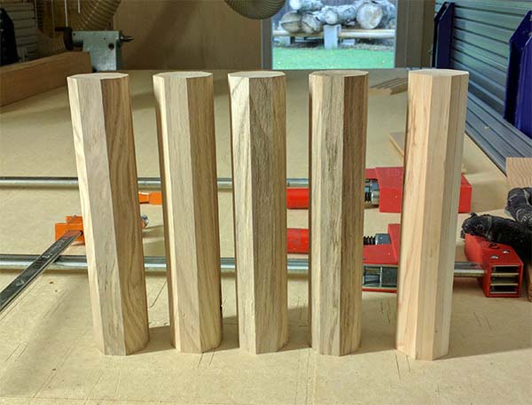

I made this speaker stand from wood I harvested on our property. The legs are about the smallest thing I've ever made but required as much work to make as full sized table legs. I used one board 11" wide and 1" thick for this project and have several tons of nice oak left.
Bits: 1/2" end mill, 1/4 ball" nose, bottom cleaning planar bit. Aspire 9.5
Blanks: 4 finish material, 1 from scrap as a test.

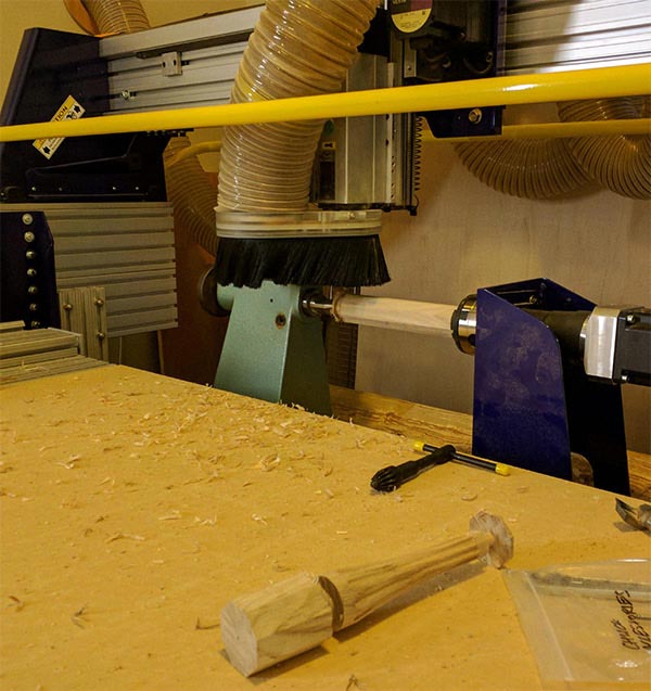

Being cut on the indexer

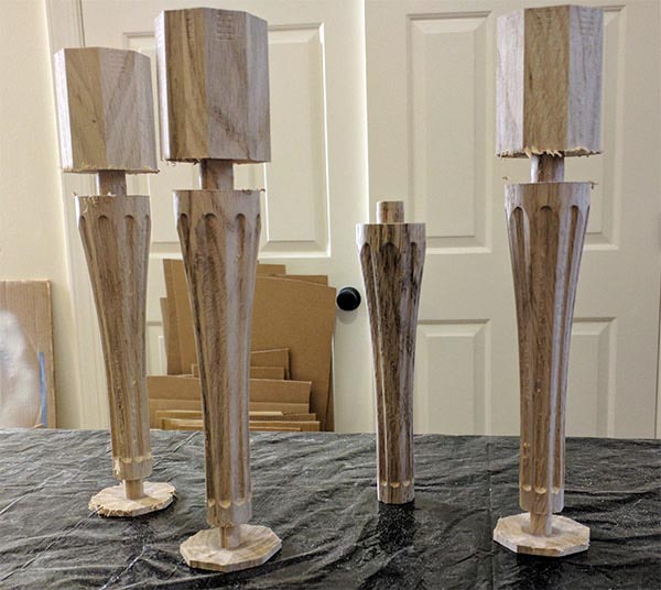

One leg sanded, three out of the indexer
Attachment 32043

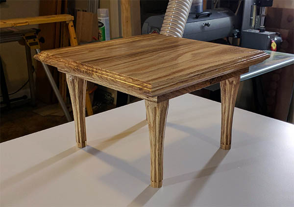

Finished table (6" tall, 12"x12" top)
Attachment 32042

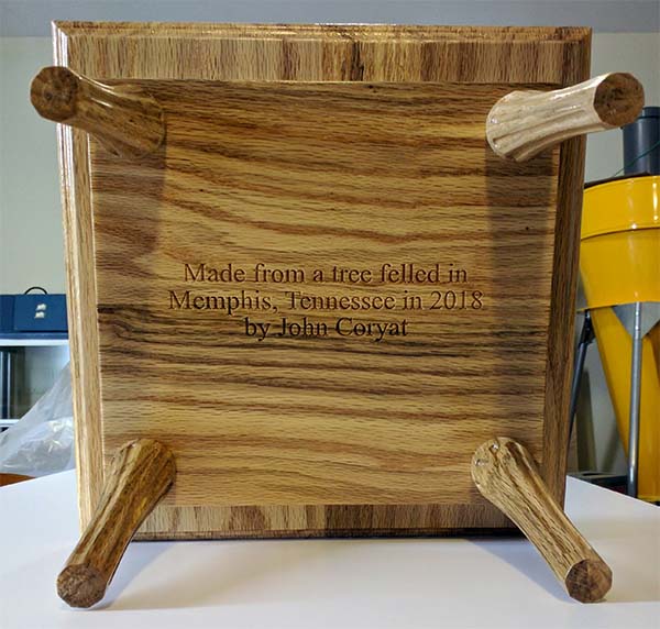

Underside
Attachment 32041
John, made an home-built indexer for my shopbot - am a true novice with the indexer, but excited about what it can do. Have a project to make a large candle holder for our church. My design includes tapered flutes as well as other designs - my challenge is understanding how to draw it - how did you design your tapered flutes? I am getting ready to upgrade from aspire 2.5 to 9.5 because of the indexer capabilities - any thoughts/suggestions would be appreciated. Thanks, Don
Upgrading to Aspire 9.5 will answer your questions about tapered flutes. I don't believe really old versions like you have would be capable of doing it. To create the flutes, I first used a bottom cleaning bit large enough to cover the width of the area I needed to taper, then used a fluting bit. The bottom cleaning bit running a fluting tool path is the key there. In Aspire 9.5 the preview is amazingly accurate. You'll know you're in the right ballpark once you see it emerge in the preview. Unfortunately, the preview isn't perfect and you'll have to experiment with the actual bits to get everything right. I use cheap 4x4's for experiments. They work great and are plentiful.
