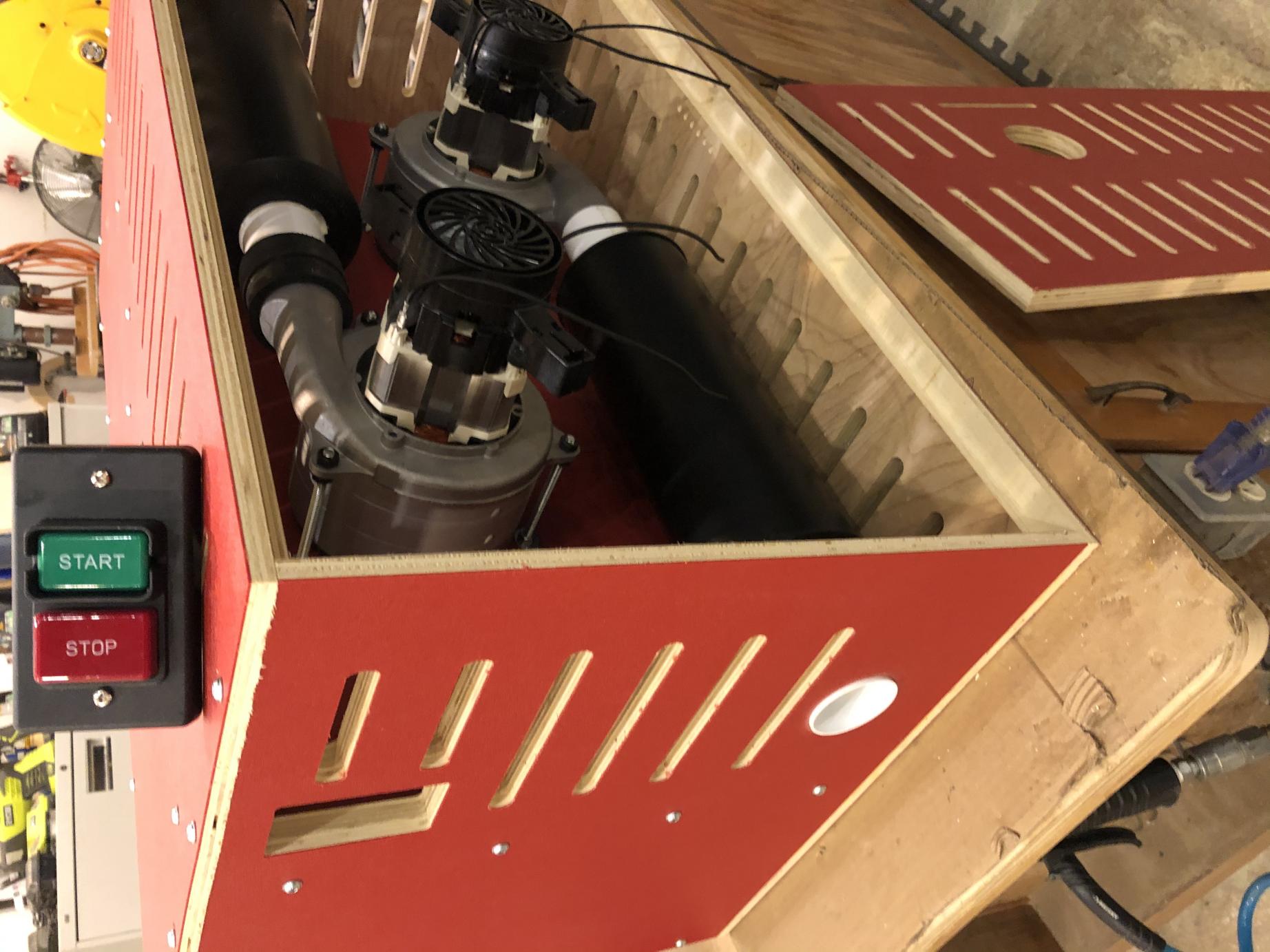

After spending months reading through hundreds of threads, I am going down the "rabbit hole." I am using many of the design attributes from the thread started on this forum years ago. I have worked with melamine for years...I hate the stuff. My choice of material is 3/4" PVC. My thoughts on this are: easy to machine, not porous, easy to seal the joints, sound dampening, heavy to help reduce noise and vibration.

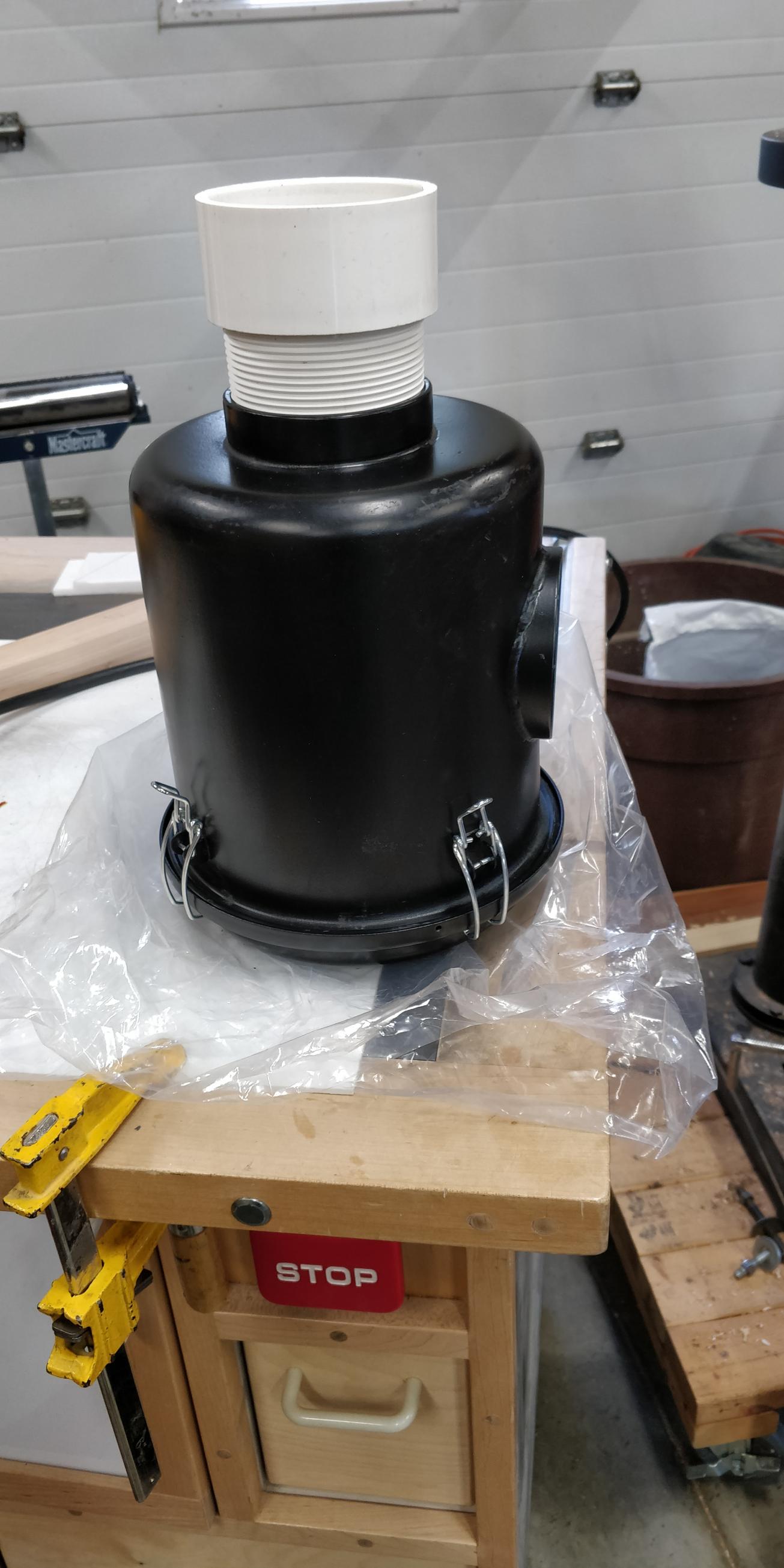

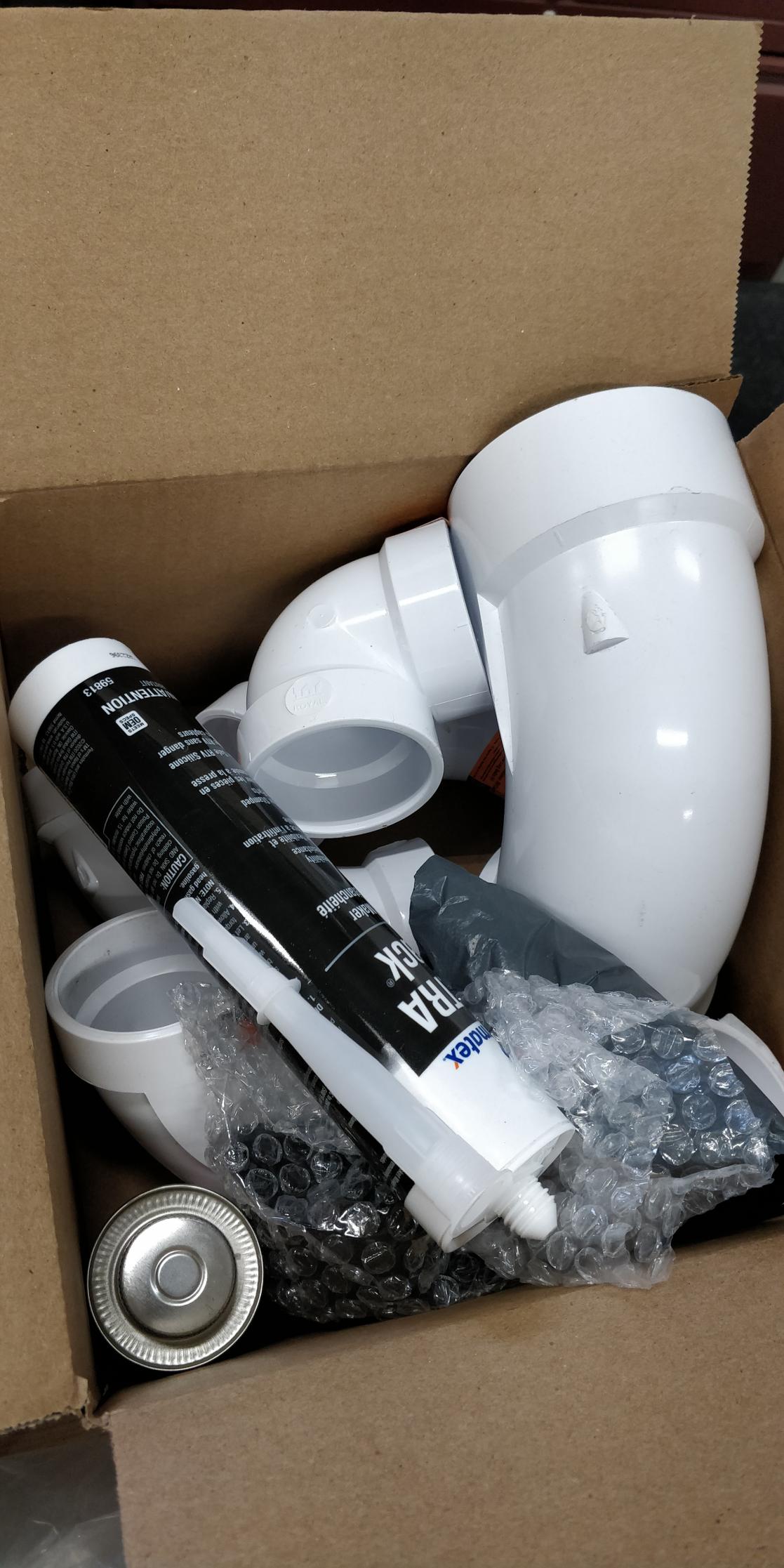

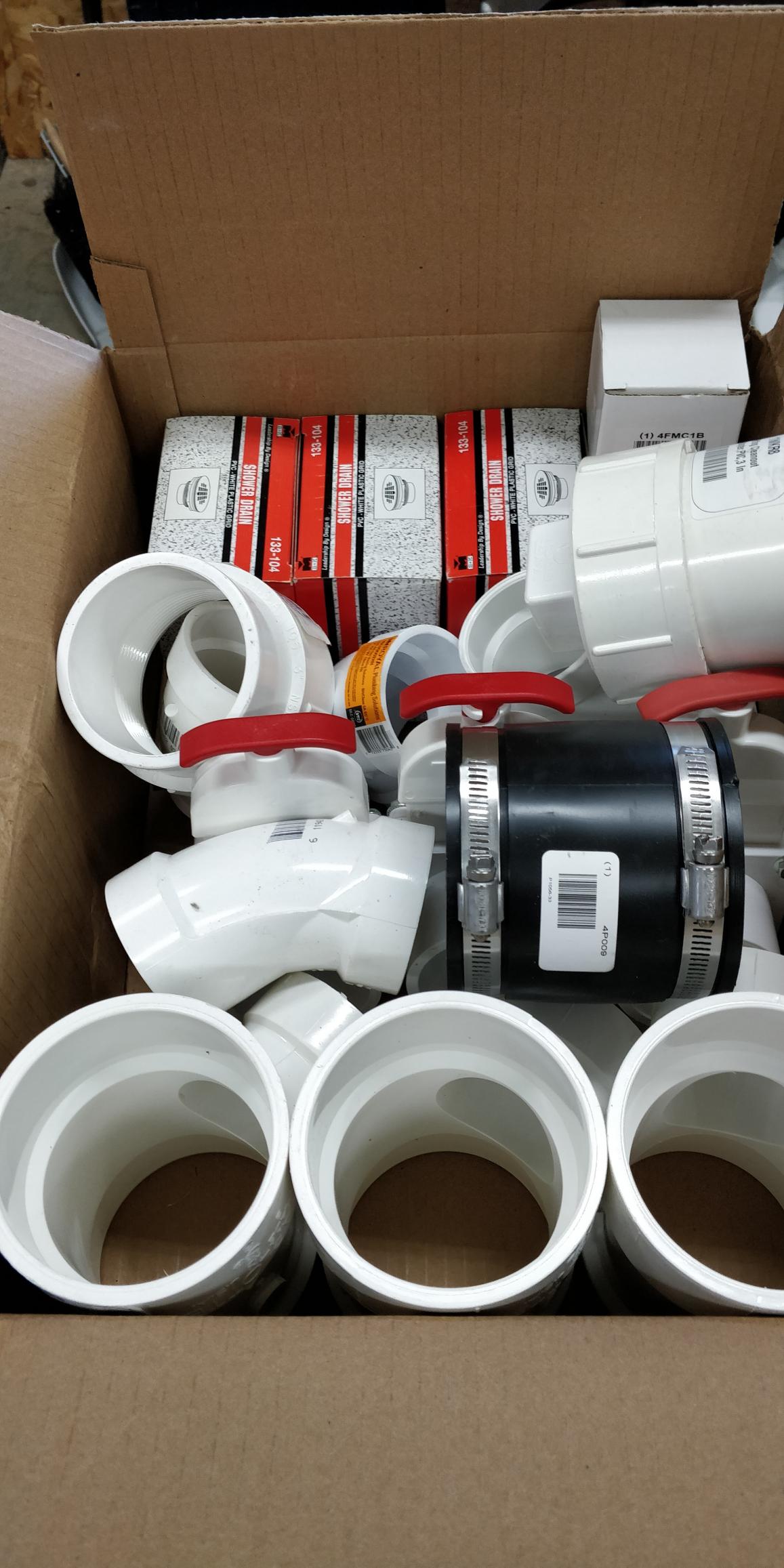

The vacuum table size I will be creating will be 48"x42". This works well for my material requirements. The plenum will be made from 1"PVC with a 1" Baltic birch substrate on the bottom to avoid an flexion. The piping will all be done with 2" PVC pipe and a 3" manifold from the vacuum box. For the motors I have decided to go with 2 Ametek Lamb 122178-18 motors for their specs in comparison with others that have been used.

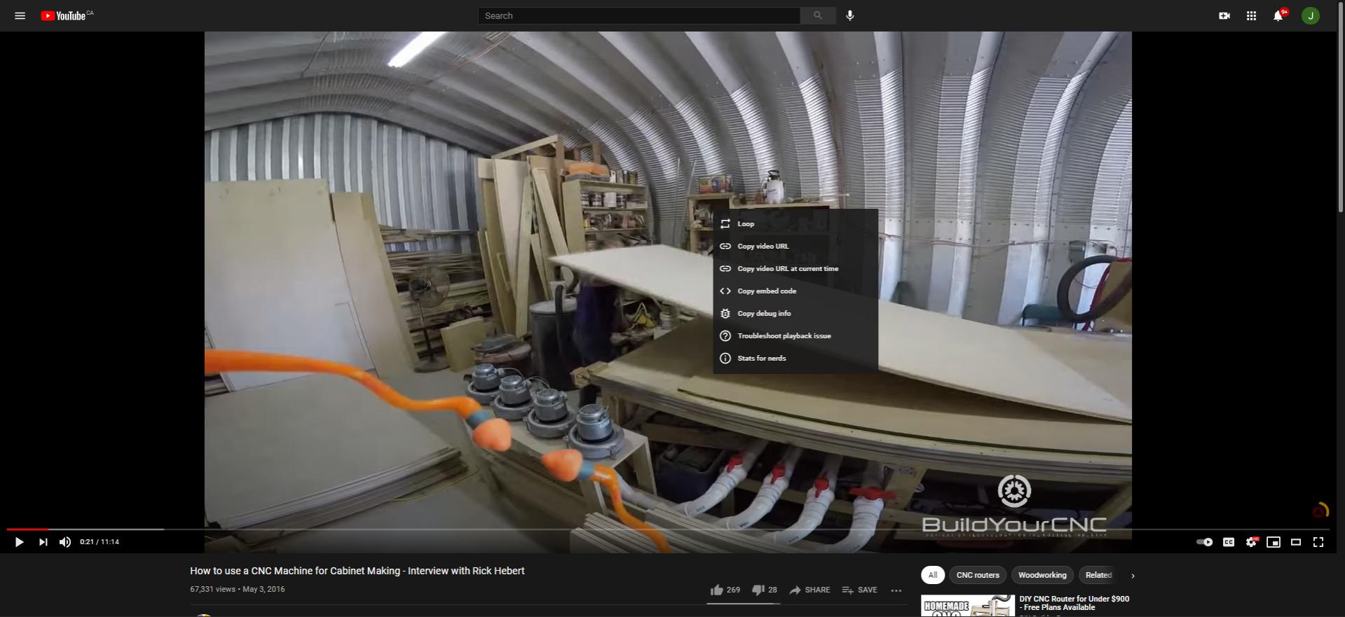

I am sure there are reasons why no one has ever posted pictures of the inside of the new vacuum box model made of steel, although they would be interesting to see.
