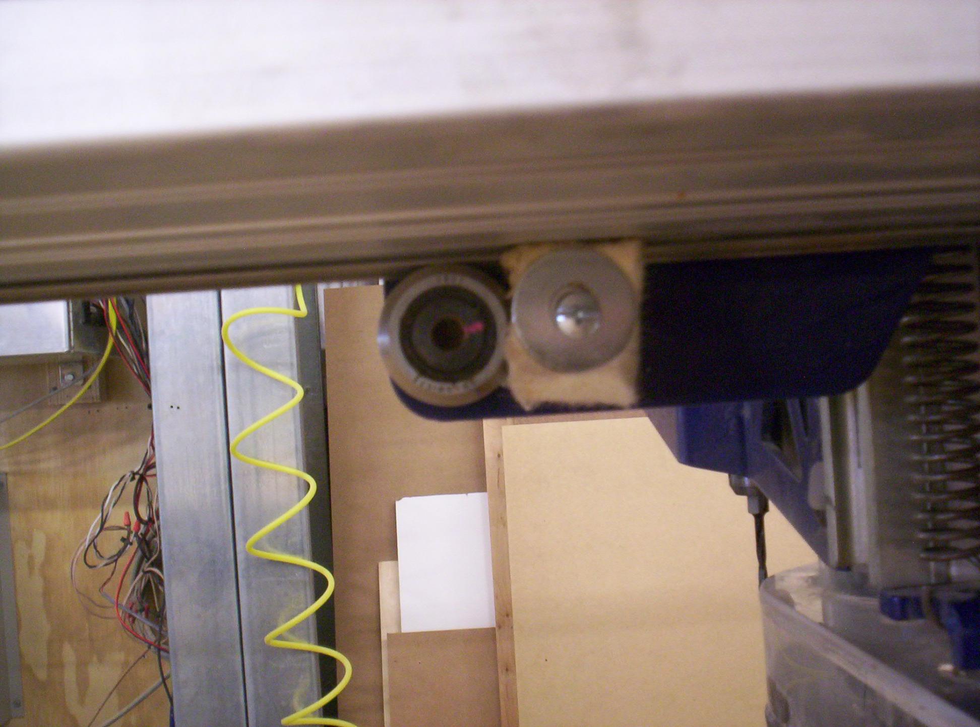

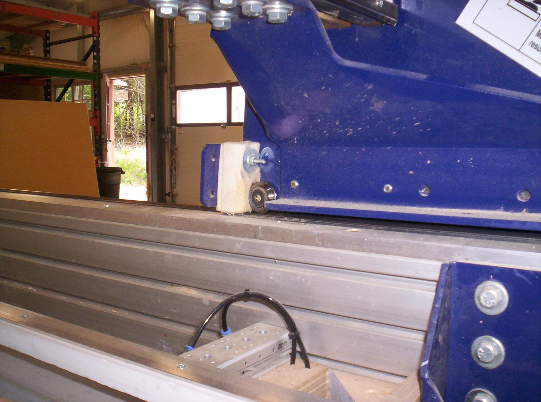

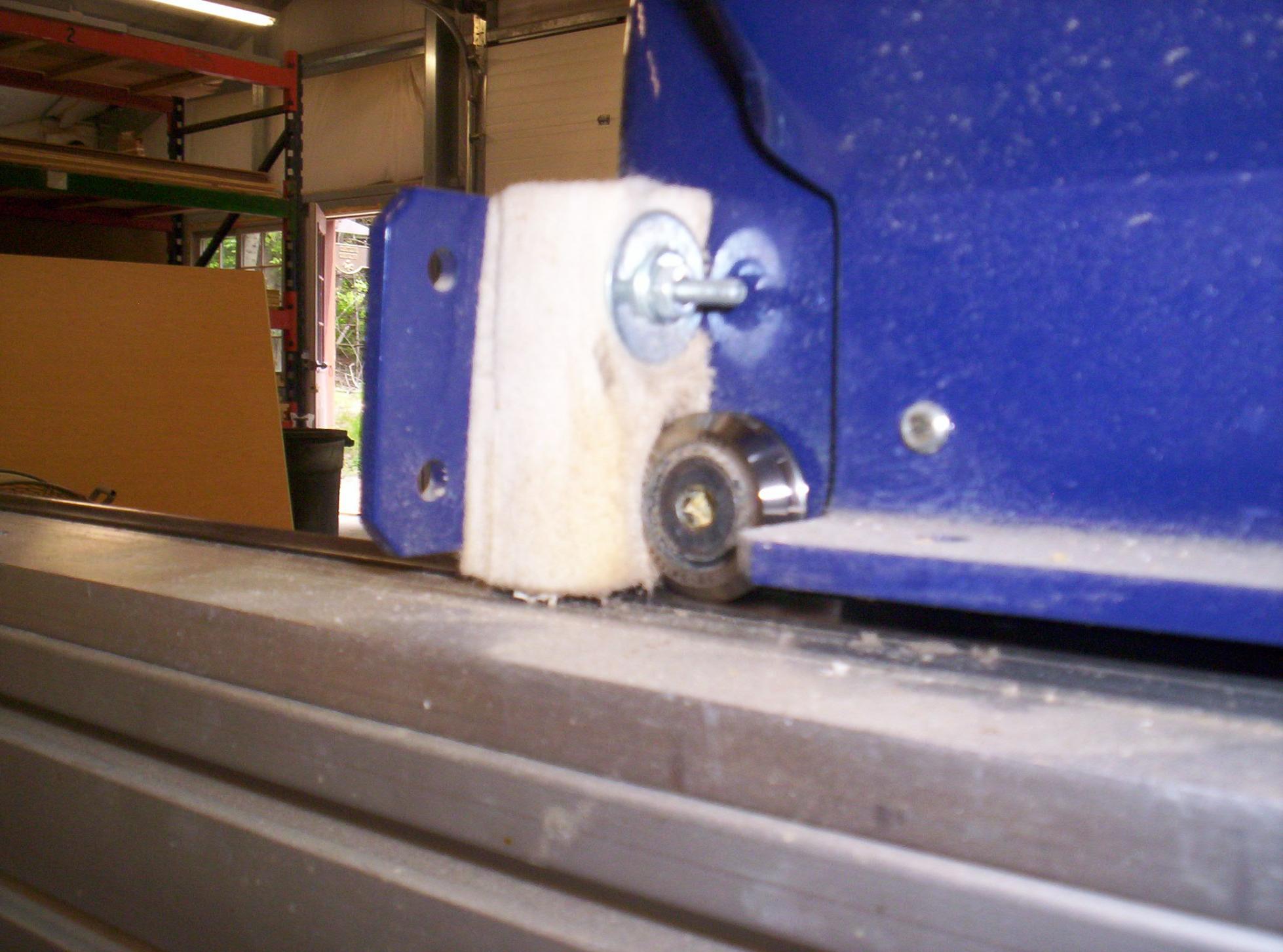

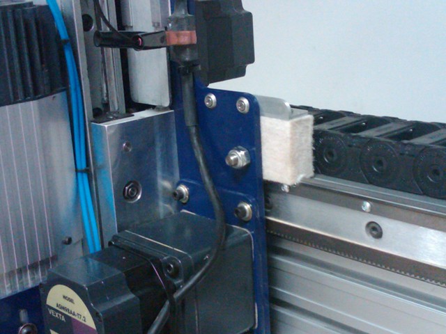

Here are a few pics of the latest version of the rail wipers. Aluminum & wicking felt blocks. Saturate with oil once a week.

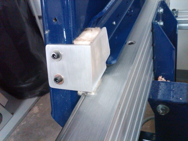

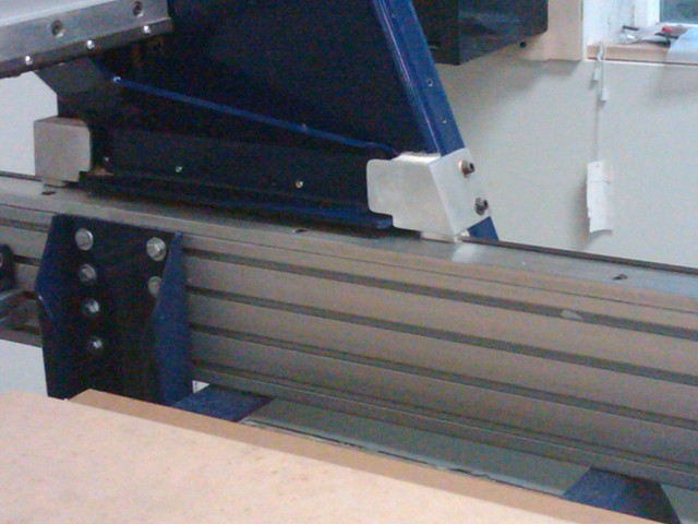

The version in the Table Leg post is version 1 on my 4 head machine. The newer version has the aluminum angle in reverse orientation and are on my ATC machine.
As far as selling them, I need to give that some thought. With the cost of the felt & aluminum and an hours time to cut, sand drill & tap, I thought most would build their own.

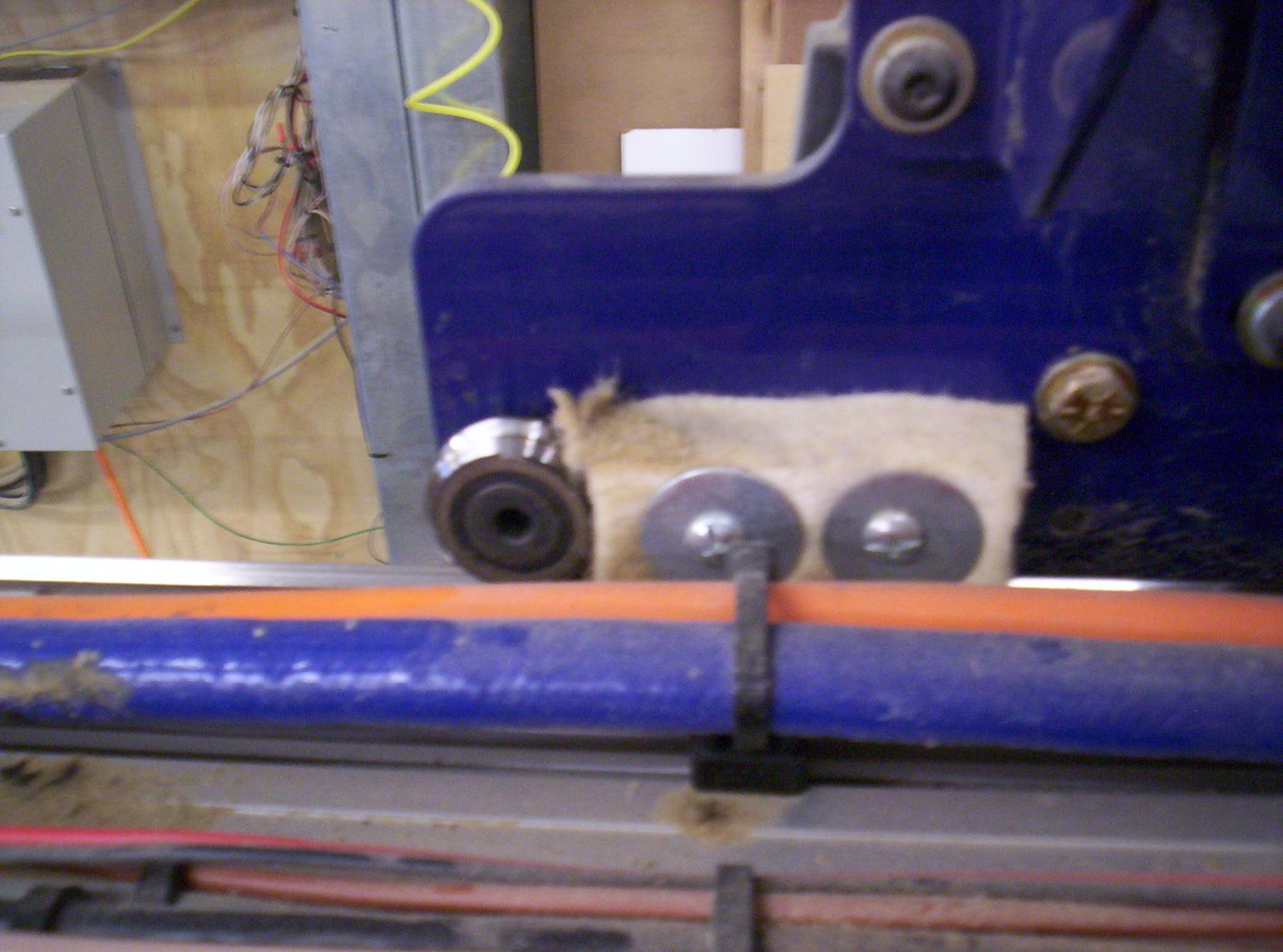

Based on Gary's idea (as with all the modifications I've done to my machine!) here are my 'poor man's' wipers. McMaster felt wedged in place and secured with bolts/fender washers. Periodic dab of white lithium grease on each pad. From what I remember I needed to drill holes in the machine for proper placement of each pad. Looks like the pad on my Y rail needs a trim...

What type of felt are you using? Or what is the part# for Mc master Carr
Thanks
alan...
I dont have the part number, but it is white wicking type felt.
this is the stuff I used fron Mc master carr #5051k94 if it help
On McMaster I see two different wicking type felts; what is best to use extra firm or soft?
John...
Caught me at the computer. Looked up my old order. McM part#
8344K97
Hope that helps.
Thanks Gary. I was thinking the "Extra Firm" might be a little tough to get to conform around the v-wheels.. Anything special about the oil you are using to soak these in?
John...
I soak them in compressor oil. For ease, I add WD-40 with a hand pump bottle or the compressor oil every couple of days. I use the WD when I take them out for cleaning.
