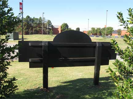

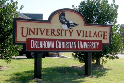

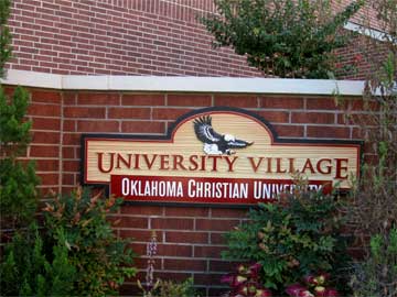

Here's a 10' sign panel Ron and I completed a couple of weeks ago. They we so impressed they placed an order for another one. But there's trouble! Last Friday I made a trip over to take some photo's and to my horror, the sign was warping! The sides had curled up a good two inches and the top was well on it's way for the same distortion. That spoiled my weekend.
Here's the problem. We installed this sign panel two weeks ago. It's made from 15lb Signfoam, which is extremely good, but I made the mistake of epoxying a sheet of DiBond to the back. That was down right stupid. The aluminum is expanding much quicker than the HDU. The result is a panel that's curving tword the front by three inches. I'm sure in a month it will be even worse
Here's my plan of correction. With the panel back in the shop I'll see if I can flatten her out and buzz off the aluminum back. Then I'll apply some 2"X6" cleates. What a mess.

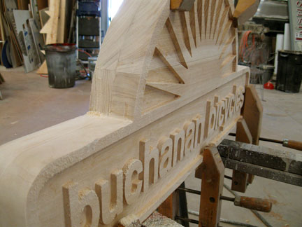

Here's also a little double sided hanging sign. I'm making it from Cypress. That wood sands better than any wood I've used and holds detail almost as well as HDU.

Cypress
Joe,
What is your source for the cypress ?? What sizes are typical ?
Thomas,
Would a mdf countertop with laminate/ warp if was mounted vertical rather than flat ?? How would you prevent that ?
Curtis,
I have several wholesalers to purchase from. My local favorite is Phoenix but most of them want you to purchase a volume. My last order was for 12 quarter, which I've stickered for a year. It's rough cut and cost $7.00 a bd foot. I think you can beat that price.
I've drifted away from Poplar and want to give it another try. Has anyone been routing this material?

Joe I,ve router poplar very nice wood I have some out side .With that said its classifed as a hardwood I'am not shure about exterior sign work
One of the easiest woods to work with in terms of holding detail
Your sign I have no clue why it twisted just a guess but I suspect rough lumber not dried has a mind of its own bad luck
Joe - I would not recommend poplar for exterior signs. It is one of the least rot resistant hardwoods. I used some 1X6 boards to dress up a post on my porch. Within about 5 years, I had to replace them because of rot. I had even primed all sides. After about 2 years, I had one poplar board that had started growing a mushroom, no joke.
