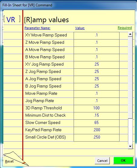

I machined about 20 3D reliefs over the past 2 days and I wanted to share my findings, because they are significant. I was running v3.8.14 on it, if for no other reason than it's been a cold Winter & I just didn't get around to updating it. I was having some issues when starting a file (it would pause too long/hang once in a while) so it was time to load up v3.8.26. I installed it and by mistake did a UR (was going for UI when brain fart happened) - setting my machine settings back to stock. I continued machining my reliefs - except instead of taking 17 minutes, they took 20 min each.
So, I opened up the VR settings and tweaked the defaults a little & re-ran the file. This resulted in a time of 16 min. So I went back and tweaked some more & got the time down to 12 min(!) - Absolutely no changes in the toolpath or move speed. Everything was untouched in the SBP. (4.625 x 2.5" part, 3D raster @ 10% SO, 1/16" ball, MS,2,1; 18k, cherry)
The first round I changed the 3D Ramp Threshold from 100 to 150, my usual custom 'tweak'. This alone knocked off 4 minutes or 20% of the overall time. The 2nd adjustment, I changed my Min Dist to Check from .15 to .08 (my usual default tweak number) AND the 3D Ramp Threshold from 150 to 200...this brought my ET down to just over 12 minutes, or a savings of 40% over the original ET! Yowsa! :cool:
So that meant that I was able to machine 5 parts per hour compared to only 3 parts per hour with the original VR settings. After a while I get sick of seeing the same thing being machined over and over again...so this was a real blessing! If you have no clue what I am talking about when I mention VR, go read this article.
I usually recommend that people only tweak the Slow Corner Speed setting from the default 65 to something in the 35-50 range, as this will change the characteristics of the tool enough to understand what is going on. You have to be careful fooling with some of the settings, as they will cause the tool to move in unexpected or undesirable ways. For the most part, you aren't going to hurt your tool...you can always click back to default settings at the bottom of the VR fill-in sheet.
3D Ramp Threshold adjusts the tool's sensitivity to ramping conditions. Higher values result in more aggressive cutting moves, with less cushion in all directions. If you are running a cat whisker diameter bit, you might want to leave this down around 100-150. You won't find any love above 400.
When I run files, I always use FE to look at it before I run it. I almost always tweak the MS to be what I want it to be & maybe program the tool to goto a location off the material when done. I will often open up the VR settings and adjust the Slow Corner Speed if I find that the tool is taking corners too fast or not fast enough. SCS works in the XZ & YZ planes as well...so keep that in mind.
