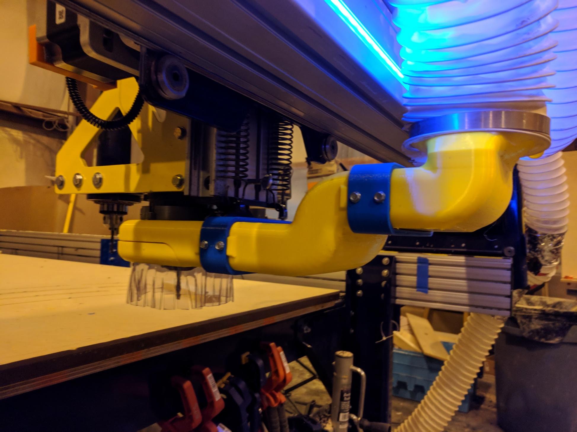

Here is is... yet another dust shoe design.
I have a PRS 96x48 and I had the Kent dust shoe which was great, but I added an air drill. As many of you have discovered you can't use the Kent shoe no matter which way you turn it if you add an air drill.
Aside from CNC machining, I do a lot of 3D printing and CAD design so I decided to make my own. The way the PRS is setup it's actually really hard to get a direct air hose near the spindle the way everything is packed in there.
The goals I had for this design is that it have a magnetic removable set of brushes for easy bit changes. I also wanted it to be as high as possible so I can still use clamps, and I also wanted to avoid the crushed hose. Here's the result:

what percentage area increase did you use when going from 4" round to square.
why did you use 2 90 degree bends instead of a 45 or minimal resistance gentle curve
nice job though
The cross section of the wide and flat areas have the same surface area as a 4" round circle. This was done to not restrict airflow as much as possible . The reason for the tight bends is to get the duct up and out of the way of the table (and any clamps) as soon as possible. Had I done a gradual angle I would have increased the area that I couldn't use clamps.
It performs great and I have no doubt that a slightly smoother curve would be a little better ... But I can't imagine it would be that much.
I could just print another duct.... :)

If at the first joint you made it angle up and make the round portion there would that work? That would make the part much shorter and faster to print. You might need to make it an inch or two longer to the first joint then maybe about a 30* angle with the round portion at that point. Just a thought. This suggestion is only if you wanted to make some for sale otherwise the one you made should serve you well as is.

Would 2 45's be better smoother transition
2 Attachment(s)
It's really smooth the way it is:
Attachment 30932
I don't think I'd gain much (if anything) by doing 45s. I wanted to get the pipes up and out of the way as soon as possible.

I built this dust shoe to try and get my dust collection working better. I always knew I had a weak dust collector. Well, long story short I ended up going from a 2.5 HP crappy old dust collector to this 5HP Oneida:
When I had this shoe on my old system it worked pretty well. On the new system which is hugely more powerful then my old setup, I was still getting sawdust left behind in my cuts. Less, but still far more than other similar systems that I've seen setup. I knew my dust shoe was the culprit...
I started to realize that with this new dust collector that my current 3D printed design was a bit restrictive. So I set about designing something that was a little more open. I was a bit hesitant at first.. We all know that the crevice tool on a vacuum works really well, and that was my theory with the old dust shoe. This new one I designed with a 6" x 6" suction area. Much larger than the old one.
Attachment 31500
Attachment 31501
Attachment 31502
I thought this was going to be too big, but it ended up working great. The bristles are flexible strip brush from McMaster. I embedded rare earth magnets so I can pull the bristles off. This allows full access for the wrenches during a bit change. I took great care to get the whole assembly as tight to the spindle as possible. Not easy when you have to exit the hose out of the rear because of an air drill.
The end result is that I don't know what sawdust is anymore. Between this monster dust collector and this new shoe, nothing gets left behind. It's pretty fantastic.
I did learn that a shoe can and probably should be tuned to the dust collector you've got. This new design may have been worse on my old system, but is great here. The shoe that worked great on my old system actually restricted my new one.
