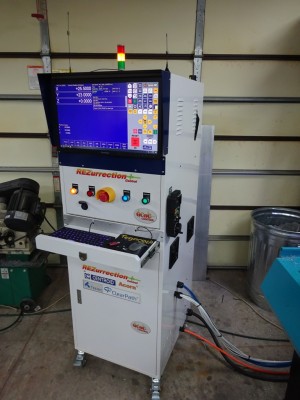

Here is one on my ATC-40 tool bridge mill
http://www.talkshopbot.com/forum/att...id=33896&stc=1
