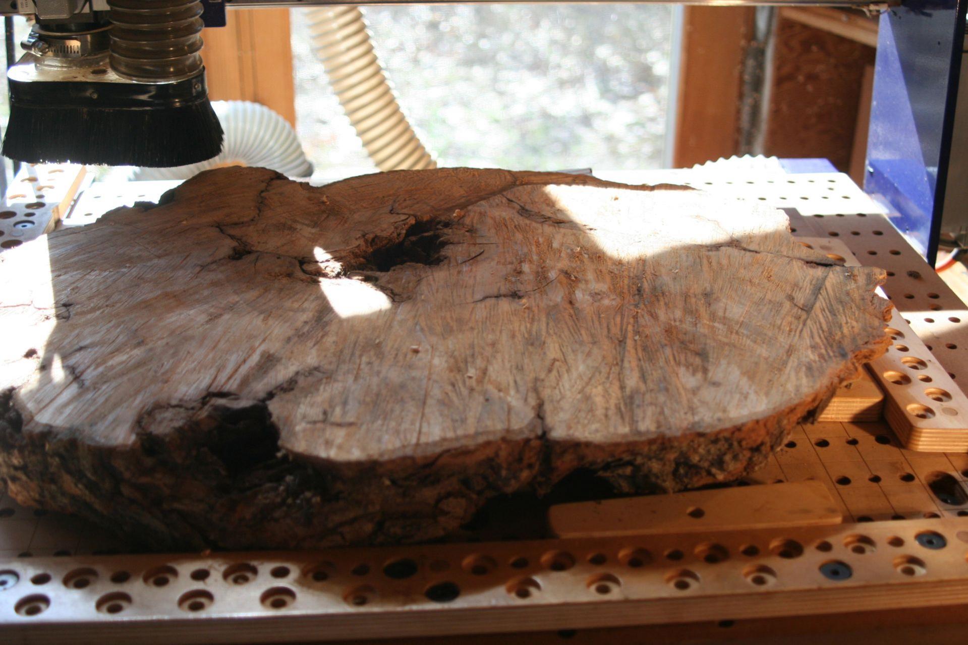

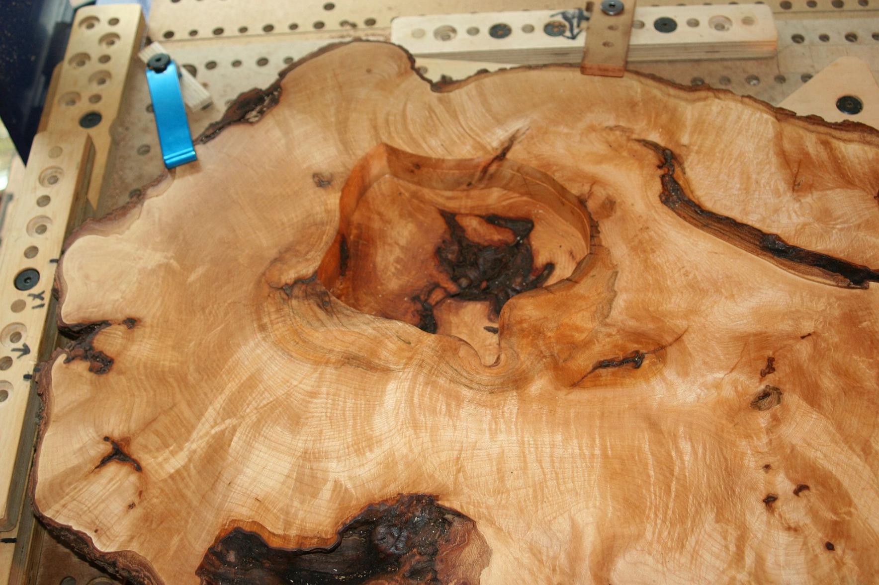

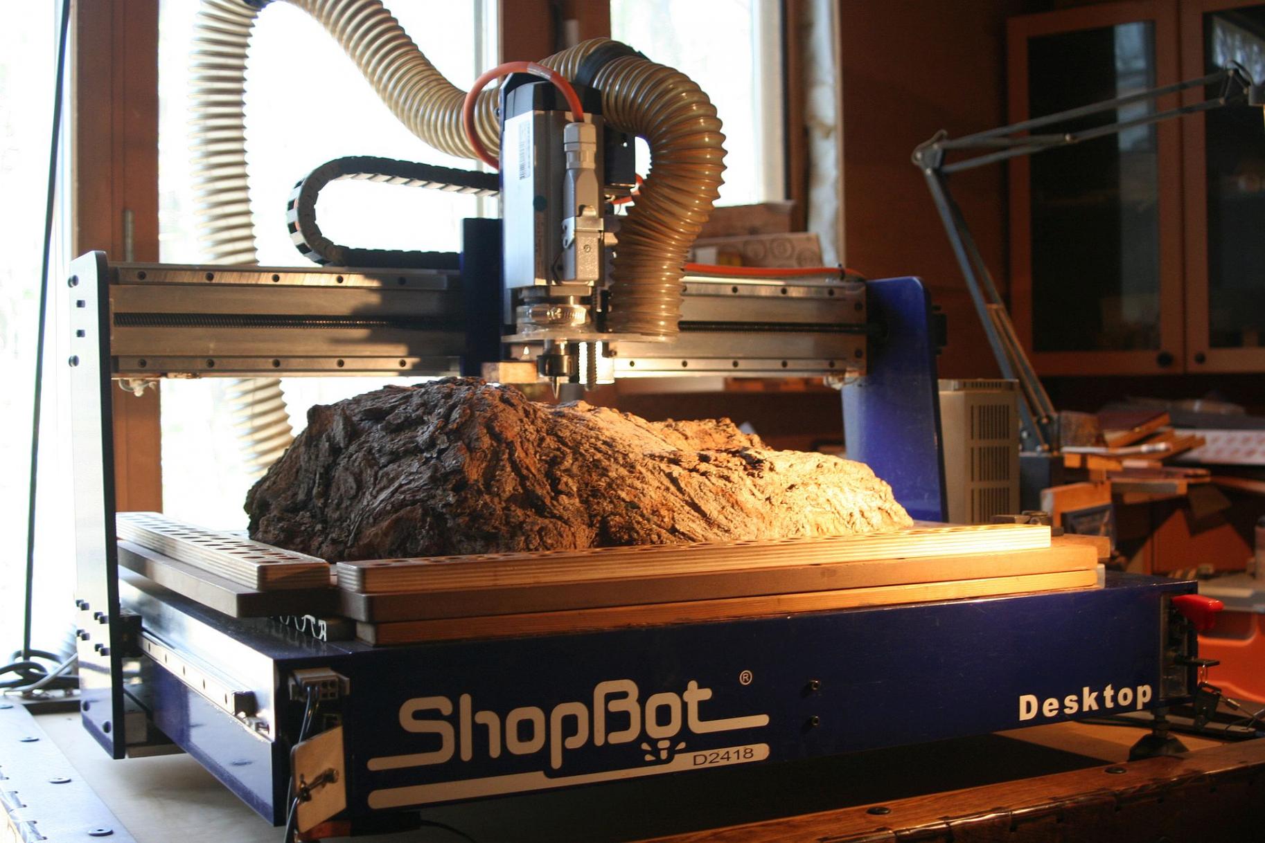

I cut a lot of "Firewood" and gifted or "Found" wood that needs to be prepped, and usually a 1.25" bit at 2.5-3.0 IPS at 40% stepover at pass depths around .1-.15" for Sugar Maple.
Never hear a drop in RPM like with a router....Plenty of torque in a wide range!
Just a few pics of a typical rough cut of a burl cut for my Dad.
(Oh....big pocket for Dad's ashes was .25" deep passes with a .5" bit)
You'll Love the accuracy and repeatability of the Desktop also, as we use the same gantry construction and spindle!!

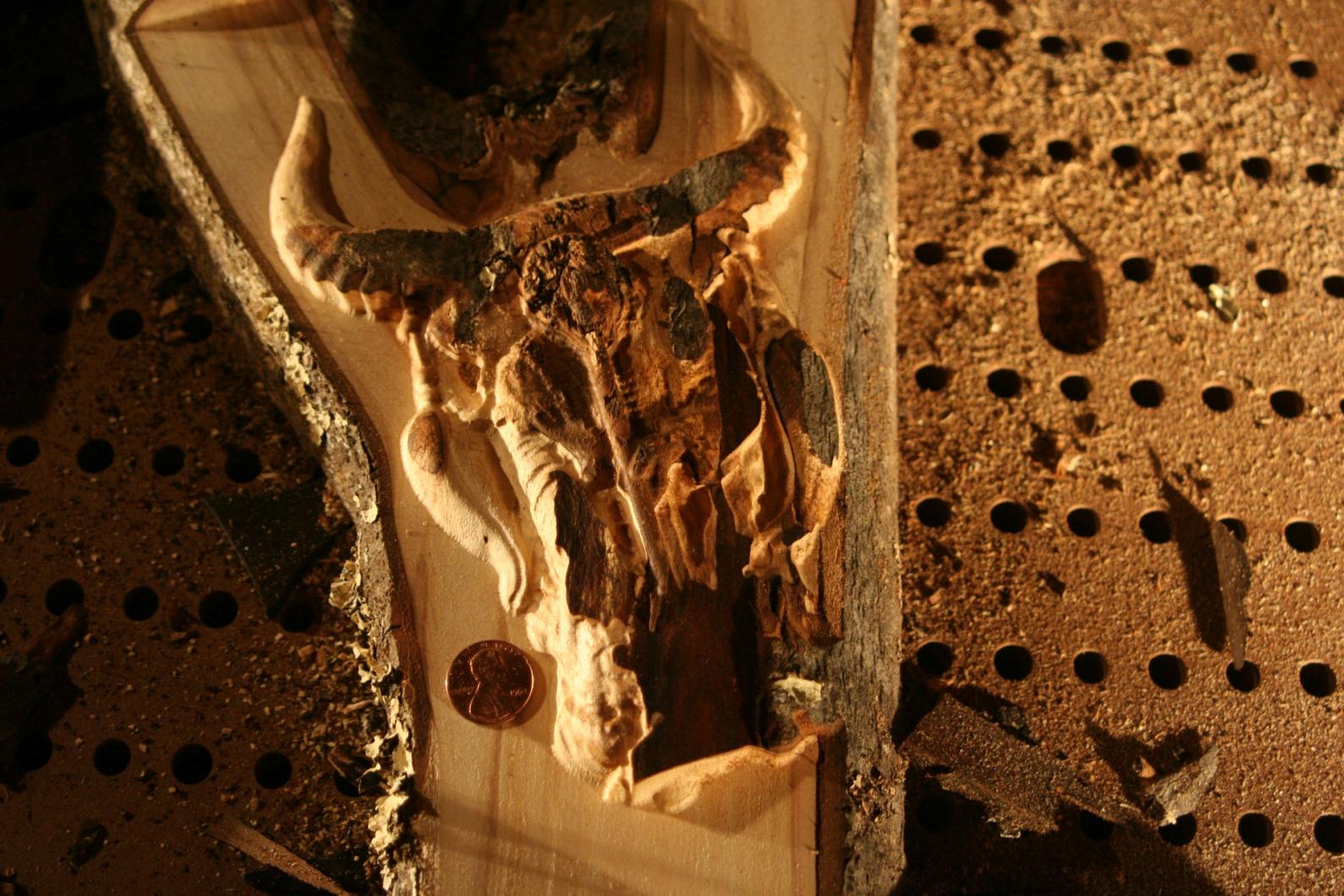

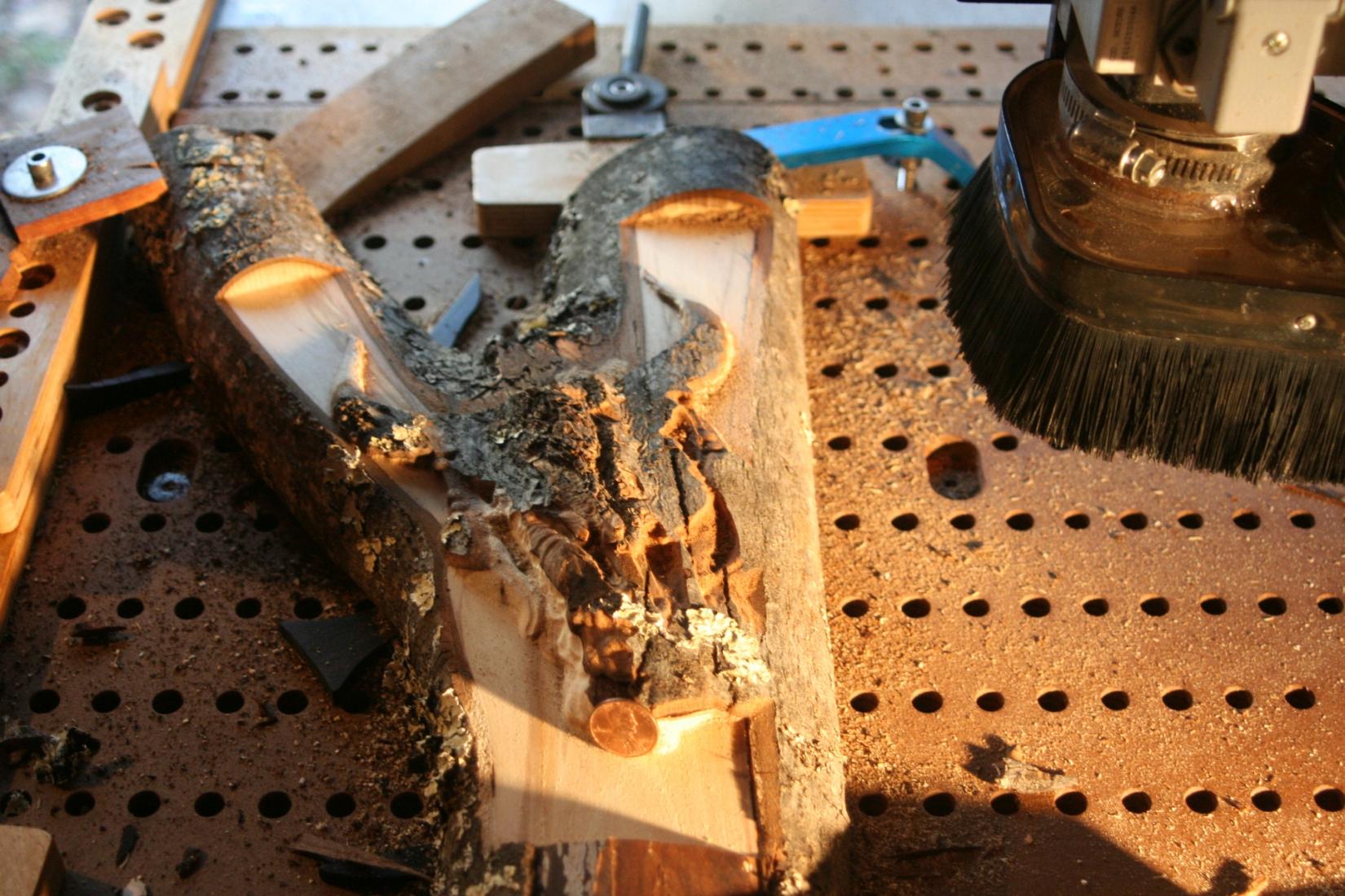

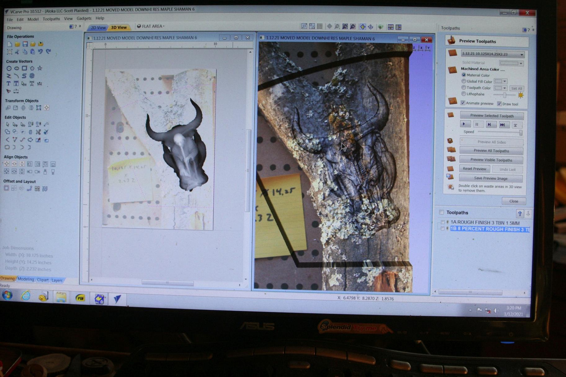

I did another project in Maple from a blow down and it used a 1.5mmTBN/ 1mm TBN/ .25mmTBN/ and then a 30 degree engraving bit(.005" flat) for just the fine details.
Because I was searching for the right layer of wood for the model, and then the small size of final bits....the wood was jigged for 4 days.
Repeatability was key to adding the fine details like the fringe on his jacket with the smallest bit!
Pics next.....
5 Attachment(s)
Here's the blow down Sugar Maple "Shaman" :)
Just a "Hobbyist" now....but for 2 years we had both machines running for 40-50 hours a week(small stuff like buttons and key fobs) and a friend in VA is running an identical Desktop 4 yrs now making RV signs 8-10 hrs a day...4.6 days a week with a 3 week backlog.
