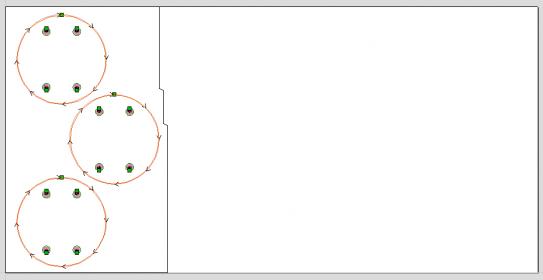

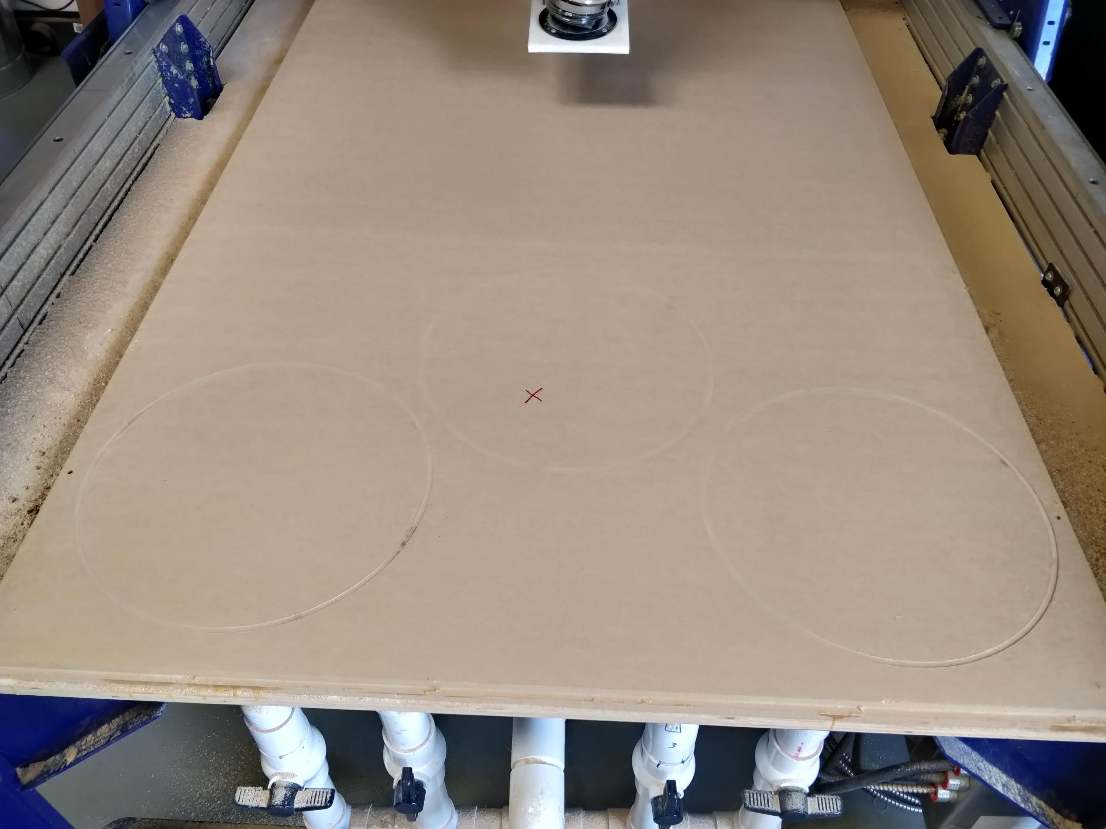

Today, I re-skimmed the spoilboard so it was fresh. I re-ran CN73. Then I ran a file that basically cut out 3 circles with some interior detail. I initially programmed it to cut 0.015" into the spoilboard, but it did not cut through. So I modified the program to cut into the spoilboard 0.035" into the spoilboard. In the two corners (see image) it cut into the table approximately 0.025", and in the middle, RIGHT WHERE I SET Z-ZERO (red x), it not only didn't cut into the spoilboard, but left material that I had to manually remove. This is right after a fresh skim and a fresh CN73.

So, I turn the vacuum system on when skimming, which I learned with my last vacuum table. Now, this seems preposterous to me, but I'll go ahead and say it.....
Is it remotely possible that the actual table for my machine, becomes concave once the vacuum is on? In that the center portion sinks down and the outer portions pull up? Making, in effect, a 96" x 48" bowl, which allows the edges to cut through but not the center?

If it is consistant about cutting on the edge and not in the center like your last picture, the spoilboard moving has to be the issue.

How stable is your plenum? I've heard of plenums flexing when the vacuum is on. As far as the spoilboard, as long as the plenum is stable and can't move, once you surface the spoilboard, it should be perfectly aligned with the CNC. Since 2009 I've not had a problem with my spoilboard moving. But being in GA, I suspect humidity could be a problem over time causing an MDF spoilboard to swell and shrink.

I am leaning towards a plenum problem. I just re-zeroed to the table and ran this pattern on the blank table with the vacuum on.
Attachment 34558
This was the result, both on a piece of 1/8" hardboard AND on the table itself. The odd part is that where it does not touch the table is exactly where I zeroed it.

My bet is that when you are flattening your table, the vacuum does not have as much downforce on the open table as it does when it is covered with masonite. So the middle section is sitting higher when it is being surfaced and then pulled down when nearly sealed with the top sheet. Do you have a gauge on the table side of your vacuum? I'm not sure if mine measures psi or inches of mercury, but my table only draws 2-3 when it is just the spoilboard, but I can get it upwards of 15 when I have it completely covered with material. Also sealing the edges of my table made a big difference
