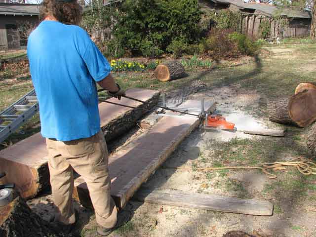

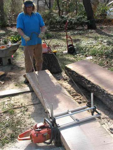

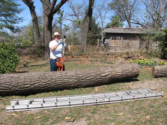

Here is a black walnut log I milled this last spring after the branches were all cleared and hauled off, and the trunk is shown ready for processing. I am using an Alaskan chain saw mill attachment. For what its worth, I'm the guy in the white shirt with the hat. The guy in the blue shirt is a friend of mine, we traded some work for this effort. (I got the better end of the deal I think!)
Attachment 7487

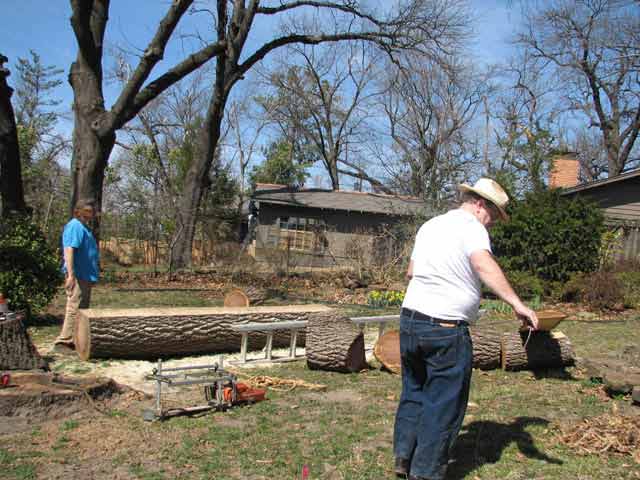

The first cut becomes the "edge" of the rough sawed wood. This is used later against the fence of the bandsaw during resawing to create staight(er) edges. Notice using an extension ladder to create a flat reference for the first two cuts. Later cuts will use the second (reference flat) cut to make the other cuts.
Attachment 7488

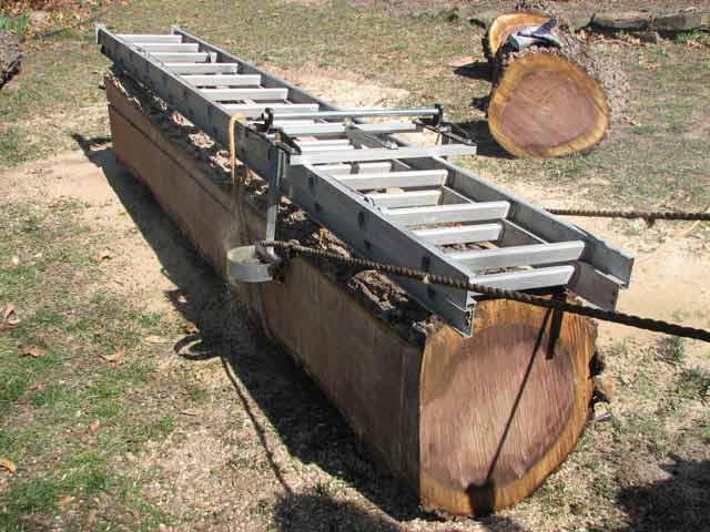

Now we have a flat spot, rotate the log 90 degrees and start making the slices. In this case I made my "reference" cut about 1/3 through the tree. Usually it is 1/2 way through the tree, ideally cutting along the pith.
Attachment 7489
The second cut becomes the first "flat" surface in the rough sawed wood. It is also the reference plane for making the 3rd, 4th and 5th cuts in the case of this log.
Attachment 7490

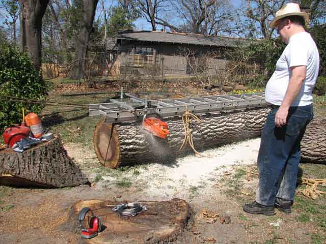

Here you can see the second cut in progress with the edge cut clearly shown.
Attachment 7491

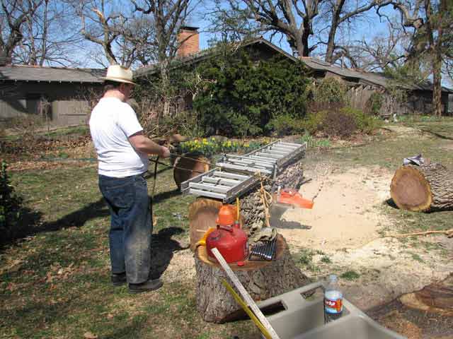

The third cut in progress referencing the second cut as a flat surface. Notice I have put a rope on the chainsaw so pulling it through the log can be done from a safe distance, in addition it makes it radically easier to do while standing up normally.
Attachment 7492
Another view of the 3rd cut.
Attachment 7493
This process repeats until my back is so sore that I can hardly move that evening! Also note, I made a little wooden clip that holds the trigger on the chain saw on so it will run at full speed while we stand back and let it cut. When it gets close to getting through the log I go back and run it by hand. Making one long cut can take 15 or 20 minutes. The chain is a "rip chain" which can be hard to find, but they are great for this kind of work.

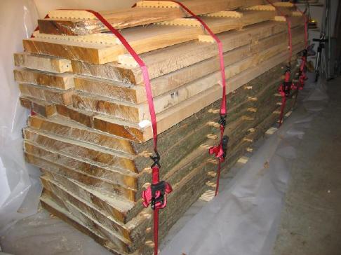

Note the wet wood is extremely heavy. With two of us on one end of each slab it was a struggle to load it onto a dolly for moving over to the trailer where it would be relocated to the barn where it will dry for a long time. There it will lose about half of its weight in 5 years. Much easier to handle then!
Also the "scabs" cut from the side are taken to a band saw and resawn immediately. I can recover a rough sawn board approximately 2x8 from each one, even though it is usually sapwood. Sometimes it has a very nice figure.

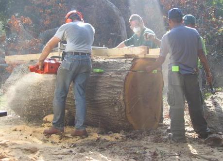

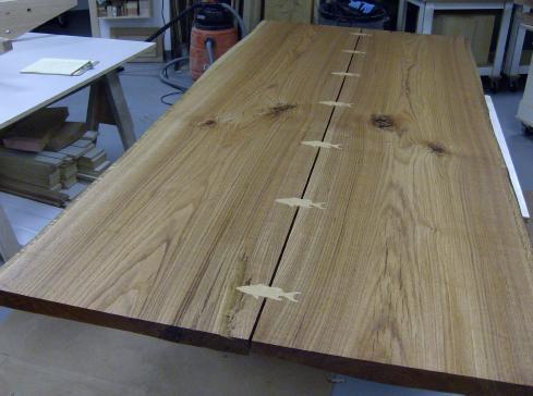

This black oak tree fell over a few years ago just up the street and was too big and perfect to pass up. It was a huge amount of work, and a large cash outlay. I hired a sawyer and two helpers, then built a kiln around the stack in my garage with a lot of helpful advice from John Ming. Two years later I had some nice slabs of wood to play with, I sold 4 large slabs for table tops and kept the rest for myself.
Attachment 7495
Bottom line is the wood is worth next to nothing until it's sawn and properly dried, and even then it's what you make out of it that makes it worth anything.
Attachment 7496
Mitch, my first attempt to mill a tree ended up creating warped firewood. Its like any other aspect of woodworking, it takes experience and requires learning from the experiences.
I had to learn the hard way that if you paint the end grain with a wax paint, it will split occasionally. If I didn't paint the end grain, the wood would split always. Now when the wood splits I just harvest what I can from what is left.
Mitch I encourage you to do it again, learn on smaller trees, no point in working on a 48" diameter log until you have done a stack of 10" ones. As you get good results move up to larger logs. The results can be very rewarding. Just as David points out its what we make from the final wood that determines the real value of the effort.

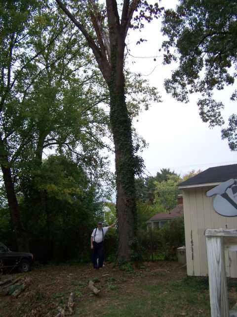

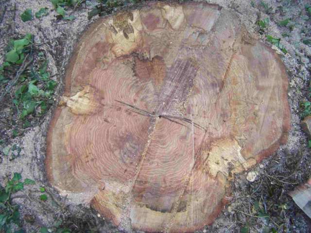

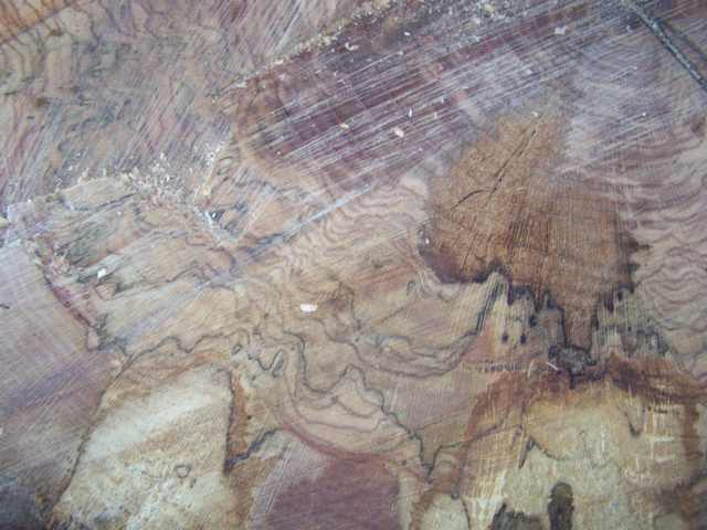

Here is a beautiful Red Oak I hated to cut down and we figured it to be over 100 years old. But look at the rings and some of the spalting usually associated with maple. You can see a couple places where it was stating to rot. All the leaves had fallen off weeks ago and several branches had broken off and the bark was shedding on the opposite face of the tree.
I'm lucky to have a friend who has a sawmill and a kiln so we just cut it down and hauled it over to him and i'll post pictures when it's cut.
What is a good thickness for a tabletop (1.75" planed down to 1.5")?
Attachment 7497
Attachment 7498
Attachment 7499
Jack- the figure in that stump is a good clue as to what you will find in the lumber. I expect you will make some beautiful things from it.. now the question will be how much of it will show up on this site as fancy new indexer turnings?
Keep us posted as you process the tree-
D
The main trunk was 39"x36" and was about 24 ft tall and all that will probably be cut at 1.5"+ for some tabletops.
The second level of trunk after the branches was 30" and 12' tall and some of the long branches that were in excess of 10"-12" will probably make some nice beefy legs for the tables. It's all sitting at the sawmill waiting to be cut and put into the kiln, and maybe by next spring it will be ready to be made into something beautiful.
What is the optimum thickness for a nice tabletop? My thought was to cut it at 1.5" and plane it down to 1.25" is this good or should i go thicker?
Jack, the best thickness depends on what you intend to put on the table.. for a standard dinner table 1/2 to 3/4 is more than adequate. If it were me, I would rough cut it at an appropriate thickness to plane and sand it to 3/4. That will be plenty sturdy to hold up any pot roast.. So to directly answer what I would do, I would go thinner unless you have a customer that wants a mega heavy table.
