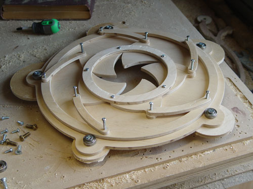

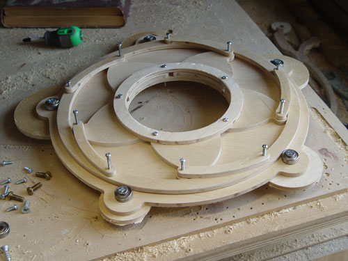

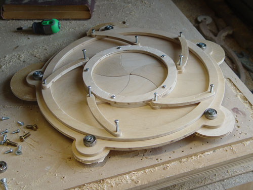

Just a prototype of a iris mechanism cut out of 1/4" birch on the bot.
The outer ring rotates to open and close the aperture.
Thinking I am going to make a peephole for my shop door.

Are all the components the same thickness?

No problem gents, I am posting the DXF.
WARNING---let me say this though.
on a completeness scale of 1-10 this is at most a 2-3. Definitely a prototype, It works but not well yet. This is the very first physical try of the concept.
So, just be warned the drawing at this point is really just to illustrate the idea. It needs tweaking to work.
I had to gang up the leaves and sand them slightly on my disc sander till they fit right. I still need to figure out allowances for friction and a few other finicky bits. I also need to add a chase in the substrate so the bolts have somewhere to turn, as you can see now the bolts are sticking up because there is nowhere to put a nut on. I also need to come up with some sort of retaining ring for the outer bearings, because right now it only works laying flat on the table.
Note: the tiny circles are not accurately dimensioned, they are just to indicate drilling points (drill holes for whatever bolts you use.
The drill points on the 5 outside tabs are based on some .75 bearings I happened to have. modify as you need.
I have a number of ideas on how to improve this now that I have proof of concept. And I will post as I work it through, as there seems to be some interest. I figure about 3-4 more tests and I might actually have something.
of course if any of you do something cool with this... please post and give details. together we can come up with something really tight.

on a serious note.. I drew up your dxf in solidworks.. and I am really impressed with what you have there.. but I can see how you would have problems as the tolerances are so close.. it is a great job to get it to the point you are..

I don't know if it would improve your design, but you could include half-lap joints on the ends of your linkages. That would cutout one layer of thickness in your final assembly.
I think gears are the way to go

You can eliminate the linkage and half the pivots, as well as increase mechanical advantage, by using slots in the outer ring. You can also eliminate the bearings by using the inner ring as a pivot.
Attachment 1070
ohh now there's an idea. If I am thinking correctly, the slots would need to be curved as the pivots on the end of the leaves travel in a arc, but that shouldn't be too hard to calculate.
definately going to play around with that.

Chris, the slots do not have to be curved. They do not even have to be angled. The angle just provides a "wedge" to increase mechanical advantage in both directions.
ahh ok, I think I get it. I guess I was still thinking in terms of a fixed pivot with the substrate being stationary, but you are talking about the whole slotted disc rotating?
interesting. I'll have to rethink the structure that holds the inner ring stationary.
...or, mabye even more interesting let the inner ring move and have the iris rotate as it open and closes.
If you were just concerned about manufacturing costs and material usage a slotted outer ring design would probably win. I have to say that I'm drawn to the linkages from an aesthetic/moving sculpture point of view point. Either way, I especially like all of the interacting curves in your design.
If you go with the slotted outer ring idea, you could use arced slots instead of straight slots. I've seen this technique used in other applications, but I can't remember why it was used. Maybe the arcs are intended to maintain a constant mechanical advantage throughout the movement?

I'm with Russ on both counts. I think I will work with the linkages and put a sheet of clear plexi on top. I want people to see it!
I dug through my camera parts drawer and found the lens I used for my window shade design. The advantage to having the parts slide over each other is that the out ring does not have to be so much bigger than the smaller ring. The bottom piece has 12 equally spaced holes:

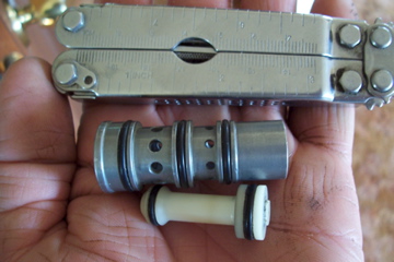

This little doodad below is an air valving part of a hydraulic intensifier .
If you put 100 PSI air in, you get 1200 PSI hydraulics out.
The Doodad makes the machine automatically reciprocate with a brilliantly simple theme of pressure and area.
