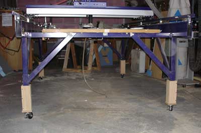

Not knowing any better, we bought our PRT used about three hours away.
We centered the spindle, then centered the gantry. Attached 4 rubber "hook" straps gantry to the table and then used about half a roll of the "shrink" wrap around the spindle to the gantry and then both sides of the gantry to the table.
They had a hoist and we set it onto a car trailer and tied it down good with some heavy duty tie down straps and off we went.
6 guys and two 2x4 on edge lifted it off the trailer and into the garage.
Worked pretty well, but I'm not sure that it would be the recommended method...
Les
Recently moved a PRT96 about 30 miles. This is what I did:
Dropped the X motors and lifted the X gantry off the rails about an inch by clamping plywood to the X support channels.
Tied the Y and Z in place with big wire ties.
Rented a 12-foot tilt trailer and bought four 4 wheel carts.
On the loading end we had a forklift so we forked the bot onto the carts on the trailer (2 carts on each end).
Screwed 2x4’s to the carts on both sides of the cross supports and chained the bot to the trailer with chains and binders that came with the trailer rental.
On the unloading end there was only two of us. With the tilt trailer we were able to roll the bot off the trailer. I didn’t think it went to bad but I was on the front end of the trailer. The guy in the back looked like a deer in the headlights when the trailer tilted, un-tilted, and tilted again. Not to mention it went quite quick.
To get the bot back off the carts we used a floor jack and 2X4’s clamped to the middle of the X support channel.
Hope that made sense.
The bot needed no major squaring or adjustments other than re-surfacing the spoil board.
