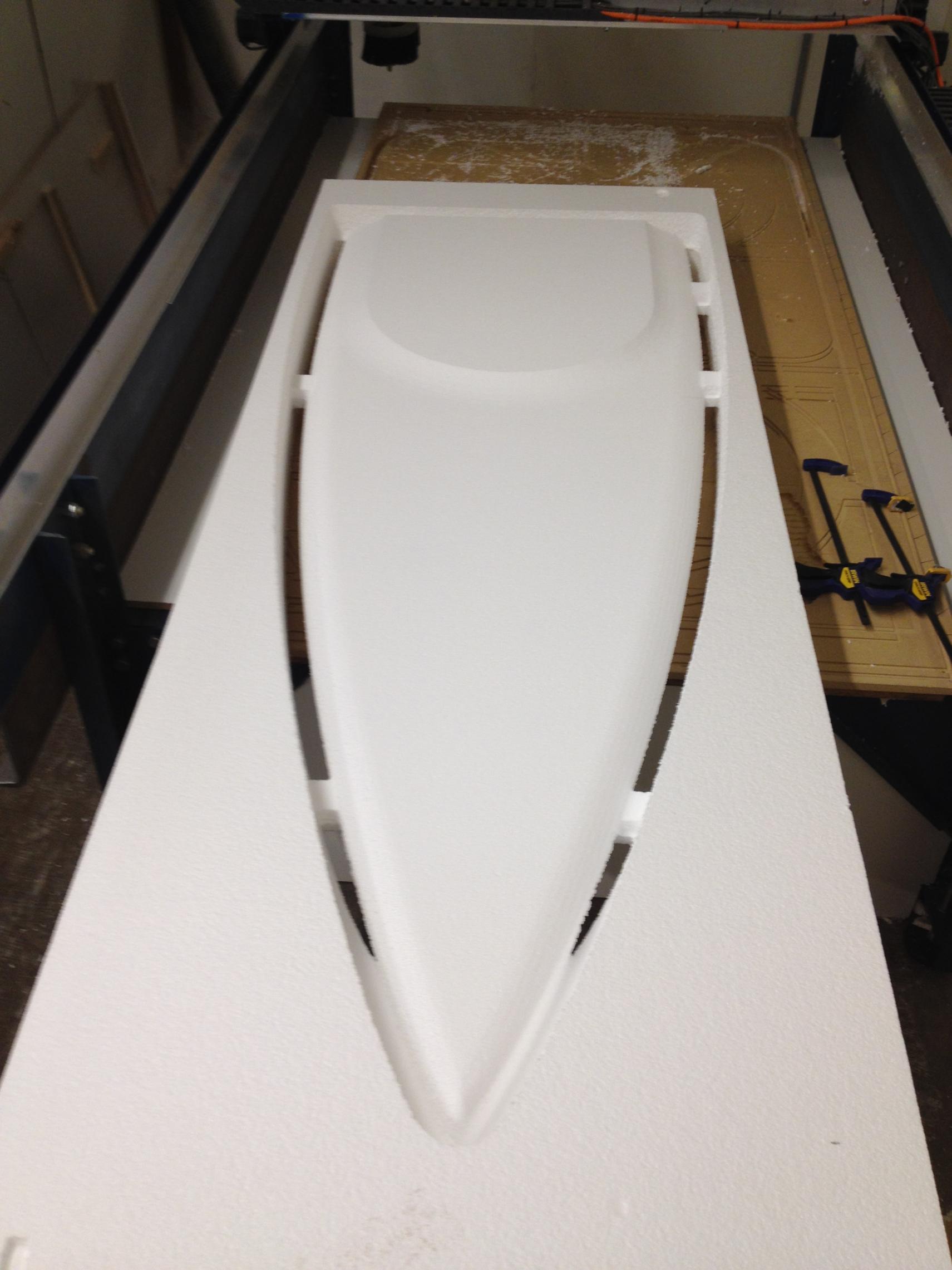

    I wanted to try out the 2 sided cut feature in Vectric Cut 3D. This turned out to be a perfect application.
    My wife said she wanted a Stand-up Paddleboard. I did a little research, and then said... "I can do that."
    So I modeled out a board after looking at several designs online, I couldn't find one I loved. So I took some of my favorite features, and made a 3D model.
    Then to make a 12' long board like I wanted. I had to make a front and back section to cut from EPS Foam.
    (my wife would have been fine with a smaller one. But according to my weight and the research I did, for me to ride, it needed to be 12' long.)
    I used the doublesided cut feature in Vectric Cut 3D and made top and bottom for the front half, and top and bottom for the back. I added tabs to hold it in place durring cutting, this was more crucial on the front, as it curves up slightly, and therefore wasn't cutting a flat plane.
    I finished the board with epoxy resin and fiberglass. I actually made two, because her sister wanted one too.
    EDIT: here is the blog post with the file I created to make this paddle board. This is my own file, I'm sharing it for all to use: JProPaddleBoard

    The finish work is what killed me. Fiberglass is a slow process.
    The boards aren't cheap if you buy one commercially available. I had some leftover materials around that kept the cost pretty reasonable. But it had to be a labor of love.
    But they were both very happy, and got plenty of compliments from other people on the lake with the 'expensive' boards.
    But shaping it by hand, the way the pros do is for the birds. Vectric and Shopbot made the first half of the project a piece of cake.

    To be perfectly honest... I don't mind sharing the file I created, although, i'm not sure that many could cut it. It would require 8" thick eps foam to be cut (to make the board 12' long.) I'm not sure how many can cut a file of that size.

    Thanks for the compliment Tim. I used an epoxy resin from US Composites. With our trip to Lake Powell quickly approaching I had to cut some dissapointing corners right at the end. And wound up just brush painting the board after a few coats of resin. The UV protected resin is a good idea, and if I did it again, I would take the time to do it right. As I said, the cutting came out great. But the finish became a full time job. And I couldn't put the time into it it needed. But we live and learn. Next time I won't try to build a paddleboard from design to finish in 5 days.
