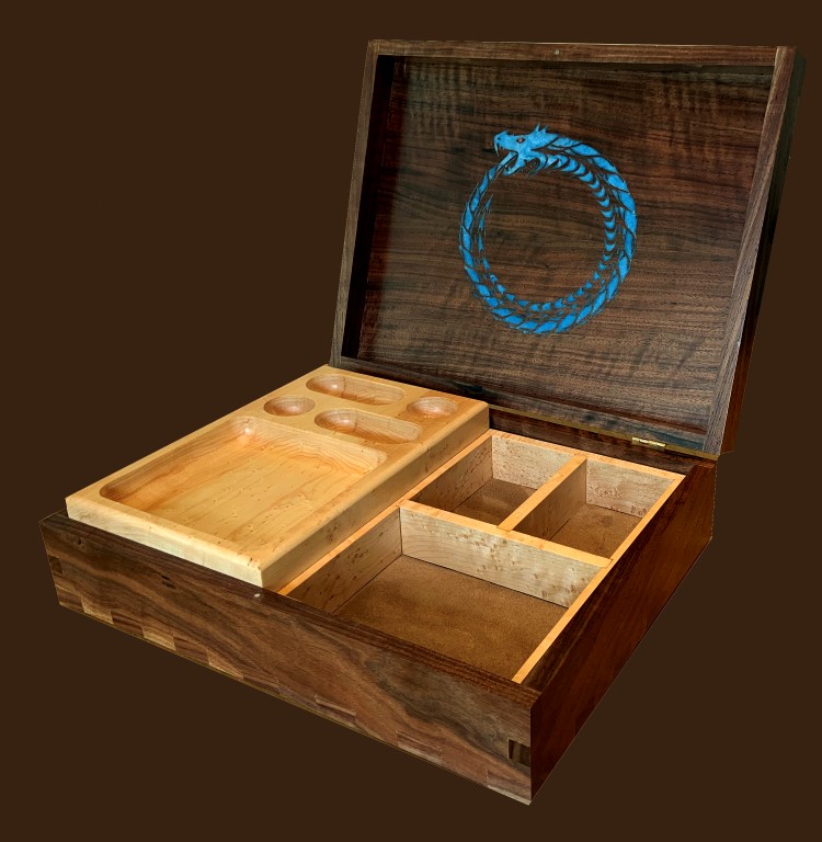

    Here’s another men’s valet I was commissioned to make…
    It’s walnut with box joints, a birds-eye maple interior and suede lining. The Ouroboros symbol on the lid interior is a V-carving filled with glass frit and fused with CA glue.
    I’ve started using purchased frit for my inlays as it’s a whole lot easier than pulverizing glass or minerals with a mortar and pestle! Also, an almost unlimited color palette is available.
    https://shop.bullseyeglass.com/acces...it-powder.html
    Several different grits are available… I’ve been using the finest (Powder) as it sands level easier.
    If you haven’t read other posts about this technique, you must use “thin” CA glue… other viscosities sit on top of the inlay material and don’t “wet” or soak into it.

    BEAUTIFUL Steve!!
    Thanks very much for the link for frit too!
