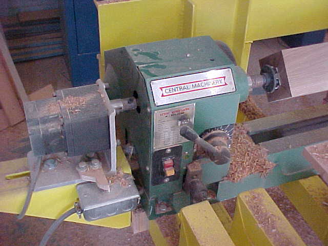

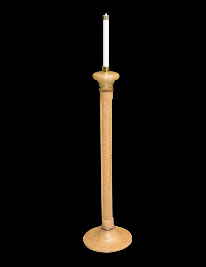

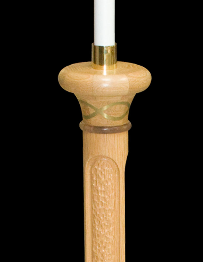

    Jimmy's indexer looks great and Gary has developed a wealth of knowledge and has really pushed the envelope but the indexer does not need to be all that complicated. This is my setup on a 2001 0r 2 PRT which uses a Harbor Freight lathe which can be run as an indexer or a lath and has a fabricated extension which allows for an 8' piece. The stepper is whatever SB was selling at the time for indexing. I don't know the specs or anything else. It can be pulled out of the lathe to spin the lathe. I have never pushed it beyond its capacity so don't know where that line is. I use it only a few times a year but it has made me a fair amount of money over the years. Here are a couple of pics of my setup and some candlestands and a college mace.
    It has really extended the boundaries for me.
