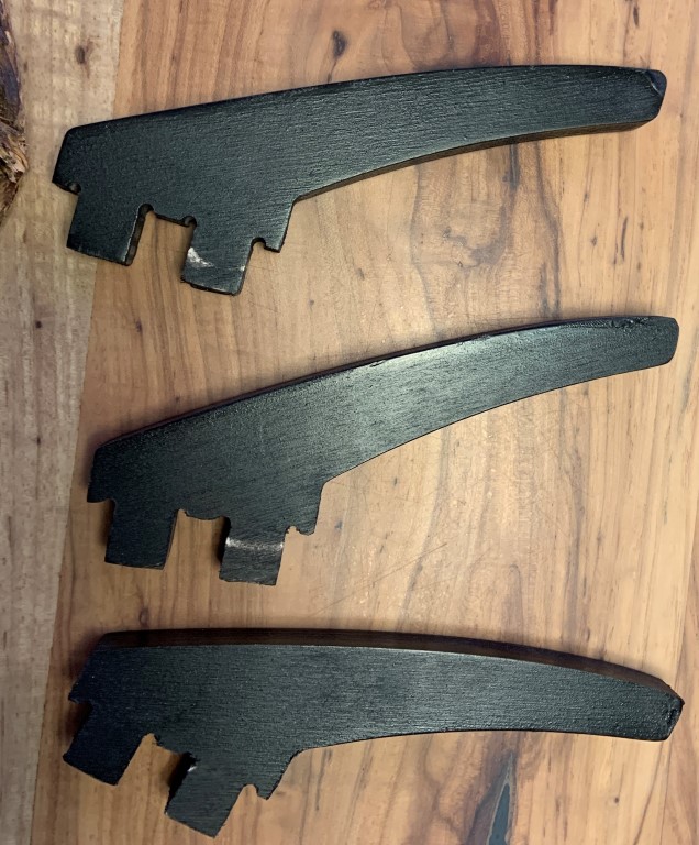

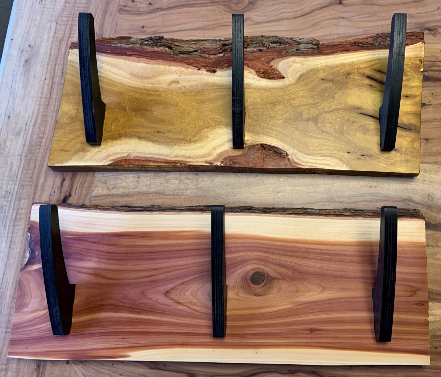

    Brian… here’s another project for those off cuts. I have over 100 small, live edge slabs and way more charcuterie boards than I’ll ever sell! I used to be able to sell them with a verse or poem carved on them, but I seem to be out of touch with what todays decorators are inspired by…
    I used to use wrought iron hooks, but their price and quality have disappointed me lately! These hooks, made from Baltic Birch, are more than adequate! Sometimes I’ll randomly hit the edges on the spindle sander to simulate a hammered look.
    My wall coat racks are made from local wood, Cedar, Osage orange, Bradford pear, Mesquite, Live oak and more. Lumberyard softwood works too when someone wants a long row of multiple hooks.
    I put keyhole hanging slots on the back, This limits the minimum thickness slab I can use, especially in markets where I offer V-carved customization.
    The live edge hardwood racks wholesale in the $15.00 per hook range.
