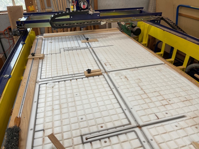

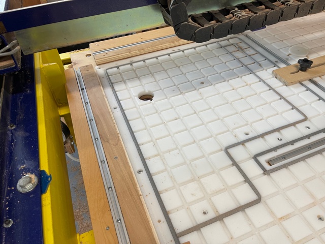

    Are you using a vacuum table? I guess my concern is the distance of the plenum from the edge. I don't have much first-hand vacuum table knowledge.
    Jun 2001
    Austin, TX
    421
    I use a vacuum table and side references.I replace the inside piece periodically and trim it to zero on the SB. I have very accurate 1/2" and 1" spacers which I use occasionally. The vacuum plenum is HDPE (I think) but I am going to change to a phenolic table in the next month for improved dimensional stability. I use 2 Lighthouse vacuum motors mounted under my shop with cooling fans on them. I can hold sown a 4 X 8 but rarely do. I often use sacrificial plywood sucked down and screwed to that or otherwise hold it to the plywood. As you can see these last a long time.I also have low density fiberboard spoilboard pieces cut for each vacuum zone and flattened in place for hold down. This works well for me.

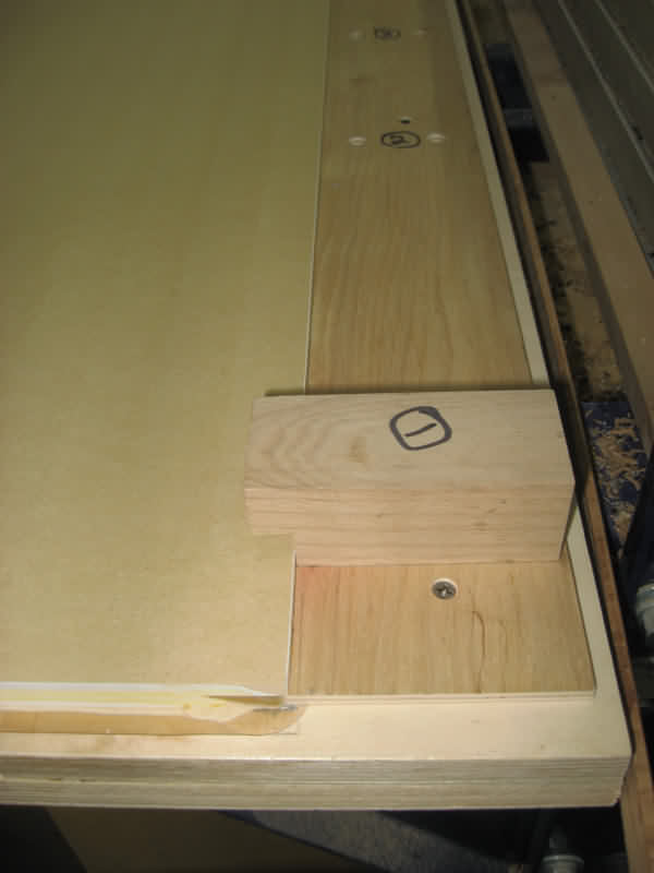

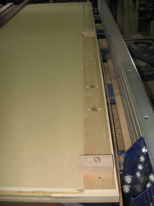

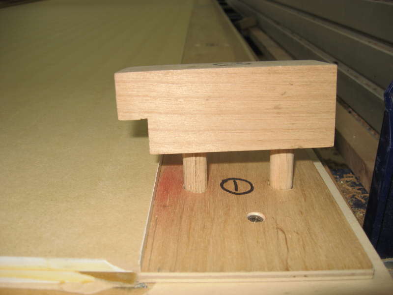

    Here's my simple solution to X,Y alignment.
    Not shown, but there is also one that goes into the front of the table to align the X at the same point every time.
    I used the CNC to drill the holes for the blocks. Made the blocks the old fashion way with table saw and drill press. Pins are 5/8" oak dowel wood. Has worked well for about 9 years now.
    Don
    www.dlwoodworks.com
    Jan 2021
    4
    Don said-"Here's my simple solution to X,Y alignment.
    I used the CNC to drill the holes for the blocks. Made the blocks the old fashion way with table saw and drill press. Pins are 5/8" oak dowel wood. Has worked well for about 9 years now."
    Thanks, Don- this is the general concept I had in mind.

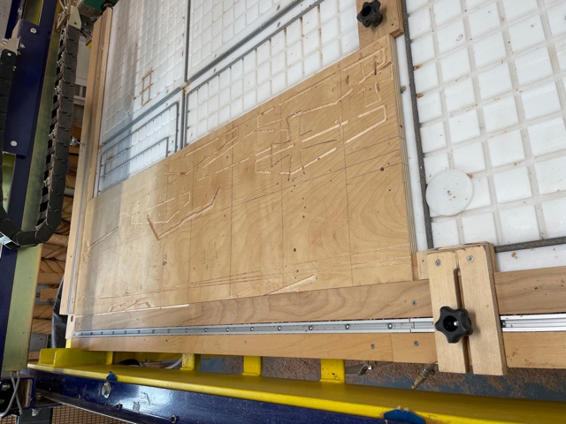

    I use slide bolts for the stops
