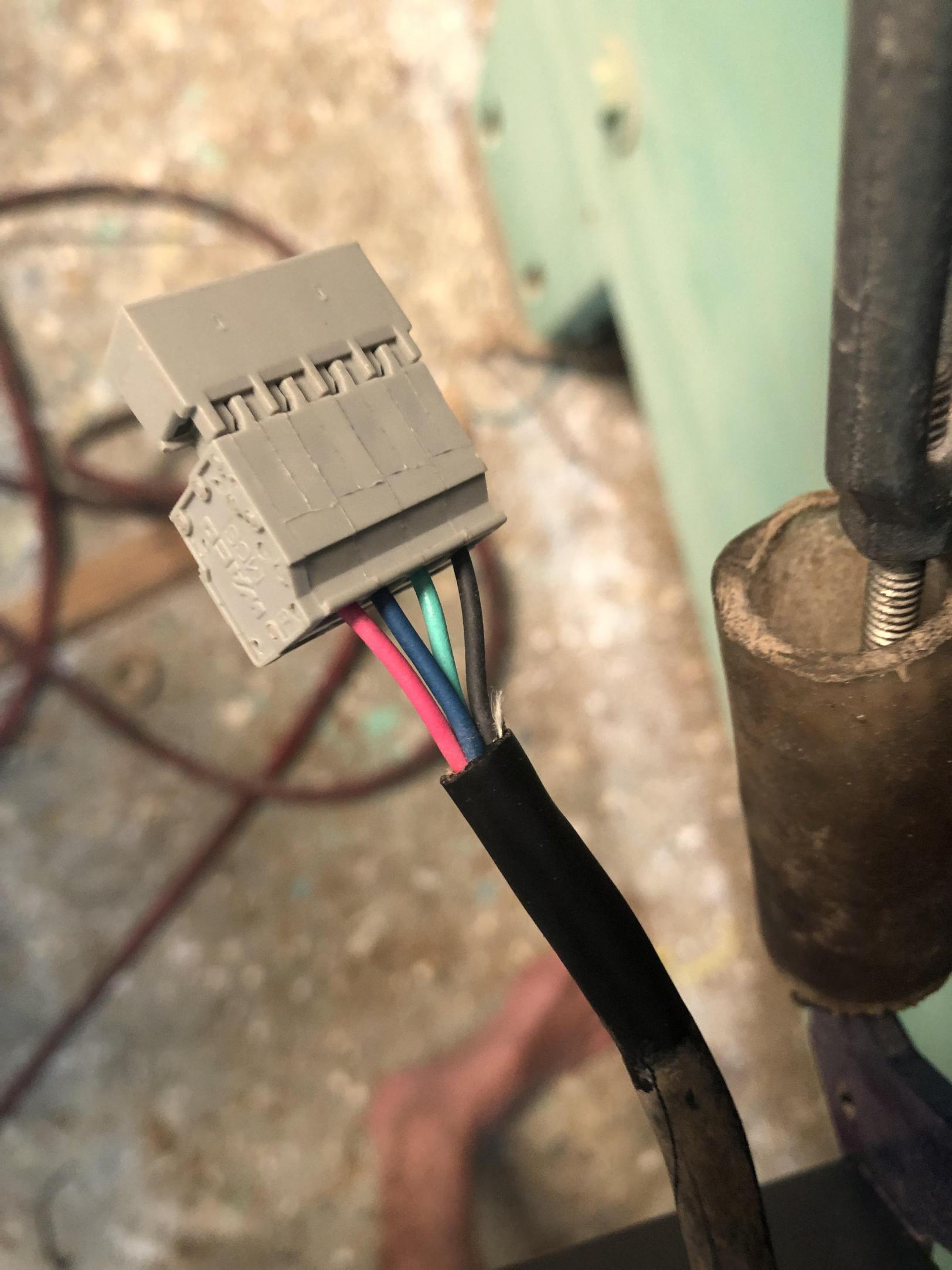

    I need to reverse one of my x motors on a prt96 Shopbot
    Vexta a6497_9412 ktg. Need to change the
    Physical wiring to reverse on the motor connector
    The wires on the connector is black green blue red
    Thanks for any help

    They are paired in the plug. Two on one side and two on the other. Reverse either pair. They come out very easy with a tab you push in on the connector going into the controller.

    Hi Kenneth thanks for your help just to make sure i have this correct
    from the left of the plug the colours goes red blue then green black
    so one pair will be red blue and next pair green black
    this will become green black red blue? trying not to make smoke

    Or should I just take the red and blue and exchange there position so it become from left blue red

    yes switching the red and blue in the plug should make it run the opposite way. If you are comfortable with a meter, each pair has continuity and no continuity between each other.

    I always just switch the green and black

    Hi Kenneth
    Got it working
